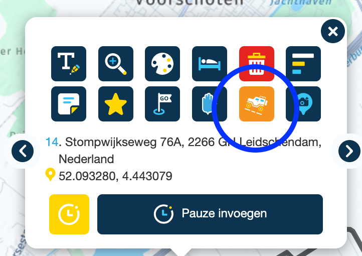

        @Juan-Carlos-Garcia-Ojeda Open the shapingpoint context-menu for point 4. Klick the Landrover-button (blue circle) and a strait line wil connect the points 3 and 4.

                @Juan-Carlos-Garcia-Ojeda That’s a bit dumb… 🫣 that’s what you get for only half-reading the text. Of course my solution doesn’t work if you export to another device. Better read more carefully next time…😉

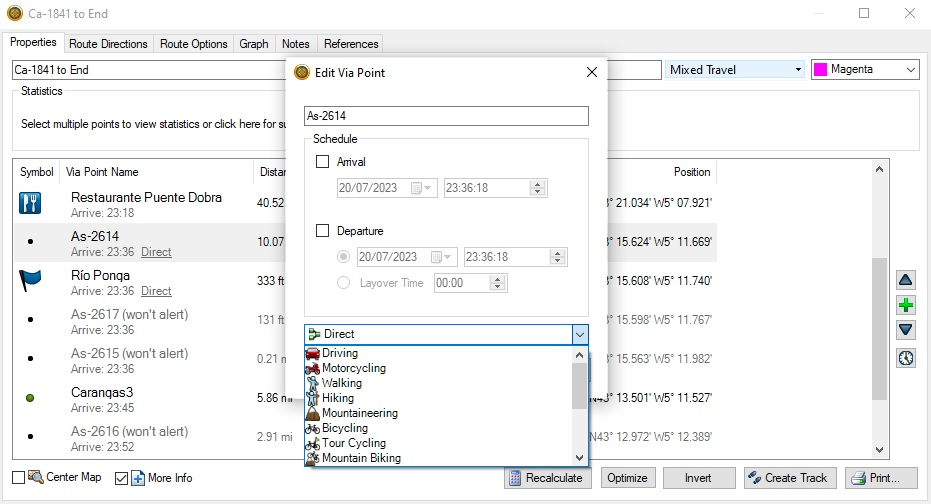

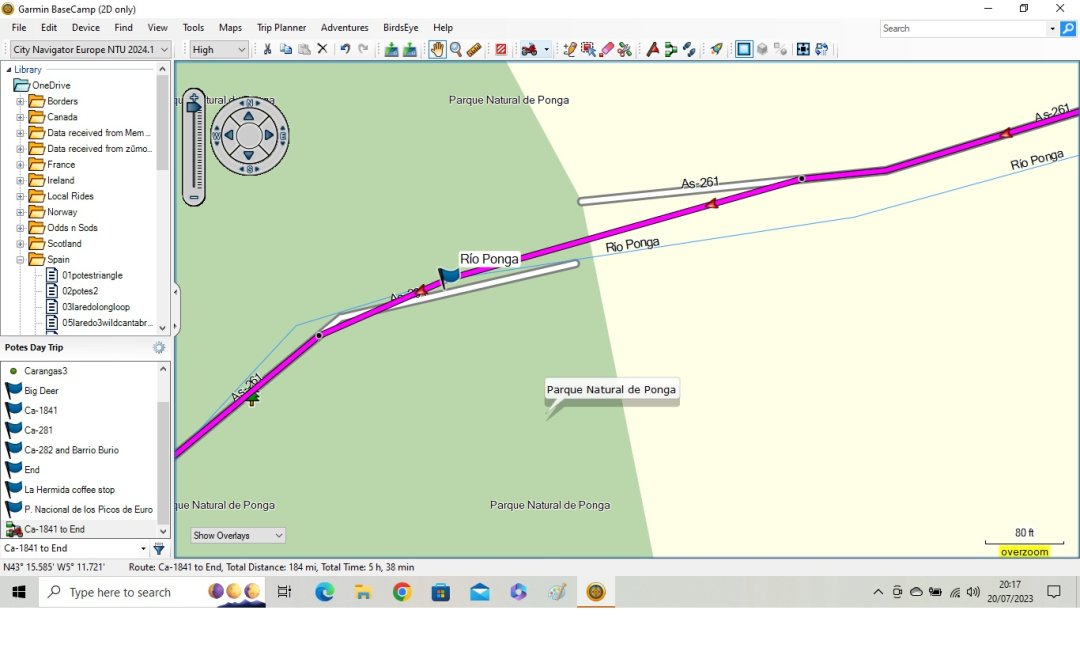

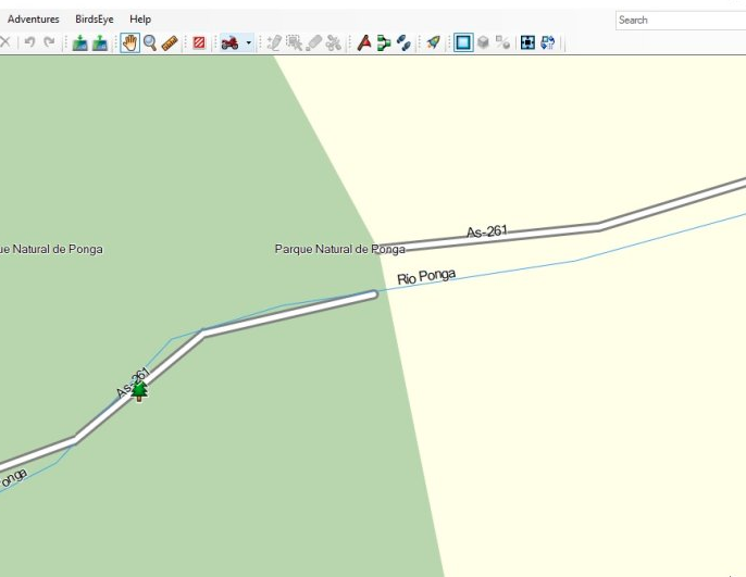

                    @Juan-Carlos-Garcia-Ojeda I've had this before on here maps in Spain (Picos)
                    You can fix it in Basecamp by designating two waypoints as "Direct" across the gap.
                    Change the point type to direct and calculate the route. Keep the rest with the motorcycling profile. I've tried this out and the route executes. If you make the points "don't alert" you don't notice the route has a patch/repair. Hopefully this is useful.

                      Hi
                      I did it in Basecamp and it seems to work
                      Thank for answer.
