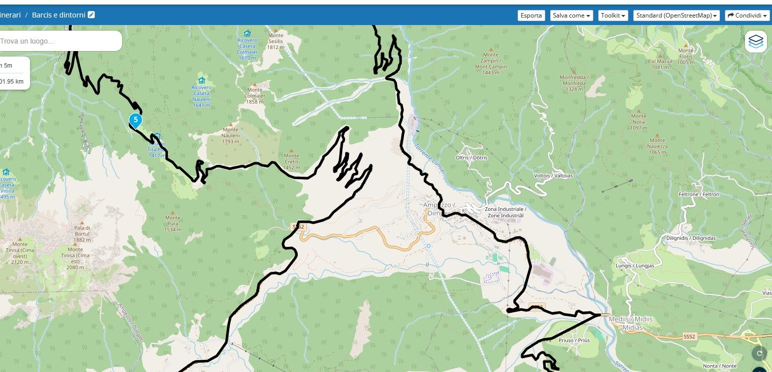

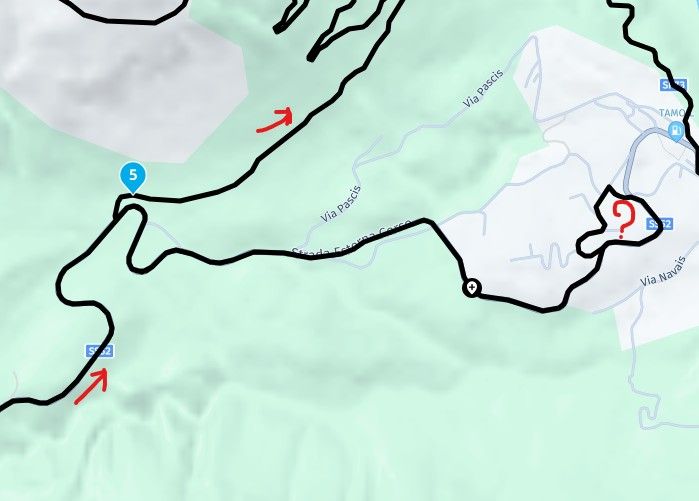

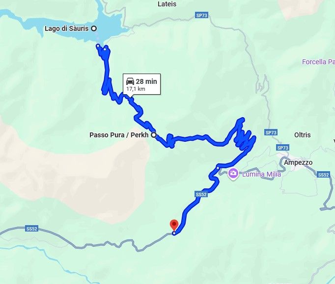

    Buongiorno, capita spesso che quando si pianifica un percorso si creino deviazioni illogiche che non esistono con Google Maps, come potete vedere nei file allegati. Questo problema esiste in tutta Europa. Io uso le mappe Here per il Garmin Zumo XT2. Lo stesso problema si verifica quando si pianifica dall'app Android. C'รจ una soluzione a questo problema, perchรฉ รจ molto fastidioso percorrere diversi chilometri e poi dover tornare indietro per lo stesso percorso? Grazie mille. ![alt text]Screenshot 2025-10-09 155132.jpg Screenshot 2025-10-13 122423.jpg Screenshot 2025-10-13 122757.jpg

        @Giuseppe-Marino, It looks like at the crossing just before WP5 it is not allowed to turn left. I checked that with mapcreator though, and it looks like it is already corrected.
        https://mapcreator.here.com/navlink:832838576/?l=46.4154,12.7650,18,normal
        I have no idea if there is a version difference or update schedule to which the MRA maps sync with HERE.

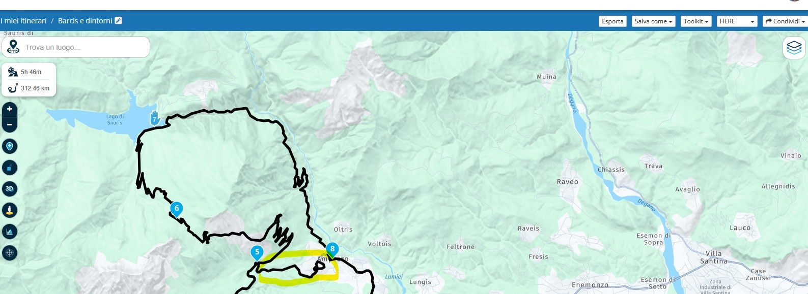

            @Con-Hennekens Yes, I also like MRA and use it with my laptop during my motorcycle trips, but I've noticed that using the HERE map for planning often results in a lot of errors. While I'm riding, I notice the errors and almost always don't follow the navigator's absurd turns. Currently using Open Street Maps, however, it doesn't report the same errors as HERE. However, I need to try exporting a route created with OSM to GPX 1.1 on the ZUMO XT2 and see how it behaves, obviously disabling automatic recalculation. Thanks for your support. Screenshot 2025-10-13 175958.jpg

              I've done some tests. The best solution is to plan using Open Street Map (which doesn't show road errors like HERE) and export to gpx 1.2 instead of 1.1. Then, in my case, import only the route from the navigator and not the track so that the navigation also includes the list of points on the route that I've indicated as waypoints.
