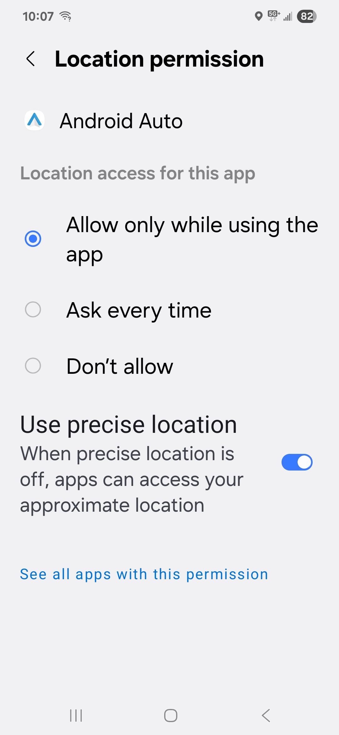

      @Con-Hennekens here is,what I see in my settings

        I dont see deby locations?

          Do you mean....Deny locations? What does this do?, Will it still mirror on my screen on bike?

            @D-Griffin I think @Con-Hennekens meant to change it to "don't allow".
              wrote last edited by
              #26
              Indeed: don't allow location permission to Android Auto.

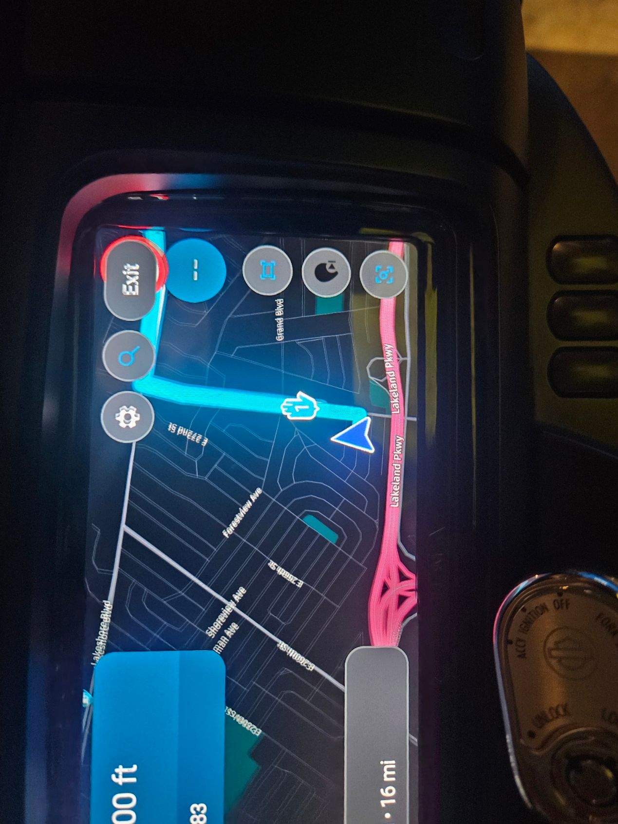

                      @Con-Hennekens Ok went on a short ride which I will attach to this post if you want to look at it. This is a ride I go on a lot good hotdog place at the end of the route! Every time I go, my icon wanders, I always shrugged this off as I'm so close to Lake Erie I thought that was why. Today I left, as soon as I fired up the bike screen came up and I clicked on the ride. It almost immediately found me and told me how far to go to make my next turn on to Lloyd rd. Right off the bat, this thing has never found me this close to my home! I always place my start of route miles away from my home due to that reason. So I went down and followed the on screen directions. In the past I always veer off route between waypoints 1&2 and always between #3&4. At this point I'm usually so aggravated I just ignore the screen and follow the roads I already know. Today the route was followed with no issues at all. I even made a few turns to pull it off route, It almost immediately tried to re route me and get me back to my route. I also noticed on the ride the "footages" to the next turn were really pretty accurate. They never have been in the past! Today I was at a light waiting to turn, told me 45 feet so i rolled up a little, changed to 40 feet. Since I started using MRA it never has been this accurate. So here is a copy of my short route...
                      https://www.myrouteapp.com/route/open/12235993
                      @Con-Hennekens I want to thank you for being patient and working with me. I'm not 100% ready to put the "fixed" stamp on it yet! Few more trips and we will see. In a nut shell, can you break down what we did by turning off the locations to android auto? What is this making my phone do or not do? I am just curious because down the road If I have any issues Id like to know if this is what is affecting any issue I have. Also should this app be able to "hold a route" like Google maps does, regardless of twist and turns? Also will I still get the real time updates on my MRA? I hope we hit on something here and we have this thing working as it should! We will be out this weekend so I will give it an all day test. When you are out riding, do you have issues with it veering off route? Thank you again for your help, you are the man!!!!!

                        @D-Griffin, Glad to hear things improved by this much! To me this is "proof" that your AA device indeed does have a GPS chipset, that gets used when connected through Android Auto, and it does not function properly. Just like I suspected.
                        What my "trick" does is merely prohibit the Android Auto app on your phone from using the GPS chipset built into your AA device. As a result, the Location Service on your phone falls back to using the phone's GPS chipset. This can always be reversed without problem, and yes, it will have effect on Google Maps to but you will likely not notice that.
                        The reason Google maps did not suffer from the same problem as the MRA app, probably lies in a workaround implemented in gMaps (and some other apps) that identifies problematic hardware and makes the choice to use the phone's hardware instead of the AA device's built-in one automatically. That's just an assumption though.
                        So, it is not really "fixed", but "worked around" and it enables you to use the app normally just like in my case. In my own case the problem was a little different. My AA GPS would not deliver correct speed information. From another case (also a Ford Sync system) I even heard of it driving backwards. The GPS stream literally was reversed... Isn't technology a beautiful thing? ๐Ÿคฃ
