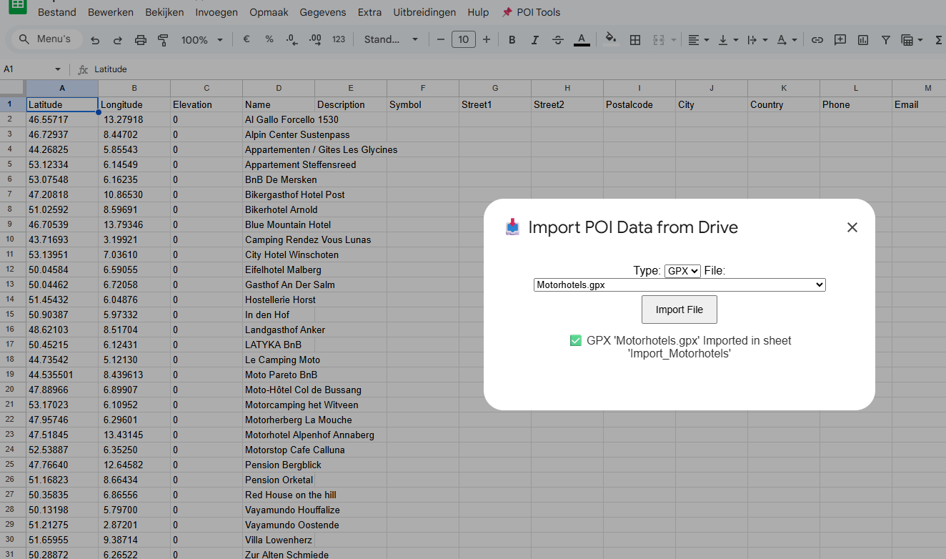

    Imported file

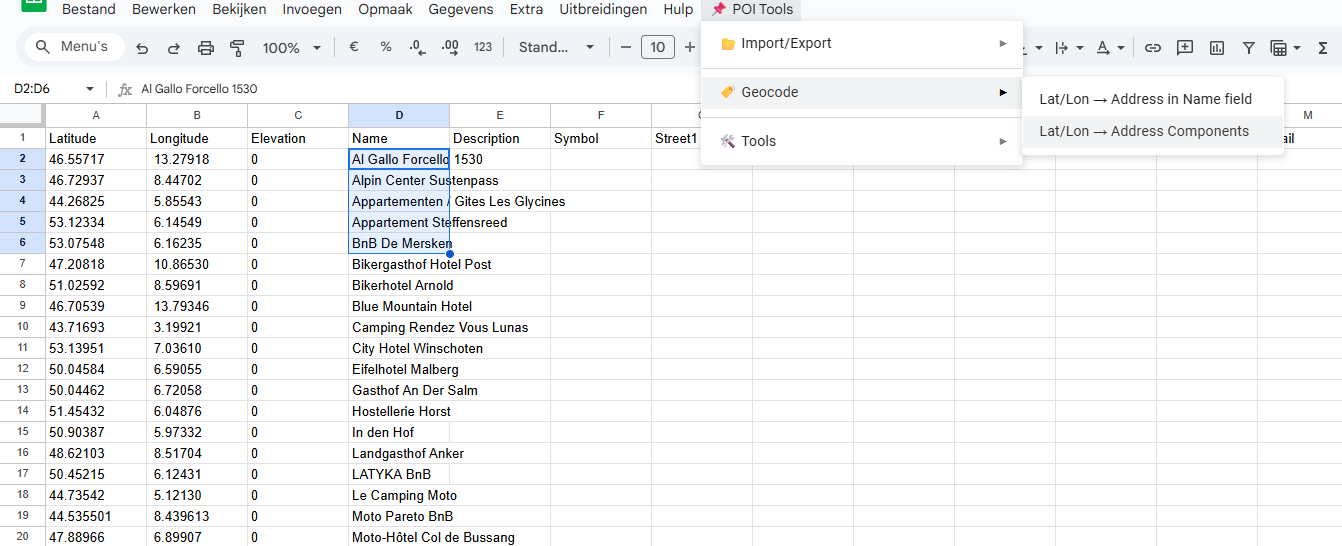

    file menu
    Geocode the first 5 rows by selecting Latitude and Longitude
    "Special MRA tools" to fill in address in the Name field.

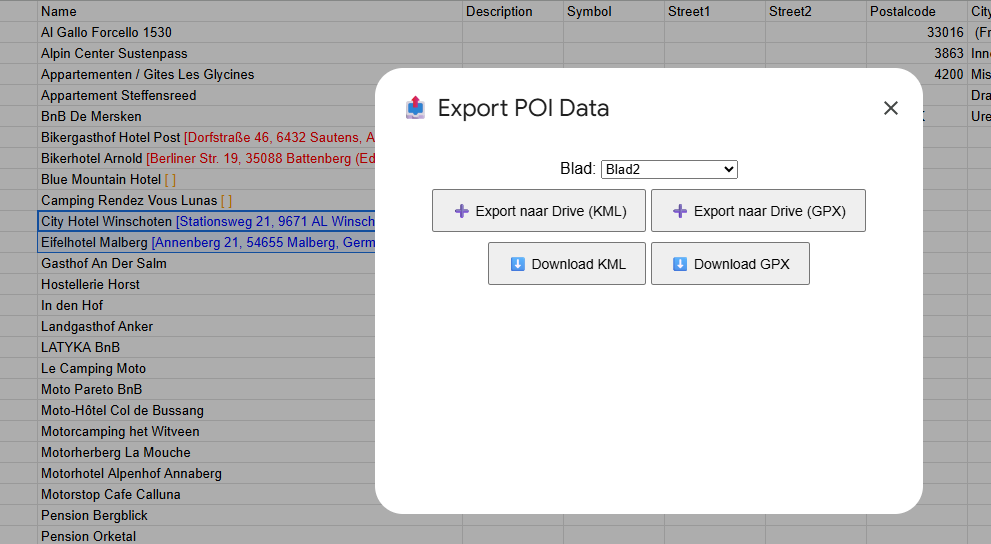

    Screenshot with added address in namefield ( in different colors) and the export dialog.

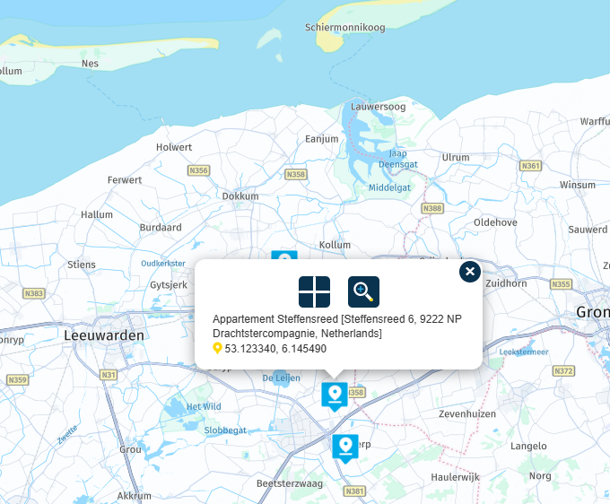

    POI GPX imported in MRA where in the Namefield the address is added between brackets.
