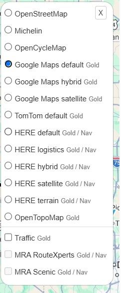

    Hello, I'm leaving on a big trip and saved all my routes in the google maps default. Is that the best option or should I be using HERE default Gold/Nav? So far I have not been able to push my routes over to my Garmin Zumo XT like I used to be able to. I used to do it wirelessly, and the routes get there but they don't show up in trip planner. So I used the usb cable to my computer and dropped the files in the gpx folder on the garmin but they never will import. Sometimes they get to 100% when importing, but never finish. No routes imported. Really want to use the garmin as we are looking at riding in some rain and don't want to have my phone out. Please help.

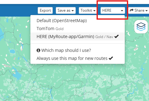

      Hi Mike,
      What you’re seeing there is just the layout map, which you can change without affecting the base map, depending on visual preferences.
      You need to select one of the 3 available maps a little higher up in the menu. Since you mentioned you’re using Garmin, you’ll need to select the Here map!
      After routes are created, export ast GPX 1.2, and it should work just fine !
