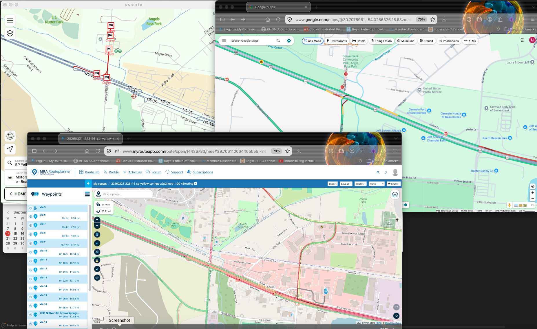

    I ran into several road closures recently after careful route planning. I realized that MRA planner and the nav app are not showing me road closures. It does not show on my route or anywhere in the area where Google, Maps, and SCENIC do. It seems like I don't have something turned on. After searching support and the forum, I can't figure it out. here are the settings:
    Traffic map layer is on. No avoidances are selected.
    Using HERE. OSM layer but other map layers don't show it either.
    Using Compare - all three routes go right through it. Google and SCENIC go around it.
    I can't think of anything else.
    I'll try to share the route.
    Lary
    link text

        @Lary The road closures you see depend on what the map provider (HERE) includes in its map data. If HERE doesn’t include a road closure in its map data, you won’t see it either when planning or navigating!

              I forgot to mention that the closure is just before wave point 15.
              To test the theory that HERE doesn't have this one on it's map but my settings are correct I tried another, high traffic area nearby. I compared MRA with GOOGLE and SCENIC and they all three show these delays and closures although somewhat different. I also switched between HERE, TOMTOM, and OSM. They all show the closures but only after turning traffic back on after the switch (would be nice to be able to set that as the default). Of course one must be zoomed enough to see them. SCENIC shows them all while still zoomed way out. It is also the only one that shows this back road closure. I believe it uses OSM so I thought MRA might see it with that map but not so.
              So in conclusion, it does work for me if the event is important enough, I am zoomed in enough, and I remember to see if Traffic is still selected. Does MRA route around closures during planning? SCENIC does not.
              It's a relief to have it working after spending several hours riding on back roads in West Virginia to find my way around closed bridges
              Thank you for your help.
              Lary
