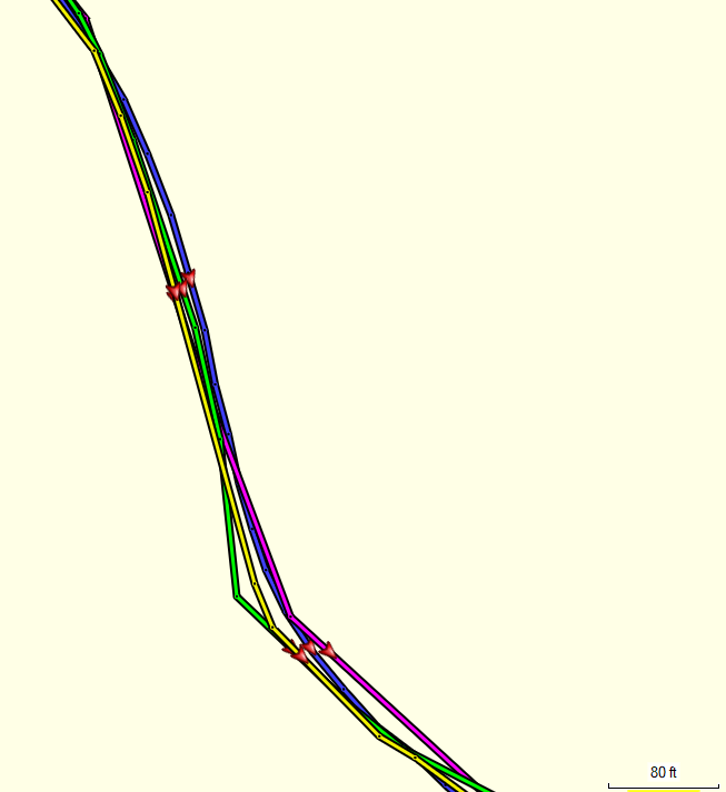

                        Below is a section of road according to a Here map (magenta line), and an OSM map (green line). I traveled that road tracking my position with a zumo XT2 (yellow line) and another GPS tracking device (blue line). Depending on tolerance, we might say that all four lines are “right”. We might also conclude that it is unclear whether any of them are “right”.
                        A SatNav calculates it position on a periodic (not continuous) basis from time signals sent by satellites. The number of dots on those lines depends on how frequently position is determined and recorded. More dots imply more precision, but that does not assure any greater accuracy. Under the best conditions, those positions are accurate within several feet (a few meters).
                        In some locations, these four lines might vary more significantly. The vast majority of the time, they are close enough to be useful. On the occasions when they vary enough to be confusing, I try to remind myself, if Magellan managed to figure it out, I probably can too. 🙂
                        Planning and then navigating with the same map, route preference and avoidance settings, and with software / devices using the same routing algorithms is, of course, most likely produce the most consistent results for us, but it’s not always that simple. For various reasons, one might want, for example, to plan with the MRA route planner and navigate with the Garmin zumo.

                          • track, with its many track points, will provide a very accurate representation of the MRA generated route, but it is fixed in place.
                          • gpx 1.2 route with the user specified via points and the route point extensions matching the track points, will provide the same very accurate representation of the MRA generated route as long as it is not fully recalculated. Unlike a track, it can be amended, to some degree, to support a Closest Entry Point navigation [re]start or an off-route calculation to get back onto the route without triggering a full recalculation.
                          • gpx 1.1 route with the user specified via and [relatively few] shaping points, but without the benefit of the [many] route point extensions, contains a less accurate representation of the MRA generated route. It will always be subject to route calculation and variation wherever it is imported.
                          • gpx 1.2 route will be the least accurate if it is fully recalculated since only via points will be available to the routing calculation.
