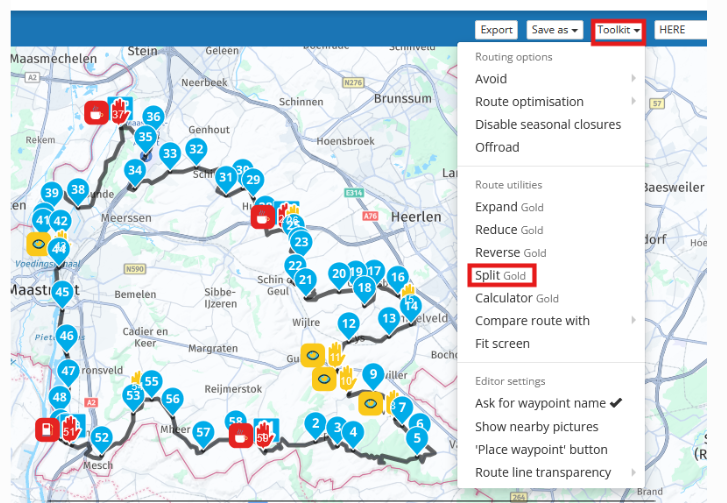

        Hi @Richard-Ludlow yes there is a way, but the way I know is a bit convuluted
        first you need a copy of the expert route in your list of route via the "Use Route" button as @Guzzist explains
        you then need to split the route at the point you want the new start piont to be
        the route will now be in now in 2 parts
        open the second part
        you then need to combine the 2 parts but by placing the original first part at the end
        somelse may know a simpler way but this is the method I know

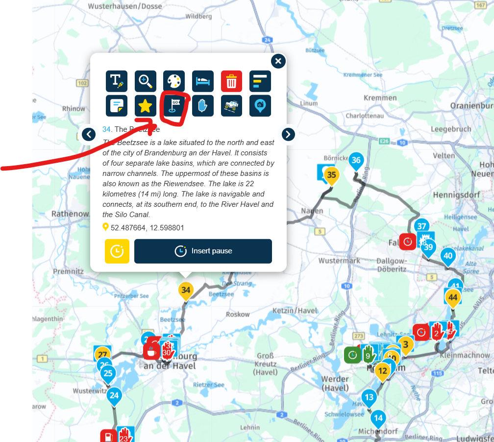

          Open route klick with mouse in the right corner on use route. Now klick any waypoint/shaping point where you wanna start from and use the circled button. Make sure you make a extra waypoint next to the one you want to start from. If there's no waypoint nearby a part of the route will be skipped

            @Brian-McG, check @Leike-Lodiers his method 😉 Less convoluted!
