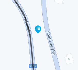

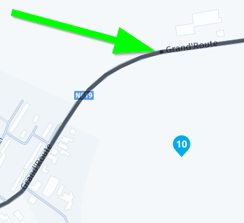

          MRA is a little bit smarter than that 😉 Each route point has a second point projected to a road. Consider the little black dots in the planner, like this:
          That position is used for being "hit" or not and not the waypoint itself.
          Where it get's tricky is this:
          It can be a matter of millimeters to have WP10 in this example on the other road, which alters your route.
          So in reality the method is quite forgiving concerning the placement of waypoints:
          but in certain circumstances strange things can happen. To prevent that of course exact placement is best practise, but I also feel sometimes it is stressed a bit too much 😉
