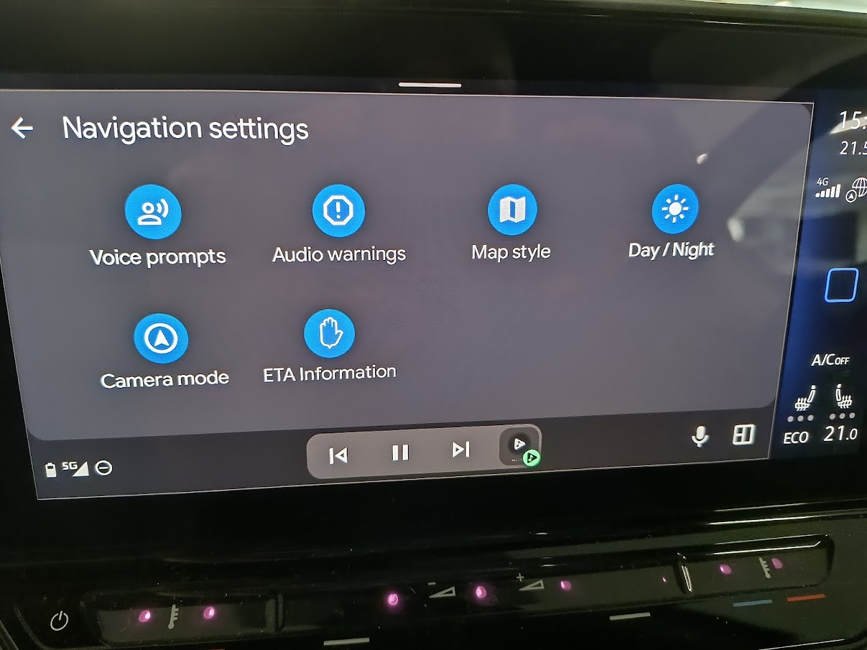

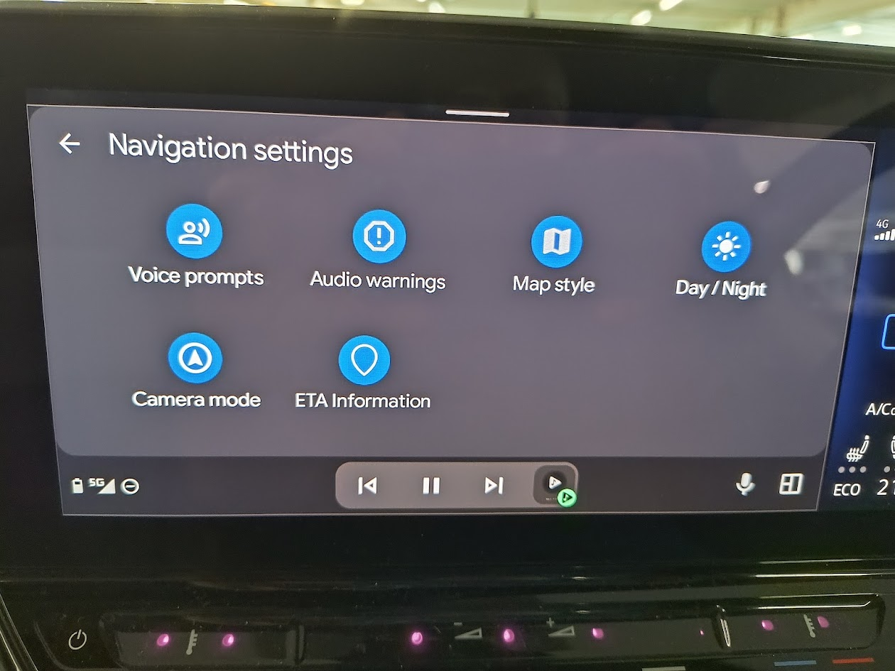

            • Mzokkundefined Offline
              Mzokk
              I checked this in the car you can change the selection of info on next shaping point, Via point or Destination in Android Auto. Don't know about Carplay??
                Mzokk
                Just keep toggling the ICON. I just keep mine on next waypoint so had fogotten I could change the setting on the AA settings menu.
