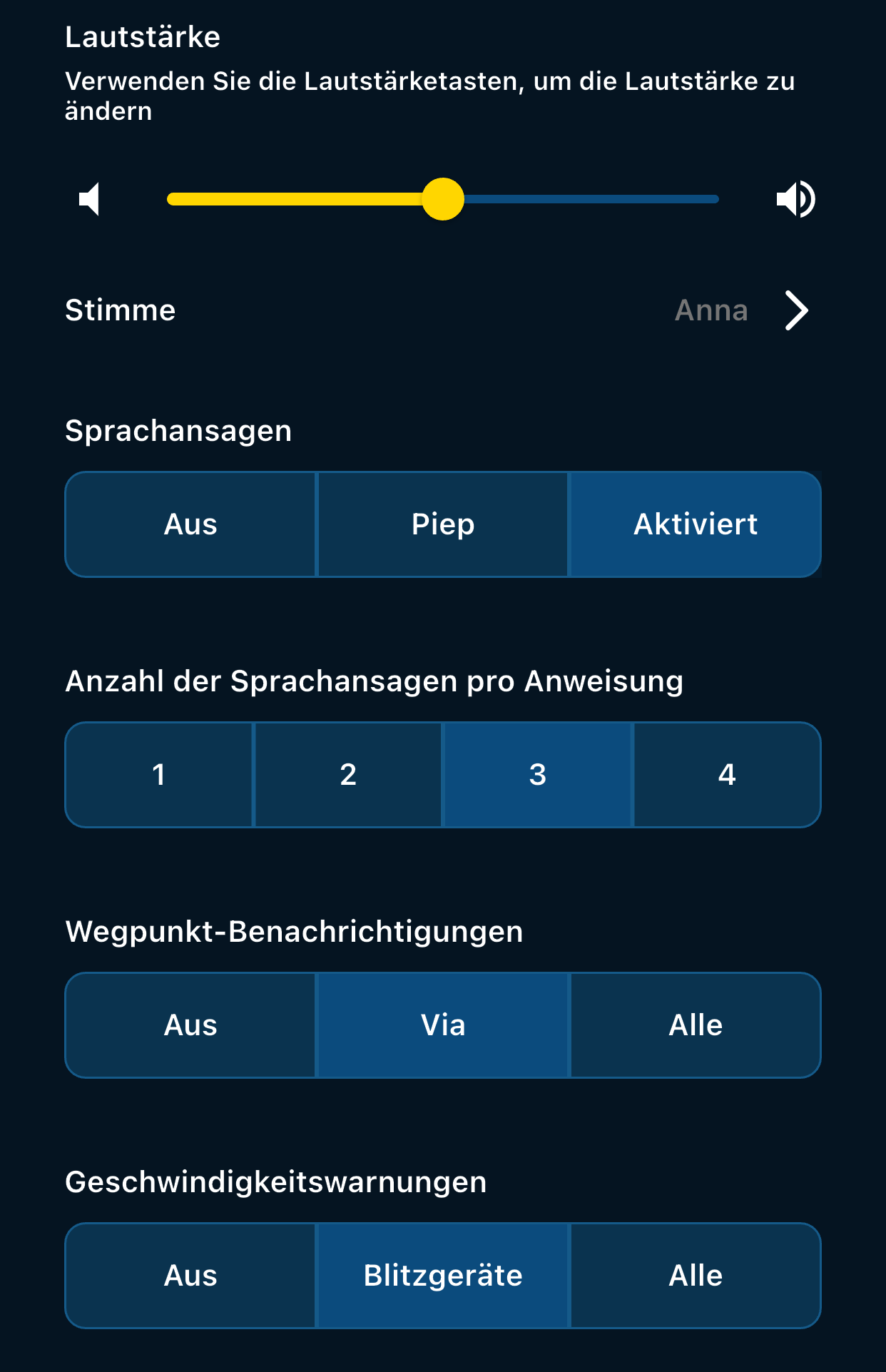

        Here are my audio settings. As I mentioned earlier, I receive some announcements, but not all of them. It may not be a pure MRA issue, but rather a problem with the iPhone or something in the Sena environment.
        I'm finding it difficult to troubleshoot...
        • Mopetenpit Mopetenpit
          @Mopetenpit the settings seem Wright to me zo uit must be something in the settings of your phone. Since I don't know much about iPhone I can't help you there

                  But. I also see. your announcements are set on "Via only". I've no knowledge what effect on the background this settings has on other waypoints. You cannot hear them but maybe they are still procesed and can therefore still causes issues.
