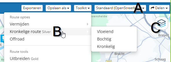

        @Guzzist Thanks.
        I am a gold Member and have selected Standard OpenStreetMap. The twisty / height options do not appear any longer. Out of interest, where do you select the OpenStreetMap option?
          You select the OpenStreetMap at A
          B shows the curvy route options, height options are only part of TomTom map.
          Don't use C to select a calculation map, The maps there are just overlays.
