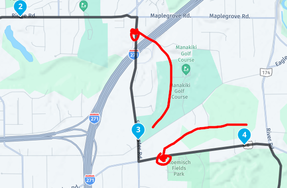

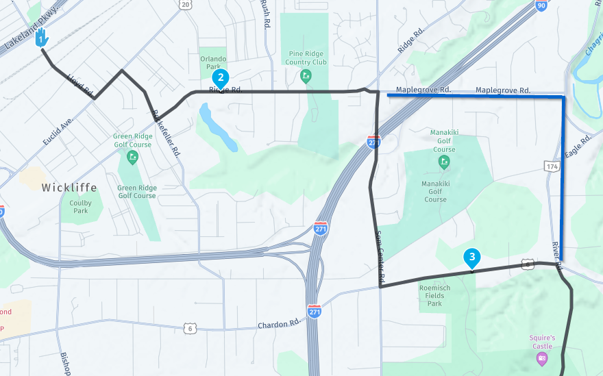

                Soo the problem came between way points 2 and 3. My phone said stay straight on Maplegrove, her said turn right on RT 91. Even though I set the map to take Rt 91 it didn't want to.....That was the Android Phone, the IPhone told her to turn right on RT.91...

                  Just a suggestion from my part:
                  What happens when you relocate the waypount just after the turns?
                  When i create a route or modify it, i place the waypoints after each turn so that MRA Next or my Garmin Zumo XT follows the route i plotted without any strange turns left or right.

                    @D-Griffin, I would suggest differently:
                    WP3 can easily be omitted of you place the next one (the new 3 in my screenshot) in the middle of the road. Placing WPs near crossings leaves too much rooms for alternatives like going straight over Maplegrove instead of the 91. And in general it is not a good practise to set WPs too near to crossings, since that can lead to directions not being spoken while navigating.
                    What likely happened is that your phone was already navigating to WP4, or even WP5 possibly due to some false start or accidental tap on the WP tile in the upper right corner. That can make the blue line over Maplegrove faster (to 4 or 5).
