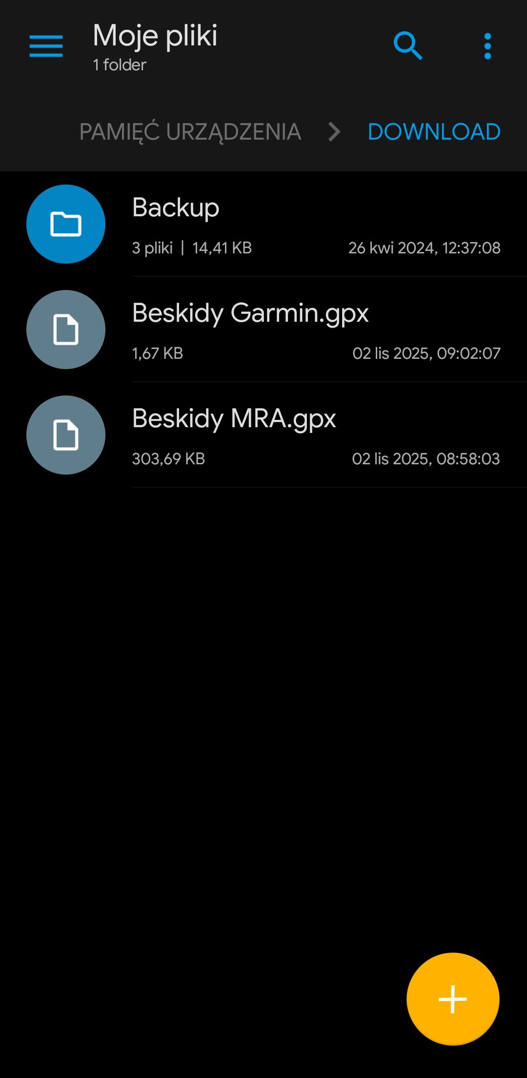

        Just check the sizes.
        Same track with waypoints.
