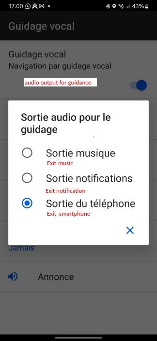

    I tried different solutions without success because I either have the intercom between our two helmets or the navigation information.
    An example with Cruiser who manage exit
    text alternatif
    Perhaps the new generation of Sena manage this functionnality ?

        Hi from France,
        I would like to know what is the format of sound by bluetooth because I would used MRA Navigation Next with my motor bike and my Helmet and if I want keep the communication with my passenger. For that the sound format must be output smartphone communication and not music.
        I don't found how manage this point inside MRA Navigation Next,
        Can you help me ?
