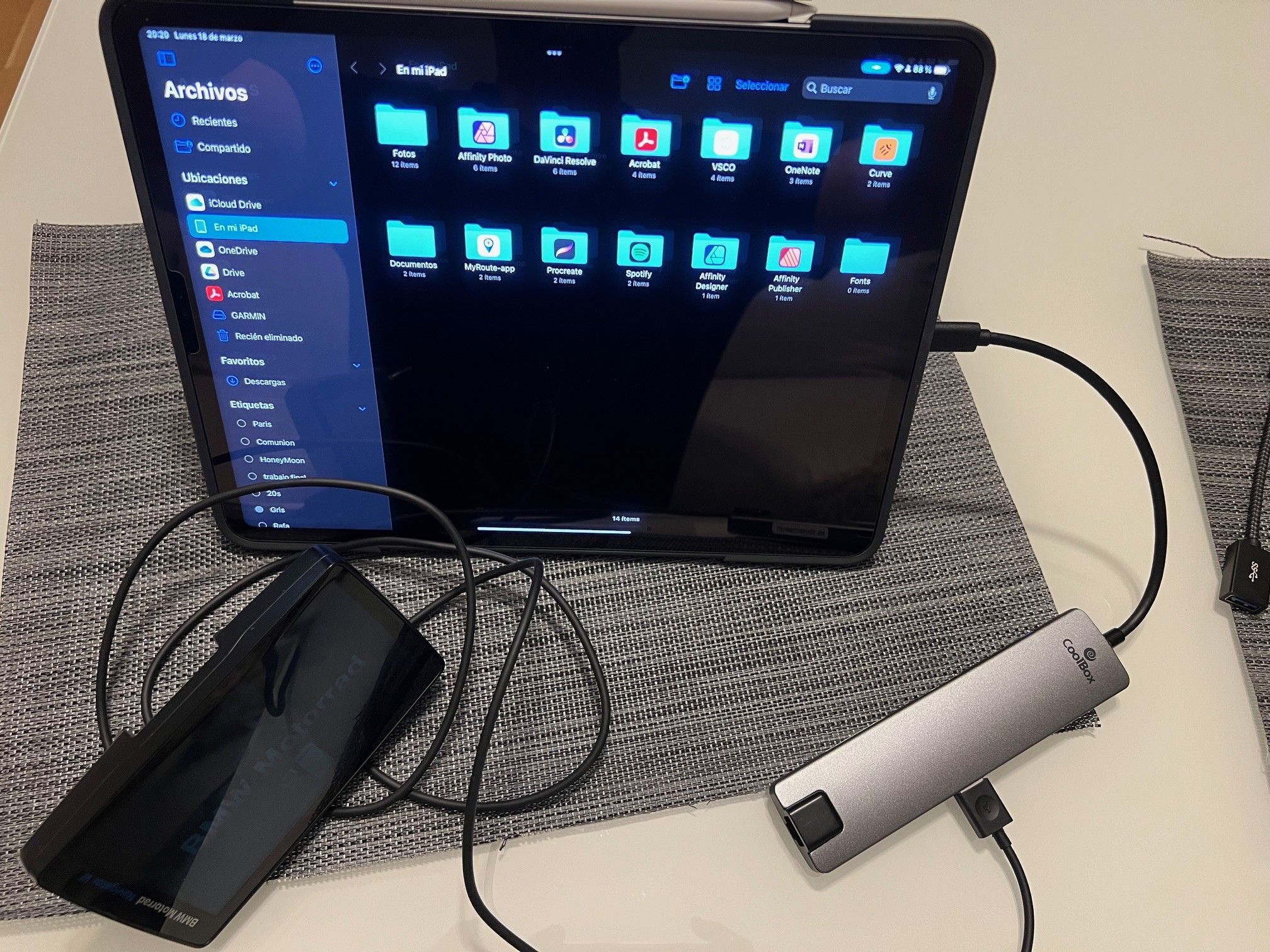

    I have an iPad Pro 6 generation. I tried to connect the navigator VI with the iPad but the iPad doesn’t recognize the navigator (in the files app of the iPad) so I cannot move the GPS files created with MRA to the GPS.
    Someone can help me?
    Can I use MRA in the iPad to create rotes in order to transfer them to the GPS Navigator VI (BMW version of a Garmin)?

          Got it! I tried what you propossed before your posting but it doesn't worked fine.
          Your post gave me a hope to do it...
          I needed to restart the iPad in order to allow it recognize the Navigator VI. It only recognizes the Garmin after restart and also it takes a long time to do it so.
          The tip here is to see the screen of the Navigator VI and to see that it's in sharing files mode. If it happens you are in the good way.
          I attach the image that shows how I did it.
          Thanks to both, your messages helped me a lot.
