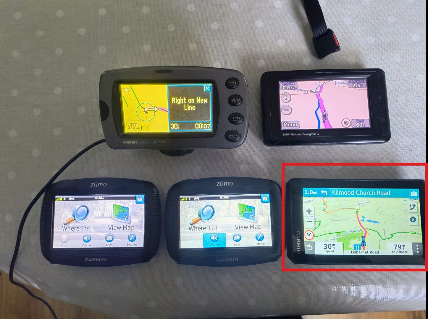

          Hi All,
          First trip planned on MRA (which I love for planning) to Spain and the length of Portugal.
          First experience with MRA, exporting into Tread in the suggested 1.1 manner.
          What I discovered......
          Shaping points did not move across accurately. Meaning that planned roads to ride, The N2, were missed in places causing all kinds of confusion in the group and frustrations. In total over 9 days a few hours of riding was lost.
          Exported gpx files, somehow, we're different across different XT2 devices, besides a few hours of comparing settings in apps and on devices to confirm consistency of the settings.
          I understand that some of these issues will be a Tread issue and am not placing full blame on MRA, however I am no a happy person with the MRA set up for GPX accuracy to export to Garmin XT2. The sole purpose of the purchase was the advertised accuracy of the GPX to export to the Garmin XT2 and this was simply not good enough.
          If there is a glaring fix please let me know and I will hold my hands up to being an idiot.
          I have tried everything I can see in the forums including exporting direct to memory card, correct settings etc etc.
          Please advise .....
          I currently feel I have purchased an expensive piece of software that is useless to me.
          I am however hoping it is just user error on my part .
          Simon
