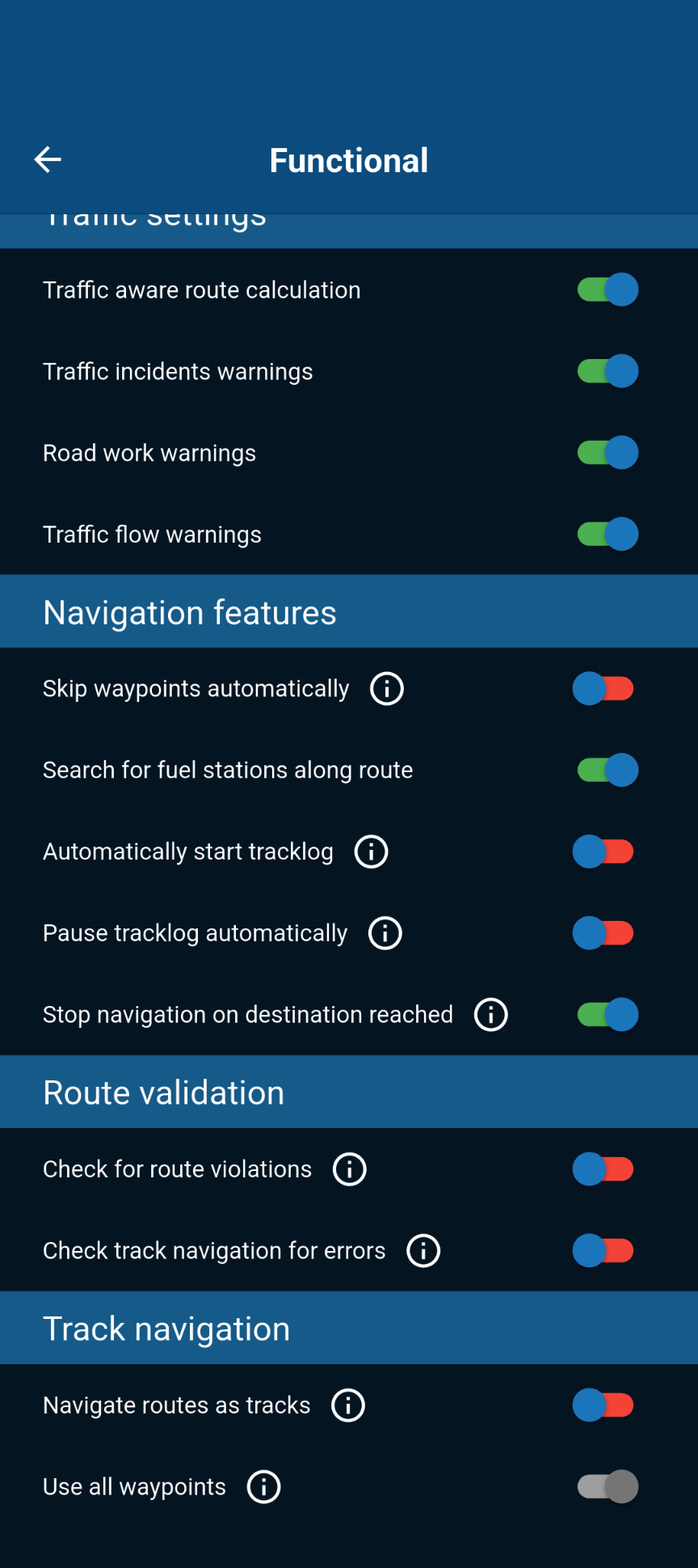

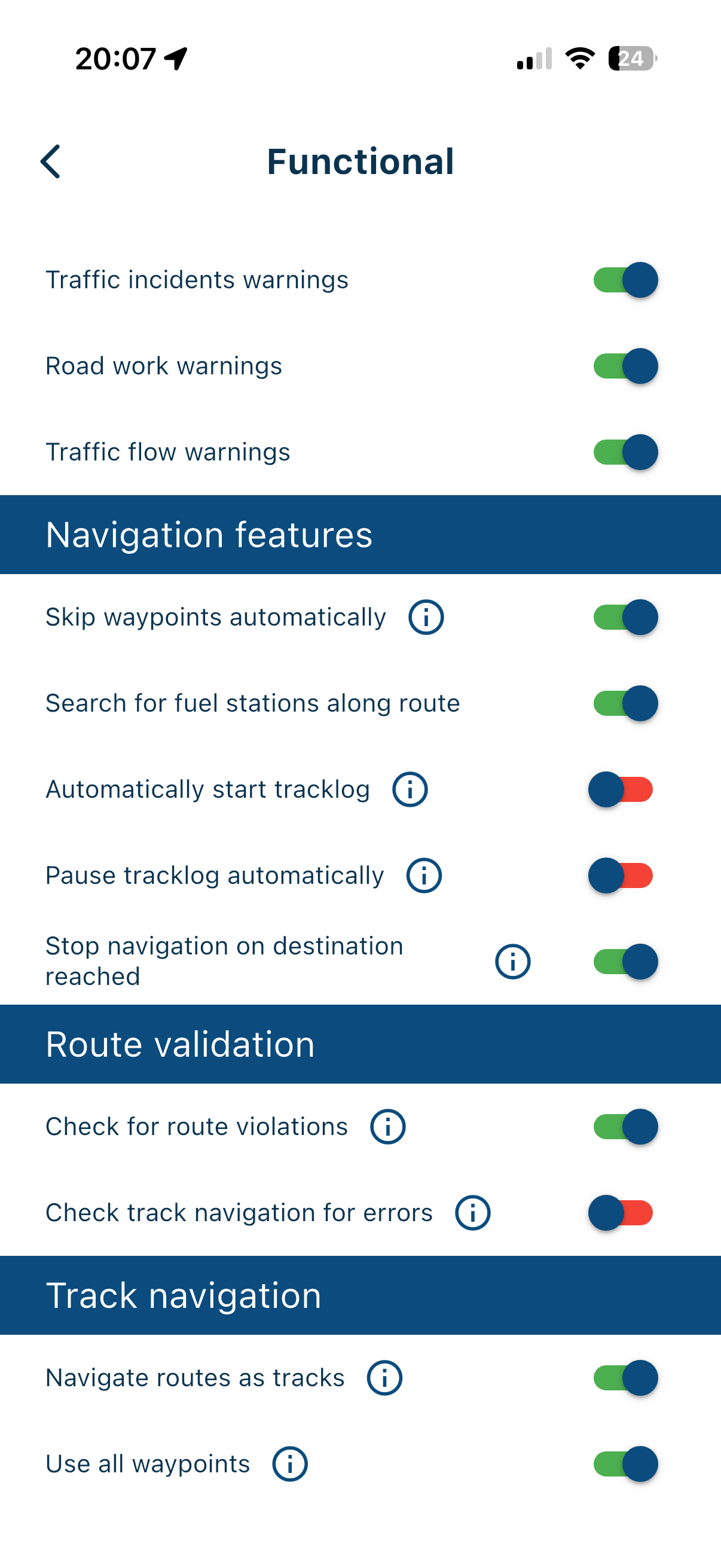

          Probably untick "Navigate routes as tracks"

            @Aggelos-Minoudis Based on your settings, I can see that you're navigating offline using “Route as Track.”
            I think this setting is the reason for the issue you mentioned.
            Please try navigating using “Route as Route.”
            Please try these settings.

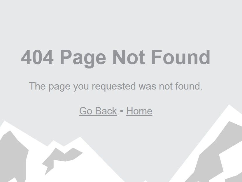

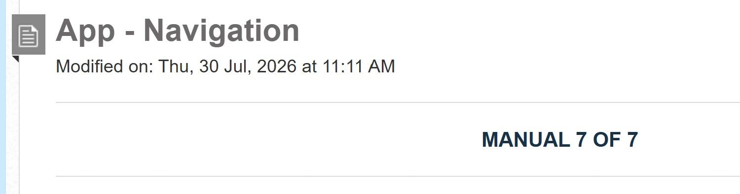

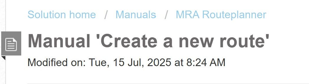

                  Hi Peter. I would usually agree that the documentation for an app. should be your first port of call for learning about the app. However, in my experience, the documentation and videos published at the link you provided are not always up to date. Let me give a couple of examples:
                  1. This is under the section
                  At the bottom of the page there is a video for creating routes. The video is 7 years old and does not reflect the user interface we have today. Many of the processes are the same as back then but we have to remember that many users of MRA will not be totally computer literate and are likely not to be able to follow instructions when the user interface and some processes have changed. Also at the bottom of the page, just above the video, there is a URL to a "switching service" which is supposed to include video instructions. This is what happens when you click on the "switching service" URL:

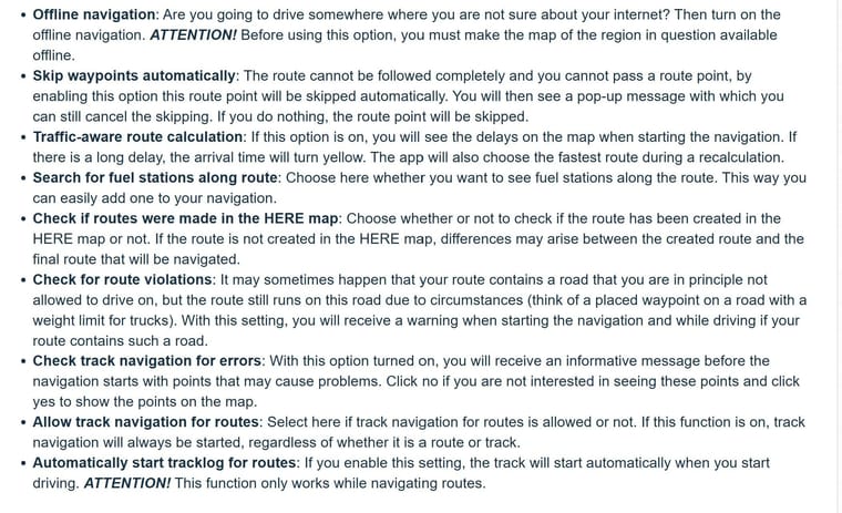

                  1. This is what you can find under the Navigation functional setting for the app.
                  That list is not an accurate reflection of what's in the Next app today.
                  The documentation and videos need to be accurate (accepting that some minor errors may always exist) and up to date to truly be useful, especially to new users who may not be completely computer/app literate and also overwhelmed by the plethora of options.
