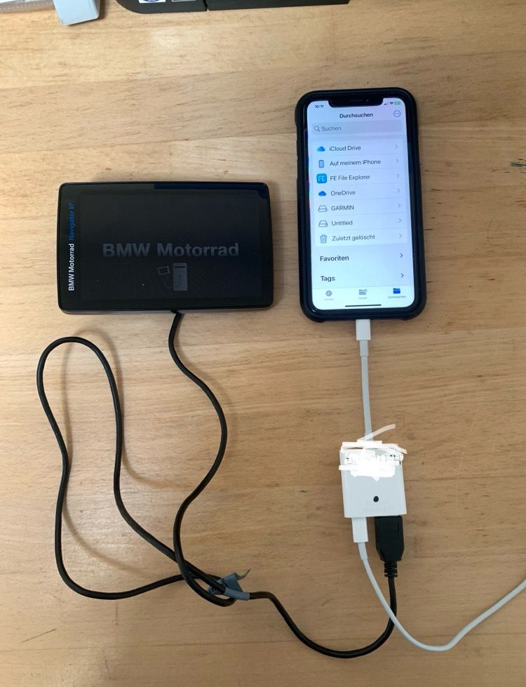

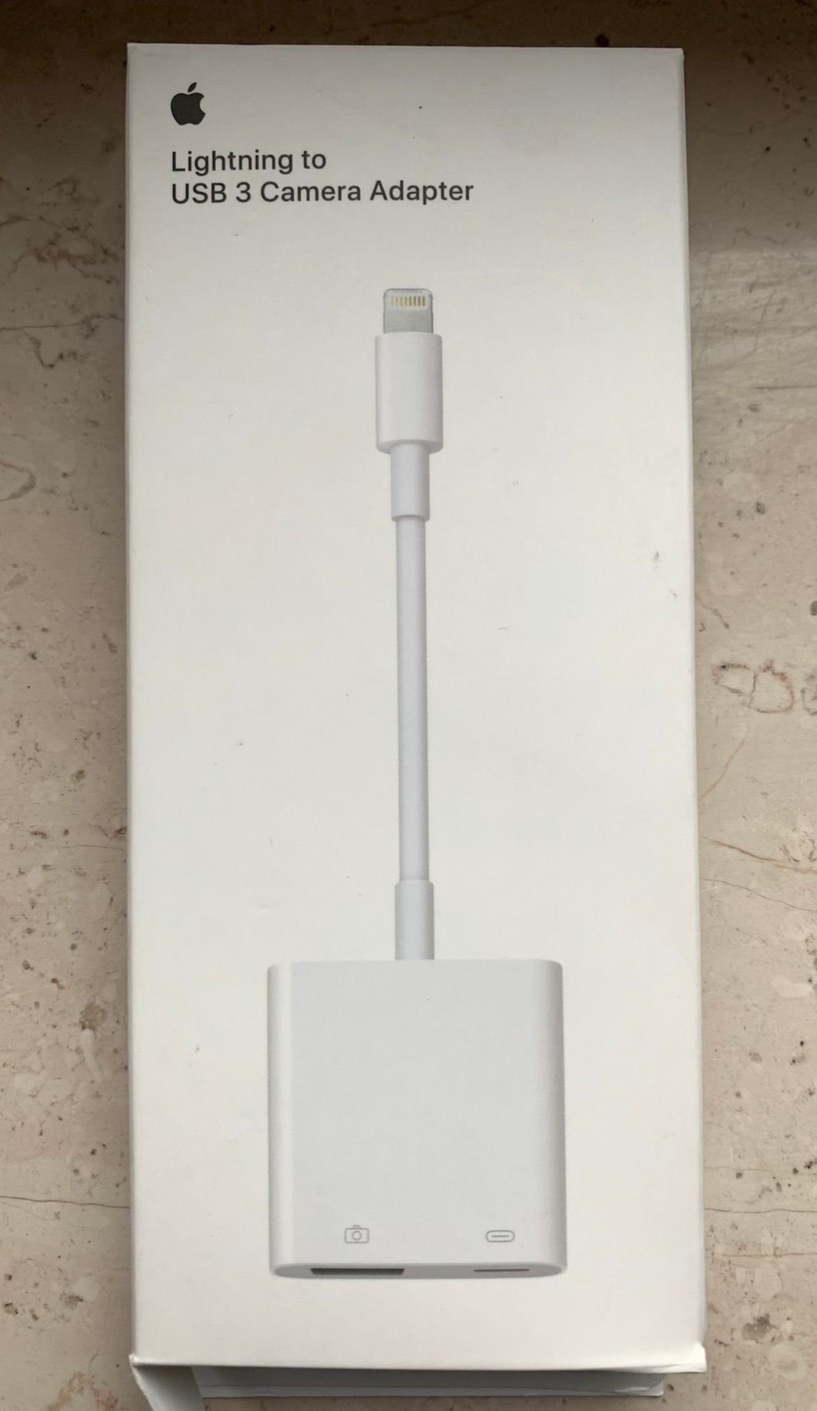

        But this is possible, whether from the iPad or mobile phone with the camera adapter see photo

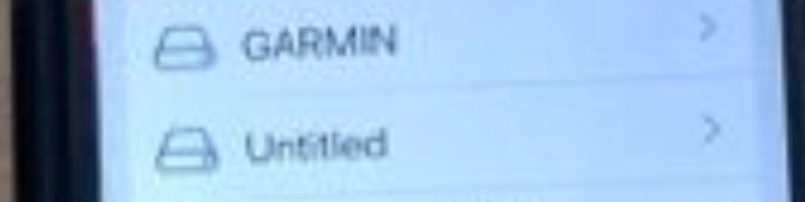

        • Hubert Thoring
          These are the two directories on the Garmin that are displayed on the mobile phone, see photo ...
          • Garmin is the memory on the device internal
          • the other is the SD card if available
          Important:
          When you have saved the routes from the MyRouteApp in the iCloud, just slide them over to the Gramin directory... as usual on the PC.
          That's how I used to do it...
