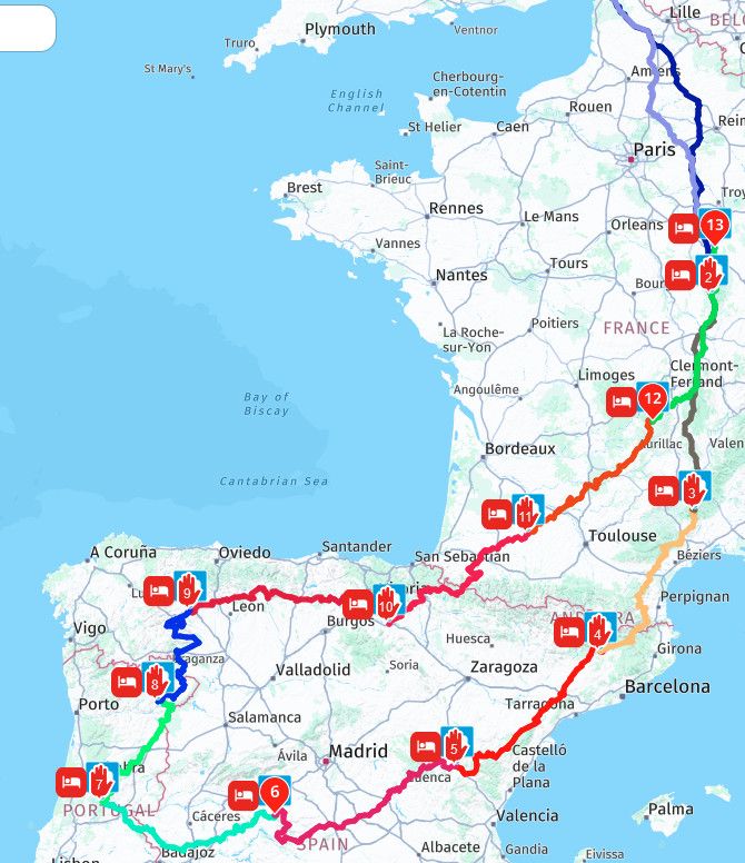

              • Travellexxie Offline
                wrote last edited by Travellexxie
                Ok, my version 😝
                Every day has its own color.
                MRA Lifetime Gold
