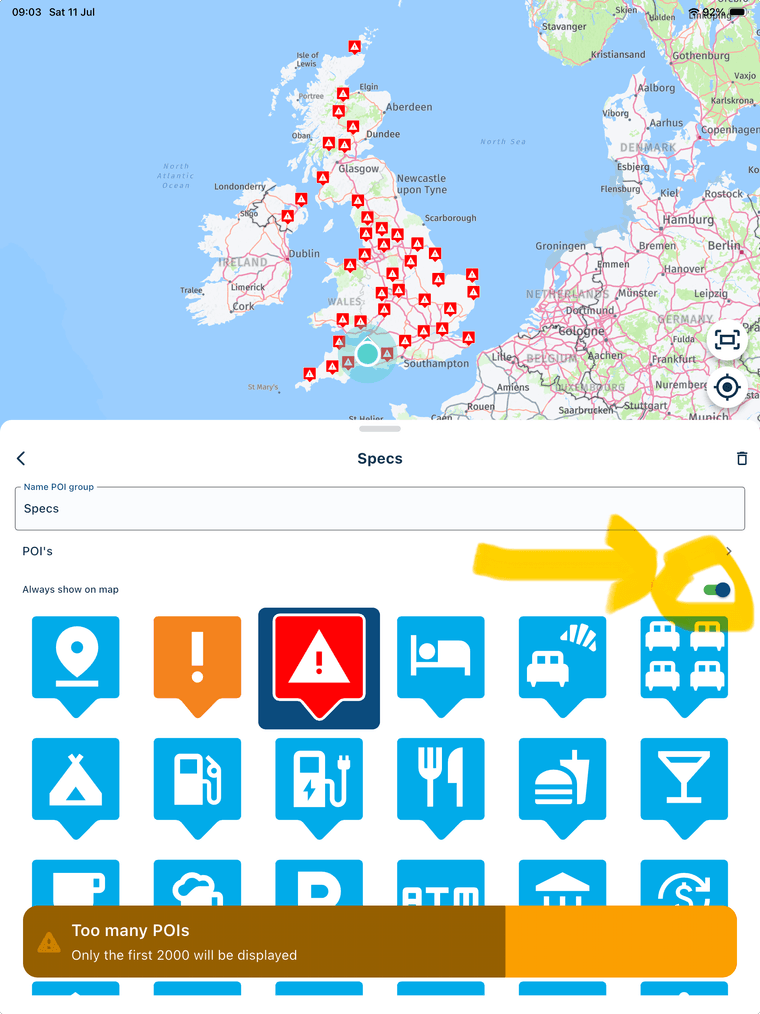

    Hi,
    I am importing the location of Speed Cameras into MRA via the Library "Add" function.
    My problem is that there are in excess if 3000 POI's in my file and when added into the I.O.S MRA App, i get an error message stating "Too Many POI's. Only the first 2000 will be displayed", see screenshot from the App below.
    I have tried splitting the POI file into multiples of 1000 POI's but i still have the same issue.
    Is there a limit to total POI's that i can add, if so can it be increased please ?

        Hi Nick,
        Thanks for your quick response.
        I have tried breaking the file down to under 1000 POI’s but I still have the error message and I can see that some POI’s are missing on the map.
        I did this in a csv and also a gpx (excel) file type so not sure why I’m getting the error still.
        I should also add that I chose the “always show on map” slider to be “on”.
        What was the file type you used prior to editing please?Screenshot 2026-07-11 at 09.03.26.png

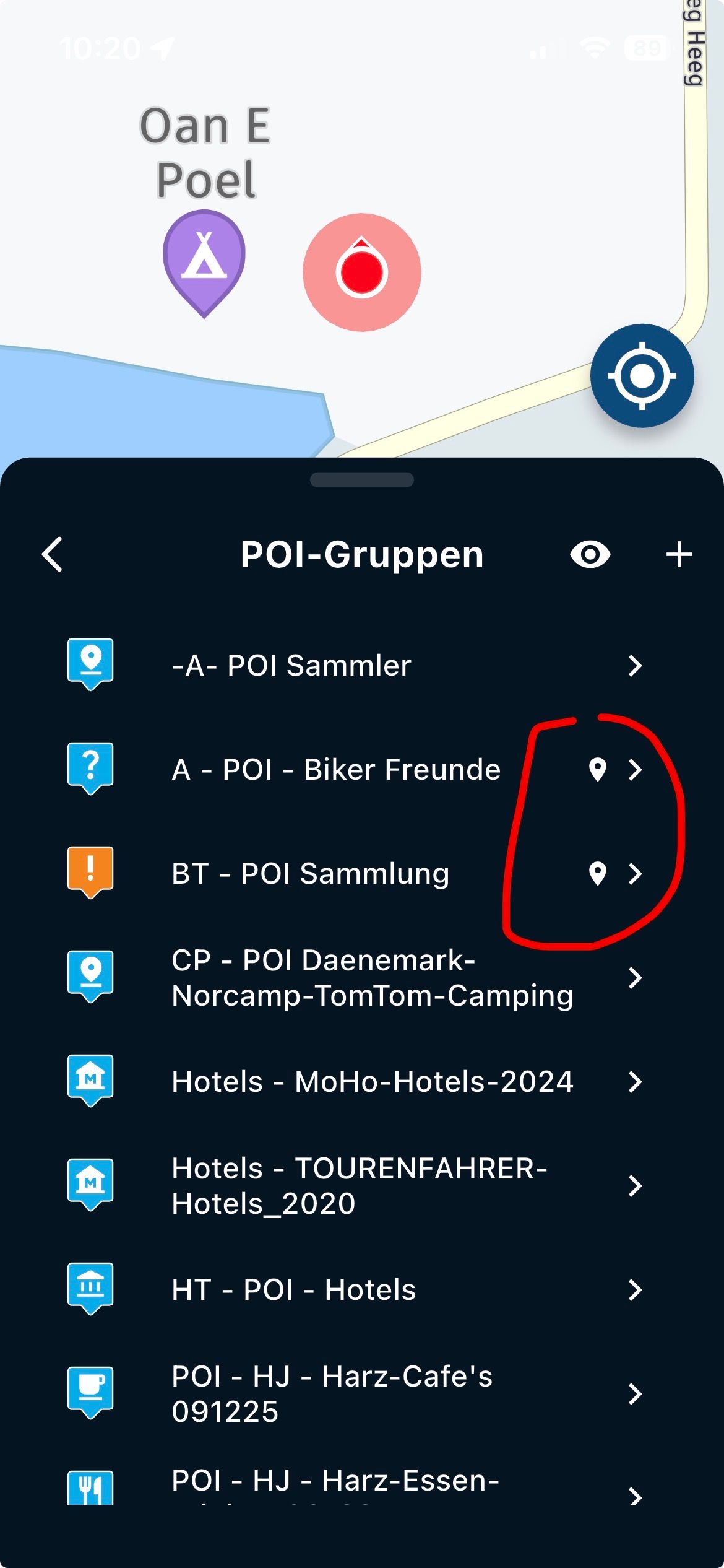

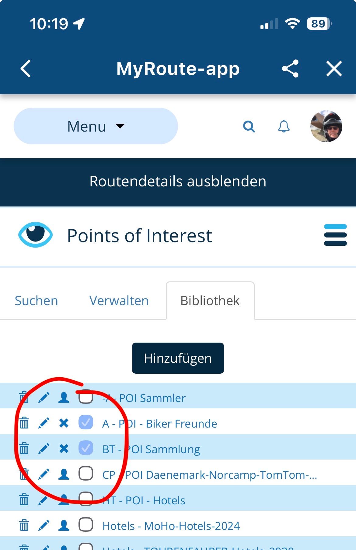

        • Hubert Thoring
          @martin-white
          Please check if other POIs are already active in the menu for continuous viewing.
          The sum is Max 2000 POI
          In the App
          In the Web Planer

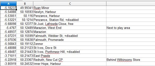

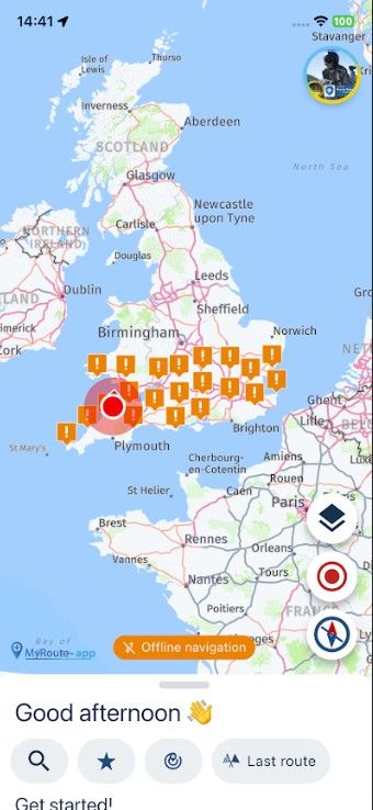

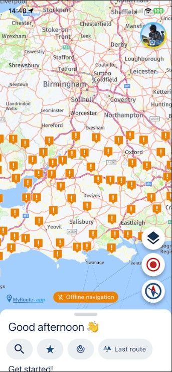

              I think if you zoom in you'll probably see more POIs appear.
              I downloaded a list of POIs in .csv format.
              It's actually a list of public 🚻 🚾 quite useful when you're of a certain age 😁
              This is how they appear on my phone:
              But if I zoom in tighter there are many more visible, there are 968 POIs in this list:

              • Hubert Thoring
                @martin-white
                I have experienced that a public file with motorcycle closures for Germany has also caused this message.
                In the downloaded file were POI s of the signs at the beginning and at the end of the route which is okay but it was also between beginning to end a route in this file.
                I couldn't see it in MRA and loaded this public file into Basecamp, where I was only able to see it. Then deleted the routes in BaseCamp in the file and there were 106 POI left. I read this file again, and then everything was good. VG 👋
                Link to the file Klick
