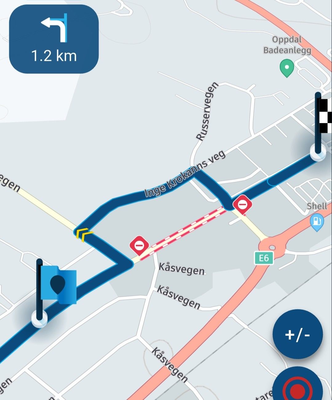

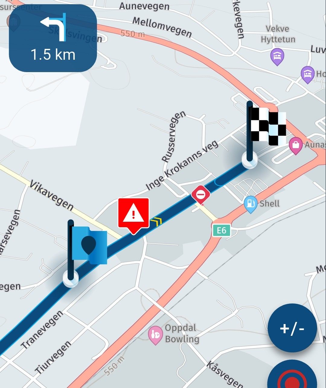

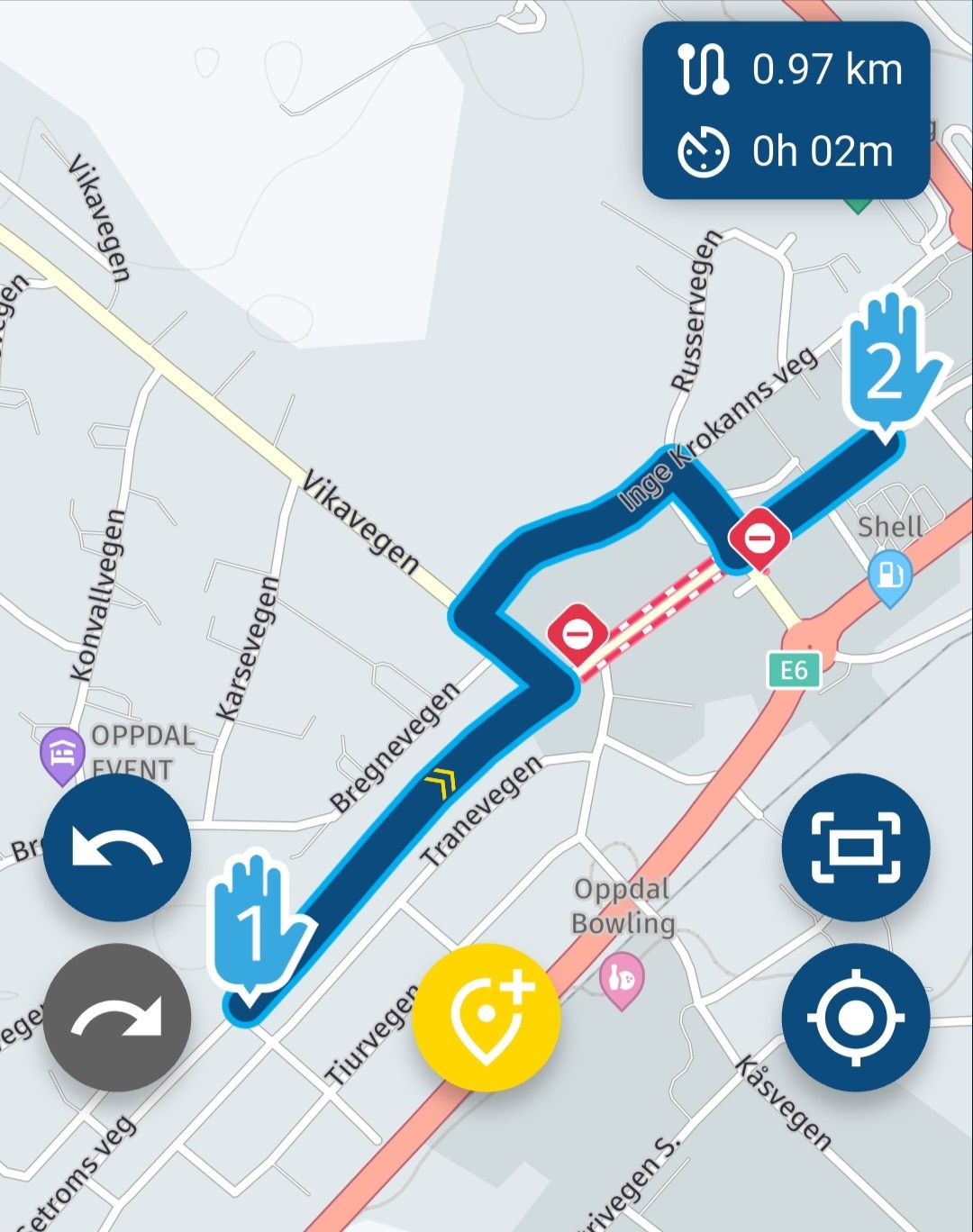

                      @Con-Hennekens not sure what you mean, but all what I am after is consistency. Ignoring closures might be the right thing to do but then i would like to see the same in the in-app route editor, without having to sprinkle my route with waypoints which don't represent anything and without having to change some settings between editing and navigating. The in-app editor is the only editor I ever use.
                      The images below illustrate the issue.
                      The first one shows my mini test route in the editor.
                      The 2nd and 3rd show what I can see during navigation (route as track). Sometimes the 2nd, sometimes the 3rd.

                        #19
                        @Herman-Veldhuizen, Thanks for clarification. Do I understand correctly that one is opened direfrom the route menu, and the other from the in-app planner? Interesting...
                        Herman Veldhuizen 1 Reply Last reply
                        • Con Hennekens Con Hennekens
                          Herman Veldhuizen
                          Herman Veldhuizen
                          Herman Veldhuizen
                          wrote on last edited by Herman Veldhuizen
                          #20
                          @Con-Hennekens correct.
                          The first one (2nd picture) from the opening page of the route (select route, navigate).
                          The second one (3rd picture) from the in-app editor (select route, edit, navigate).
                          Corjan had a look at it but I am not sure what the conclusion was.
                          I dont often start the navigation from the editor but in this case it would actually best match what I see during planning.
