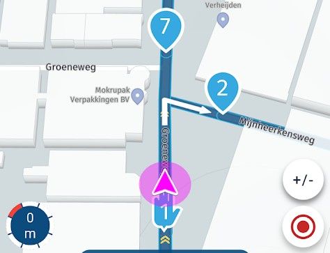

      @Hanso7o From version 5.1 (available soon), you’ll see a double yellow arrow on the route you’re following (see image below), shown in yellow on top of the blue route line. You’ll still need glasses, though. Unfortunately, the font size in the app is not (yet) scalable.

          @Hanso7o, I don't understand the problem... Even when parts of your route overlap, navigation is still guiding you in the right direction. Instructions are still good, and the white arrows show you the way.

            @Con-Hennekens Well, that's something new to me. I do NOT have the white arrows at overlapping points detailing which direction. Also, the referenced example within the image isn't something that may be setup where it displays the step numbers. Rarely are mine so close, as yours displays - which is something I can try and use - however, my eyesight doesn't always allow me to distinguish those numbers accurately or confirm I knew the previous step number either.
            Aye, I'm fighting age and technology... but there are ways as I've suggested to overcome these issues if they were additions.
            As for the arrows not being there, I'll reinvestigate.. thankyou.

              @Hanso7o, These arrows are shown whenever an instruction is given. If no arrow, continue straight.
              The route points that close to the crossing is of course only to show you, but certainly NOT best practise 😉
