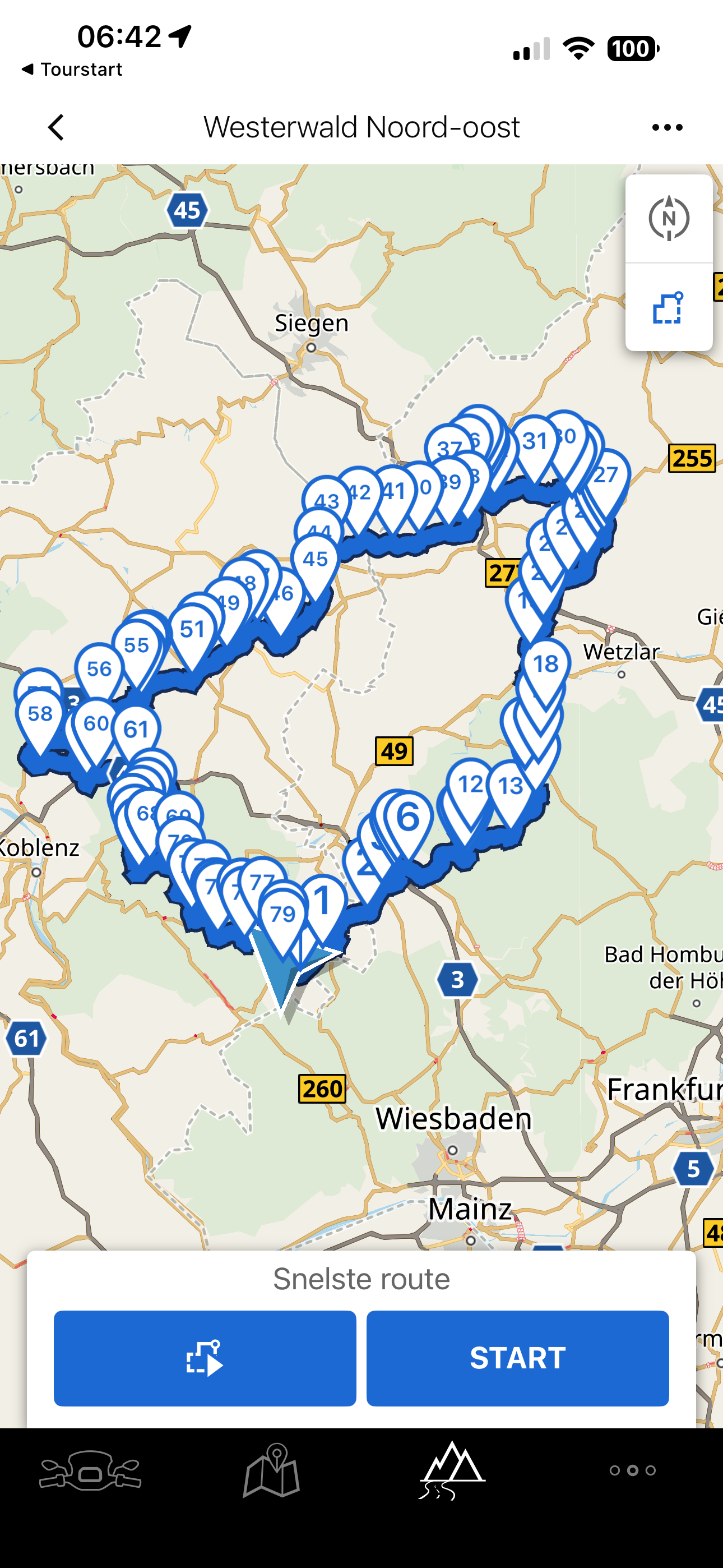

        But unfortunately that's all Via = forced points that's no fun 😂
        That's what you selected in the CRA, but you don't recognize the previously selected Via points from the planning in MyRouteApp anymore.

          I know, because it is TomTom technology

            That's why you need to use the track and not the route.
              And it is a pity that the via points are not taken over for an MRA planned route, the route is the 1:1 solution, but the information about the via is unfortunately also missing.
