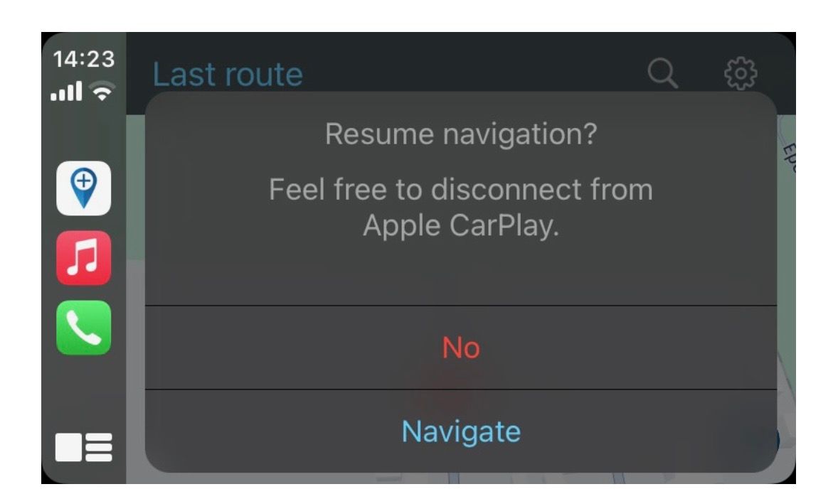

    Hi!
    When riding a route the navigation seems to stop pretty frequently (and unwanted). The message "Resume navigation?" then appears on the screen of my Chigee. When clicking "Navigate" the app goes further where it was. The same thing happens when I tried to go out of the map and search for a tank station. I was unable to search because this message keeps popping up. Any ideas?
    I'm using a iPhone 15 (latest iOS 26.4) and a Chigee AIO5 Play (for BMW) with the latest firmware (1.8 as I can remember).
    Thanks in advance!
    Sven

        Thanks! So, that explains the last issue. Still wondering how to cure the issue where the message pops up without me doing anything.

            I discovered that it’s actually a “user error.” If you (accidentally) click the magic wheel in the opposite direction when making a selection, it goes “back.” This causes the software to think you want to close the app.
            Maybe the developers could remove this feature and add a real “stop” button instead? For now, I’ll just set the wonder wheel to control the TFT instead of the NAV.
