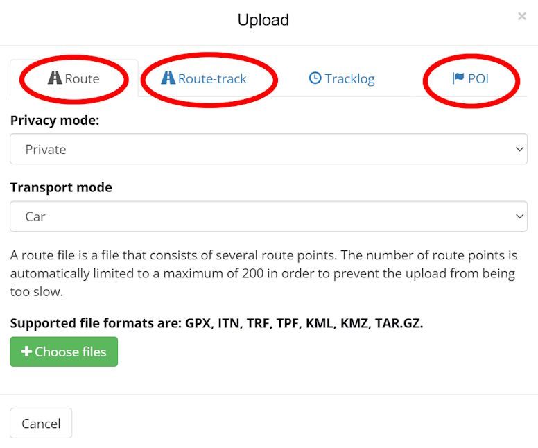

                    I blieve, we have the same understanding, but may using other words to explain - or translation does it not in best sense.
                    MRA does it in it's own way and sepereates data in stricktly separated areas:
                    • Tracklogs - which sould collect only own logged travels (as tracks)
                    • Routes - which collects own or received routes and received tracks (here called Route-Tracks)
                    • POI - which collects Points of Interests (in gpx standard named as <wpt>
                    For the moment, I will not discuss this.

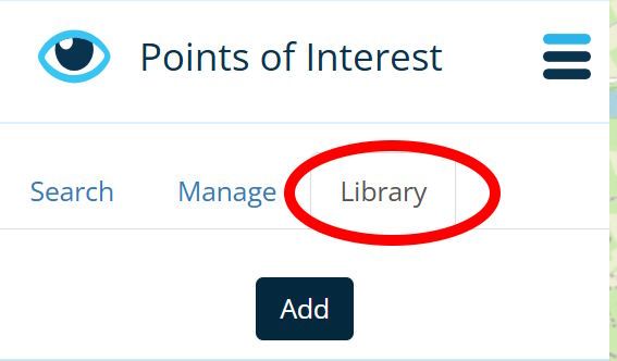

                    But I'm asking towards development: based on given build in MRA - if a gpx is going to be imported (which contains a route <rte> and <wpt>. Can we get a solution:
                    • to import in one hit the <rte> into the area "Routes" (as route) - and the <wpt> into the area "Routes" / Section "Point of Interest" / tab "Manage"?
                    • to Import in one hit the <trk> into area "Routes" (as Route-Track) - and the <wpt> into the area "Routes" / Section "Point of Interest" / tab "Manage"?
                    But yes, I see: this will change a paradigma in MRA, because until now Route-Tracks can't have Points of Interest.
                    And I consider: what if a gpx file does contain both <rte> and <trk> - and if there are also <wpt> in?
                    I believe we need 2 import actions: one for Route and another for Route-Track. Or it could be automated, to get both in one hit - because this is the case in current MRA build if there are 2 routes or 2 tracks in one gpx file to be imported (it creates that separated).
                    And I also consider: in this case, a gpx file does contain <rte> and <trk> and <wpt>. To which one sould be the imported <wpt> belong to? To the Route, to the Route-Track, or to both?
                    I prefer to both, because if to one of them it's not necessary to get the <wpt> - it's more easy to delete them (one by one), as to enter them (one by one) with search of position afterwards.
                    Yes, other Apps can show more than one track in the same map; MRA doesn't. But I think, there is no need to change this in MRA also.
                    I can imagine, this would not be a big effort, but a "masterpiece" - which resolves the problems we are discussing here and makes many users happy. And brings MRA again a step vorward in relation to DMD 😉
                    I know, many users are there, who will love it - but the "louder" ones are those with Carplay issues...

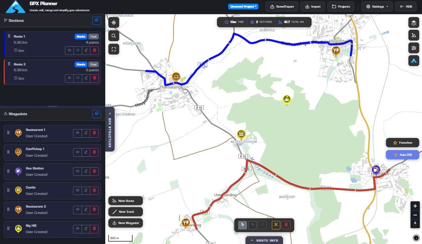

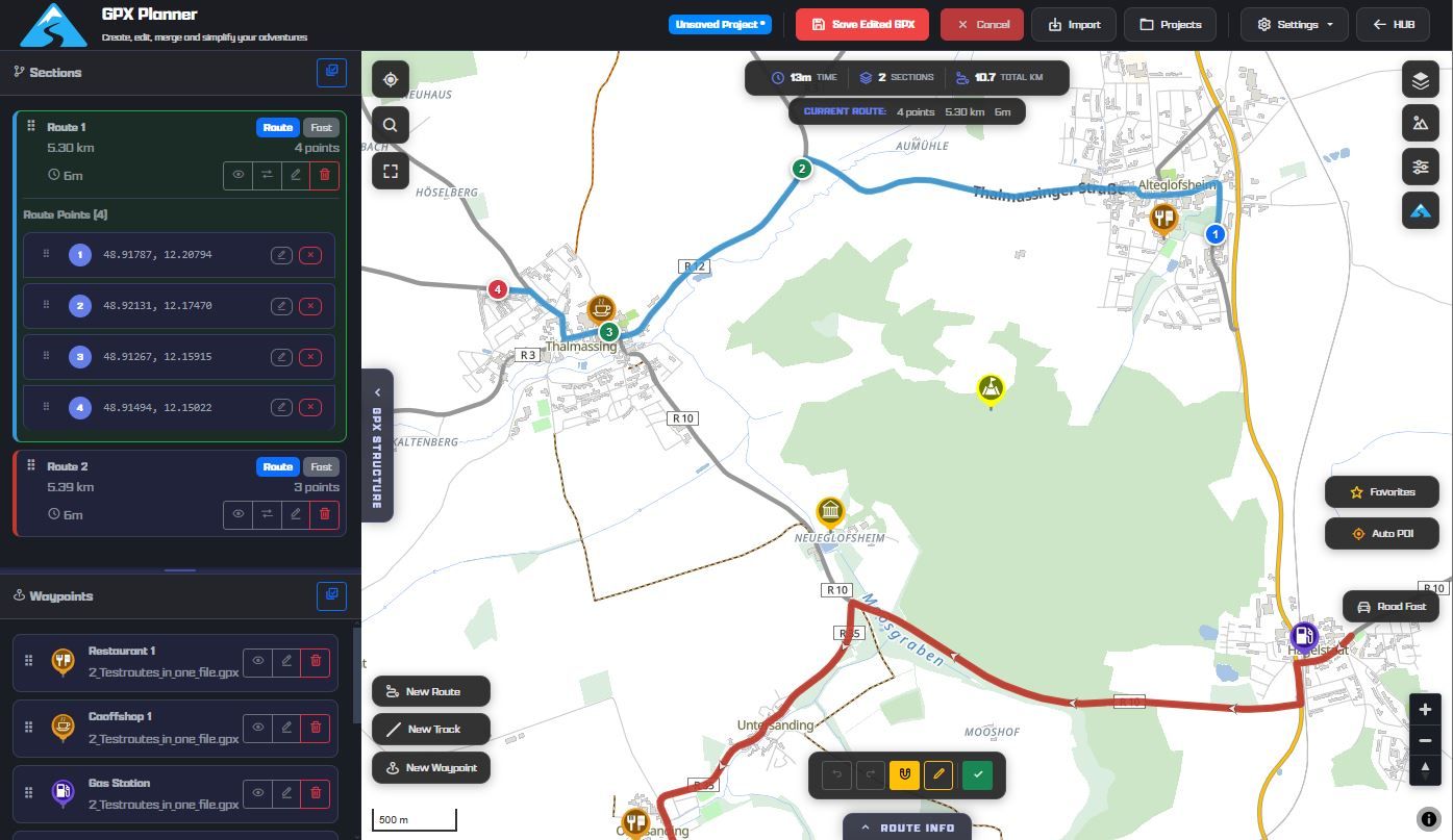

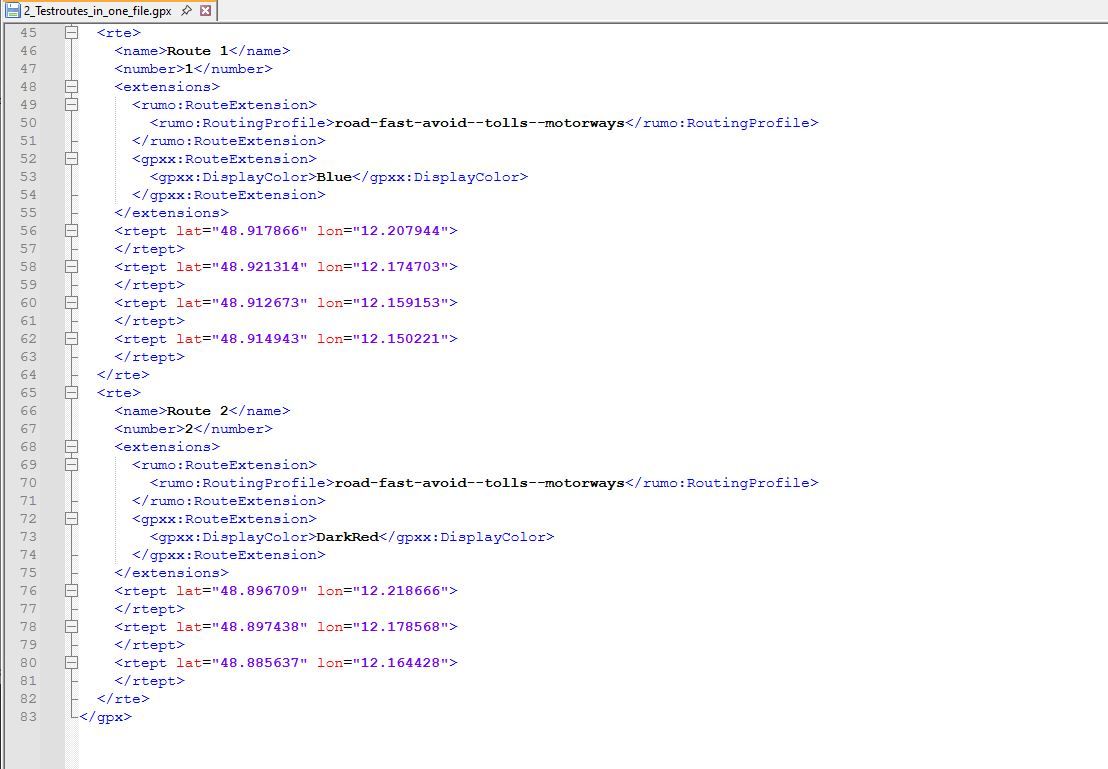

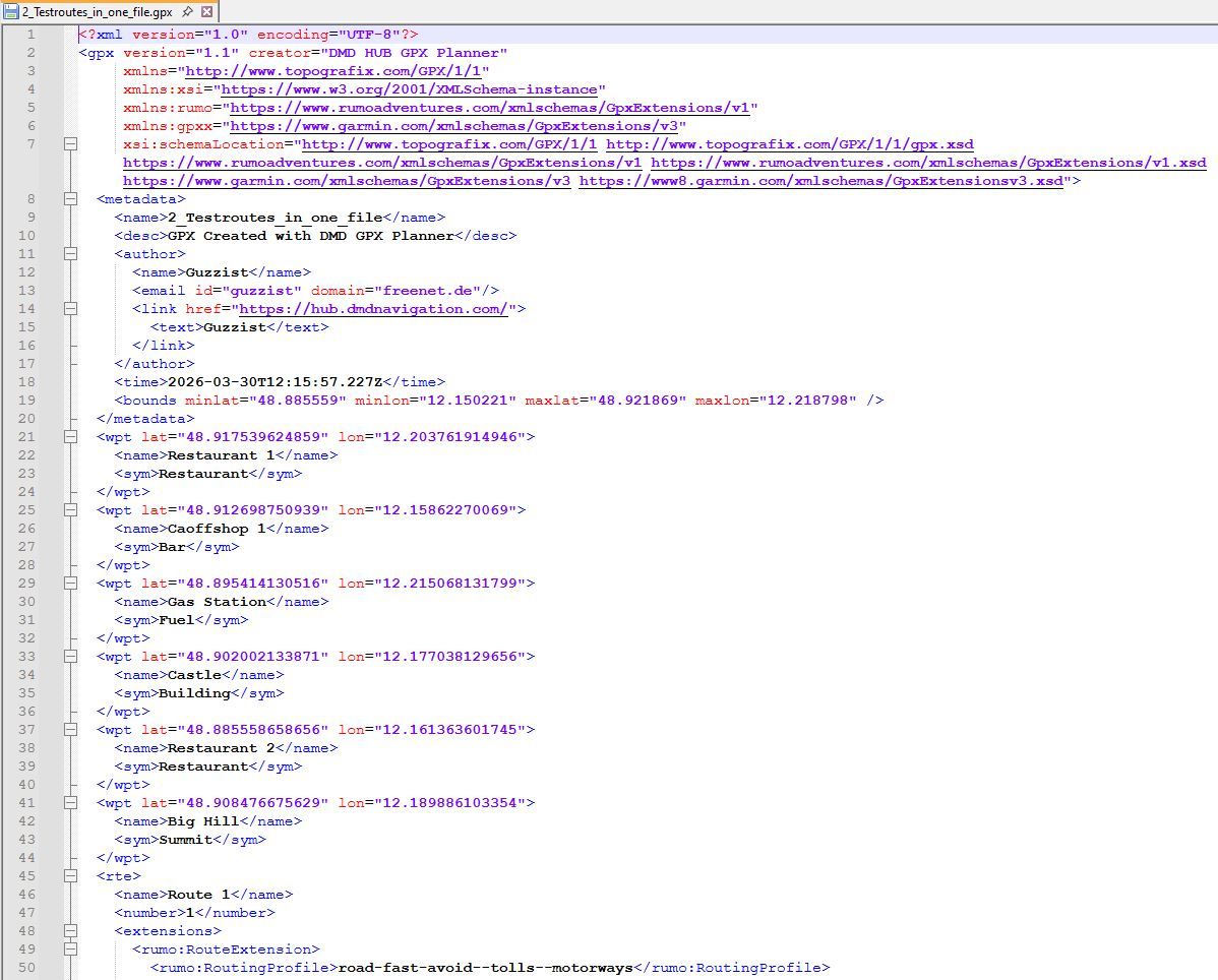

                    Bay the way: DMD does also exactly was gpx standard is: showing groupwise content of a a gpx file. All routes <rte>, all tracks <trk>, all waypoints <wpt>. But they don't belong to each other; they are only in one file.
                    The only belongings are trackpoints <trkpt> which belongs to tracks <trk>.
                    And routepoints <rtept> which belongs to <rte>.
                    (see attached images)

                                  I'm a bit confused and wonder if development was running in a strange direction with "navigate route as track"...?
                                  I know the sense of this, but my intention is, to get a gpx file which contains a track only and navigate by this.
                                  If I import such a file as Track or as Route-Track - the result is always the same - no matter which preferences I select: I get always a blue and a white line, if I start navigation with. That's annoying! I know, I should follow in this case the white line. But this forces unnecessary extra concentration!
                                  The only mitigation I found is: select this Track or Route-Track for navigation, but start as "free ride"! Result: you will get only a blue line and you can navigate by clearly following the line (as usually for track navigation).
                                  Same issue is reported by @Martin Wilcke https://forum.myrouteapp.com/post/75062
                                  Second issue: if gpx files contains waypoints <wpt> (POI), the import procedure operates that like stepchilds!
                                  In case, gpx is imported as track, this points will never be imported!
                                  In case, gpx is imported as Route-Track, this points will never be imported!
                                  In case, gpx is imported as Route, this points will be imported as shaping points!
                                  But why? The export procedure does it correctly.

                                  @Guzzist said in How to navigate a track?:
                                  I fully agree, but I think it has to do with the database structure (I believe POI is added later??)
                                  the fully exported GPX file (route-track-POI) from MRA wil also not be the same when imported again in MRA
                                  Bouke Ent 1 Reply Last reply
