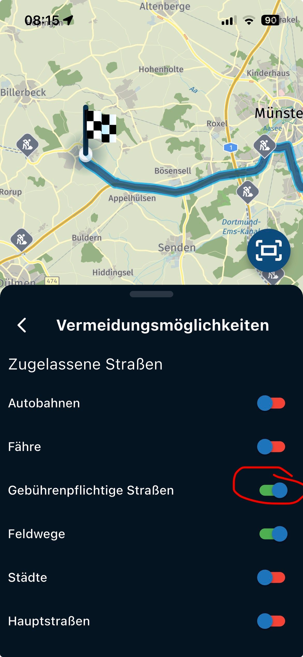

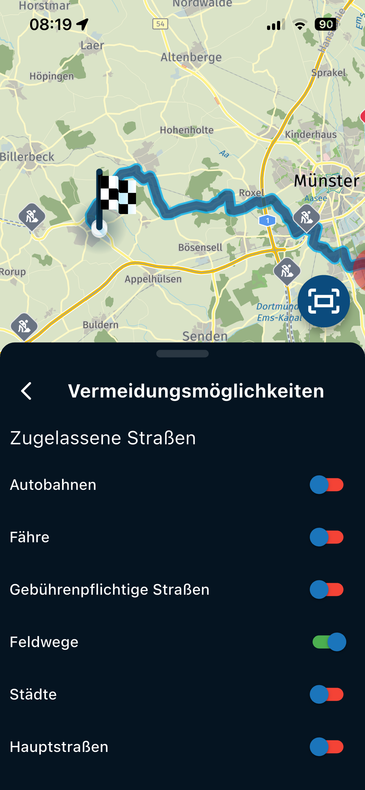

                      • Hubert Thoring
                        @TomOnTour , @Jörgen , @CD130
                        Hey can confirm the error, switch off the chargeable road at medium curve, then the A43 will no longer be used for me !!
                        We do not have such a chargeable street in the region !!
                        Hey kann den Fehler bestätigen, schaltet mal bei mittlerer Kurvigkeit zusätzlich die Gebührenpflichtige Straße aus, dann wird bei mir die A43 nicht mehr genutzt !!
                        Bei uns gibt es keine solche Gebührenpflichtige Straße in der Region !!

                          TomOnTour
                          TomOnTour
                          TomOnTour
                          @Hubert-Thoring @CD130 @Jörgen
                          Thank you very much for all the information.
                          I have done some more testing and can confirm, that switching off "Gebührenpflichtige Straße" fixed te issue.
                          I also dine sommore testing around potetial different behaviors between iOS and Android and can confirm, that both versions behave in exactly the same way and the workaround provided by Hubert works for both platforms.
                          So, that leaves one fna question (at least for me):
                          Why does Here classify the A4 not as Motorway, but as a toll road?
