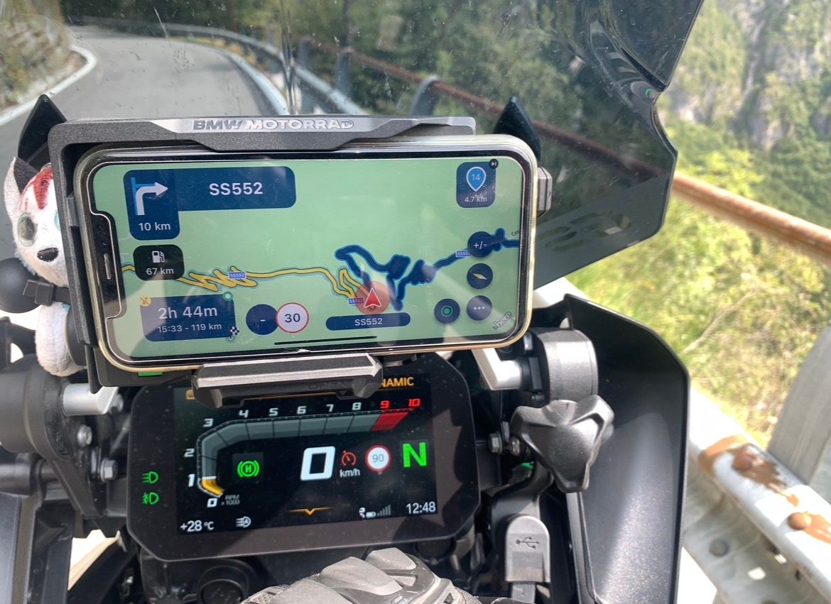

                Pretty soon after purchasing the Remotek One, I also sold my CarPlay box. Personally, I would go for a good phone holder and a good remote.
                  I use the BMW-Cradel solution, works very well, horizontally but also vertically on my R1250GS 👋

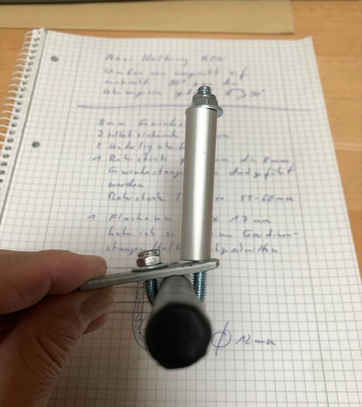

                      @Hubert-Thoring Hi! Is this a special cradle or the stock one? Some kind of the adapter needed for the stock one?
                      Thx!
                      Positive emotions are worth every penny ;)

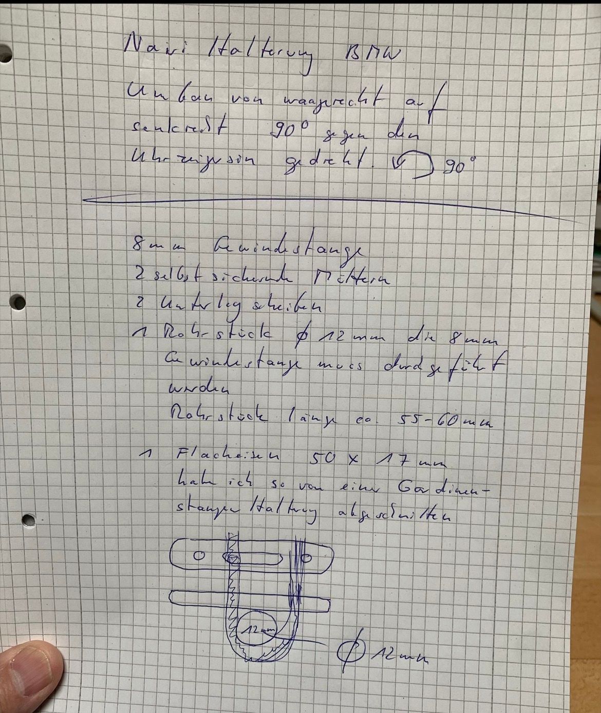

                        @lenny-o @iain.gardengmail.com
                        8mm Ruinstang
                        2 self-secure Mittern
                        2 untrleg skeien
                        1 piece of pipe Ø 12mm the 8 mm Ce wind rod must be dundgefilt Wardan Pipe piece length approx. 55-60 mm
                        1 flats 50x x mm
                        I hook so from a Ga dimen-stangen/talkey absinitten
                        iPad 9. Gen iOS 26.5.2/ iPhone 16e iOS 26.5.2/ Navi iPhone Xr iOS 18.7.9 / PC mit MS Win11 /❗️MyRoute-App im Cradel und Remotek-One❗️ Info zu MRA & Remotek One

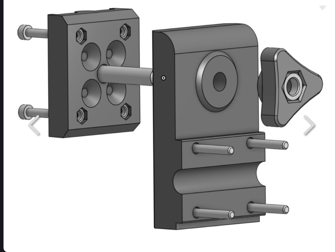

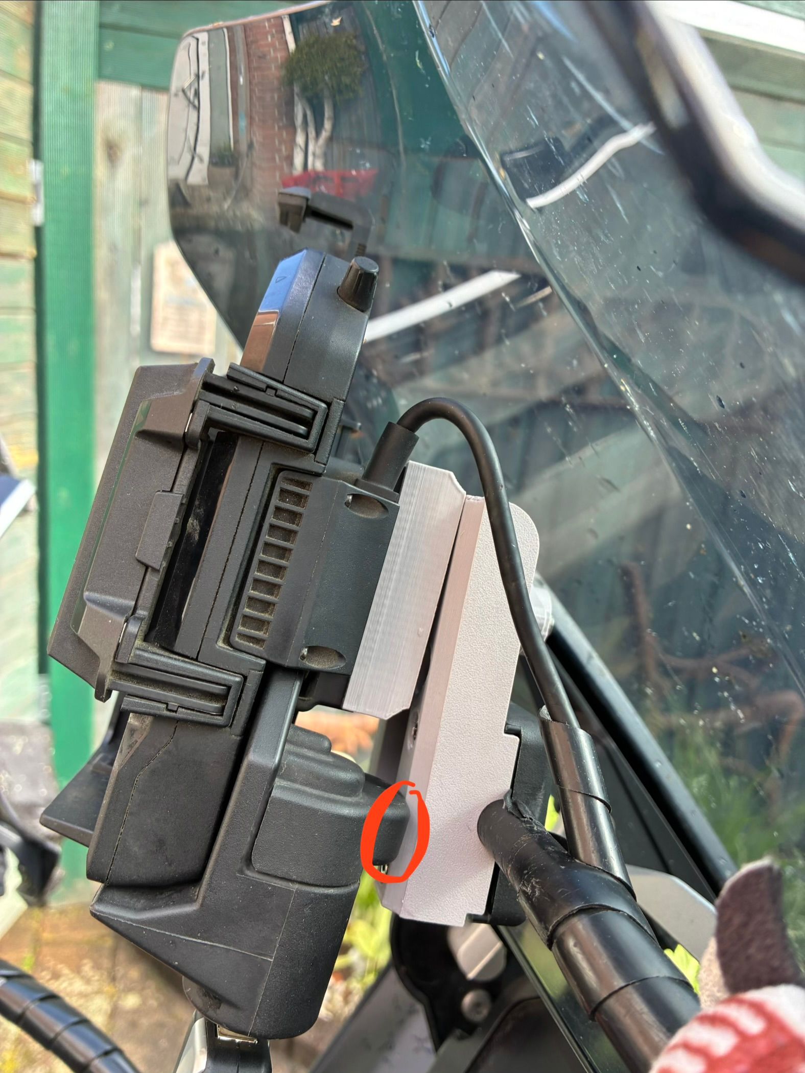

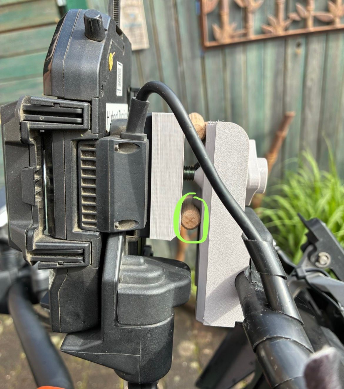

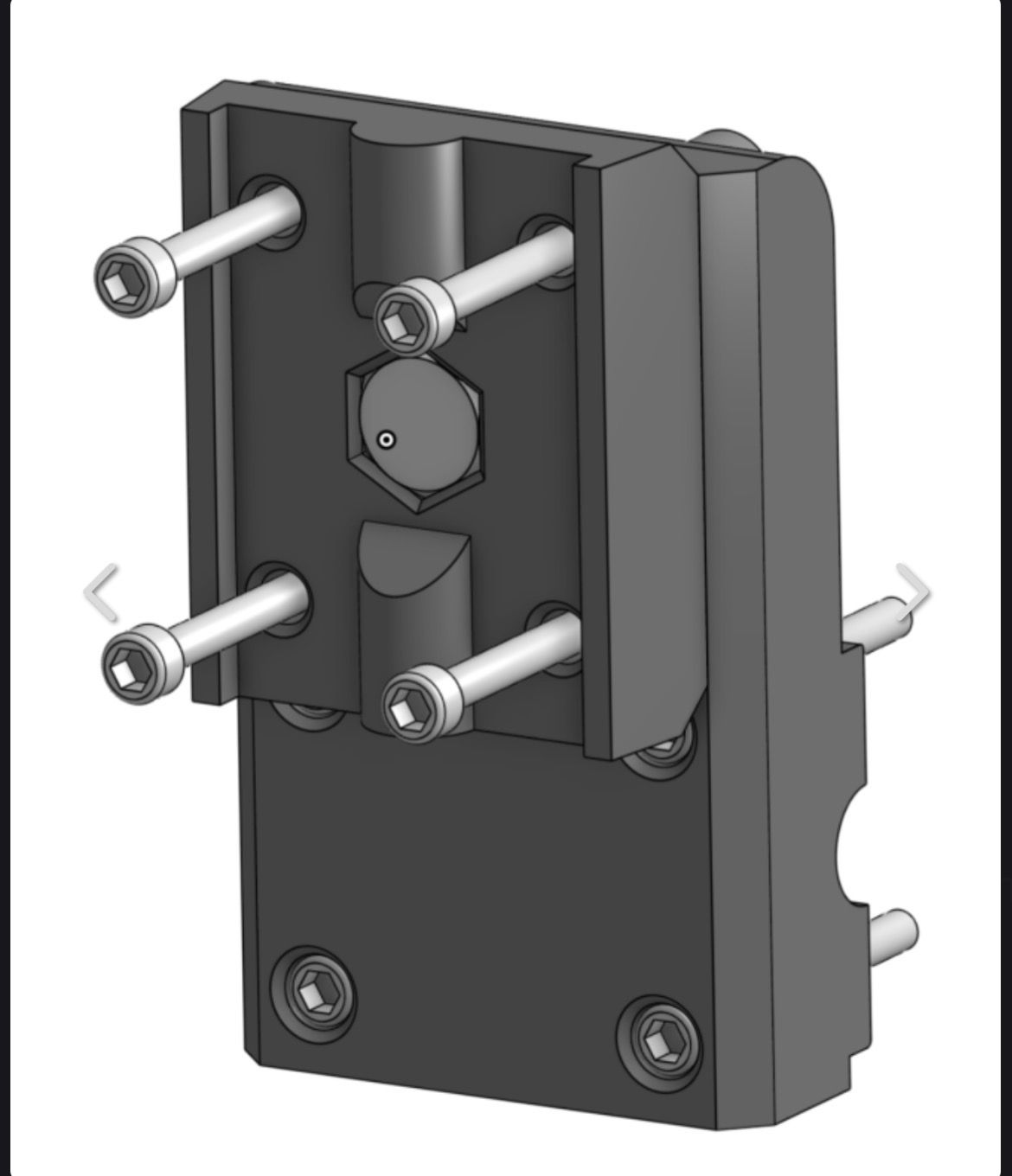

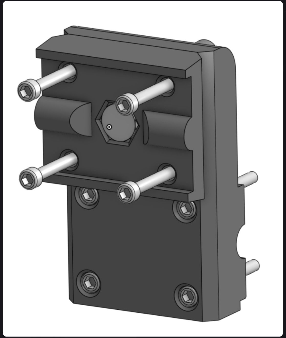

                          The next step is still in the test, so you can turn it very easily from horizontal to vertical ... see sample idea
                          This is the 3D pattern print, there are still 10mm missing because of the lock of the BMW bracket.
