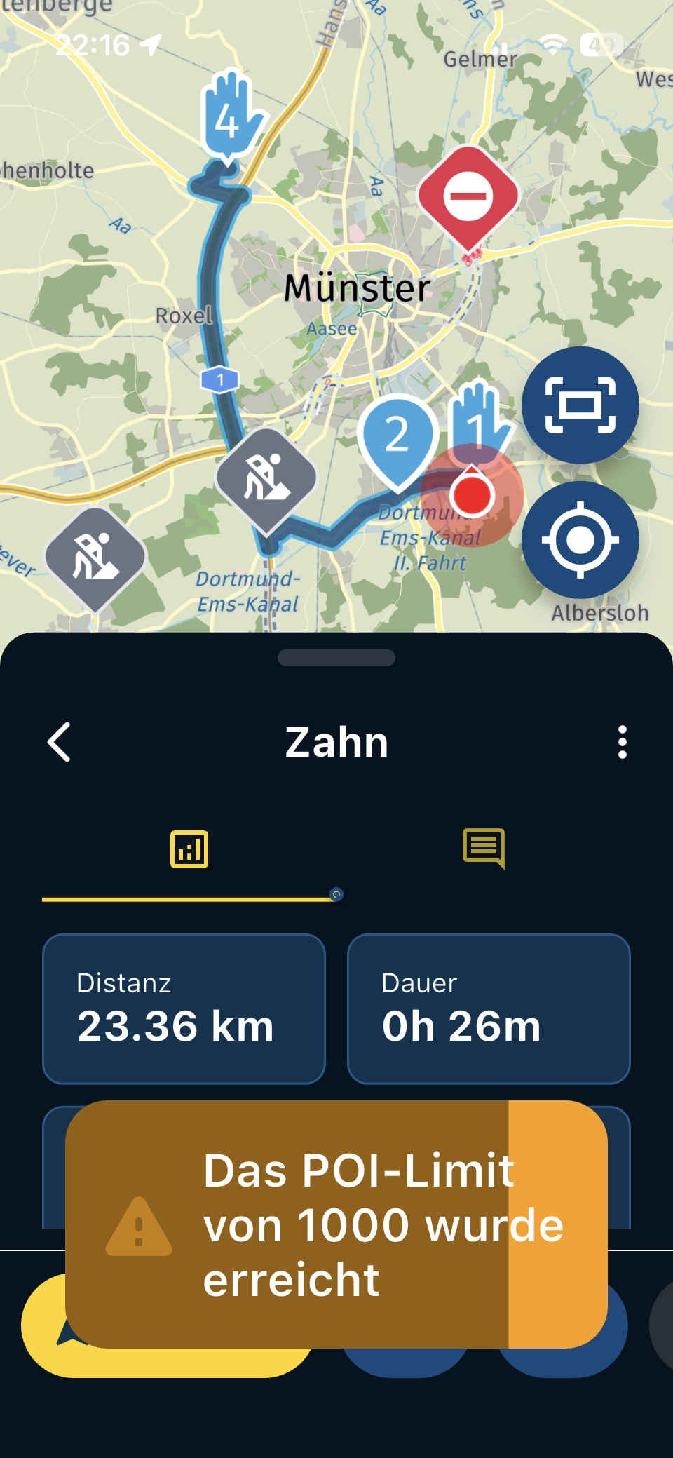

    Just opened a route with a few WP and a few km, and this message came.
    • Limit of 1000 POIs
    What is this supposed to tell us as users now?
    • It irritates
    For four other routes, this message came each time.
    Please, that certainly shouldn't happen with every route, should it?

        • Hubert Thoring
          The question is what exactly is meant here with the POIs. How is here what how exactly counted up to display it.
          The route has not received any POIs from me, are they only on the map?

            • Corjan Meijerink
              The route you opened “zahn” apparently has more than 1000 POIs loaded from most likely one of your own POI groups.
              You probably enabled a POI group by default for all your routes in your account
              • Hubert Thoring
                In the web planning I have always activated the POIs of the Alpine passes, and closures ...
                The route tooth has been created directly in the MRA app directly...
                I would say that no user is aware of what MRA is in the file ...
                How should the user behave?
                  @Hubert-Thoring if you disable those POI groups, the warning will for sure disappear.
                  I don’t see why you’d need all those POIs loaded all the time 🙂 You enabled the POI groups to be enabled for all your routes so you are aware you did that.
                  Especially because of that we added this setting. Users were unaware of the fact that always showing 10.000 POIs would cause some issues with performance 😉 Then they get mad at our app while they were kinda abusing a feature which in their defense is wasn’t smart of us. Hence we now limit the POIs

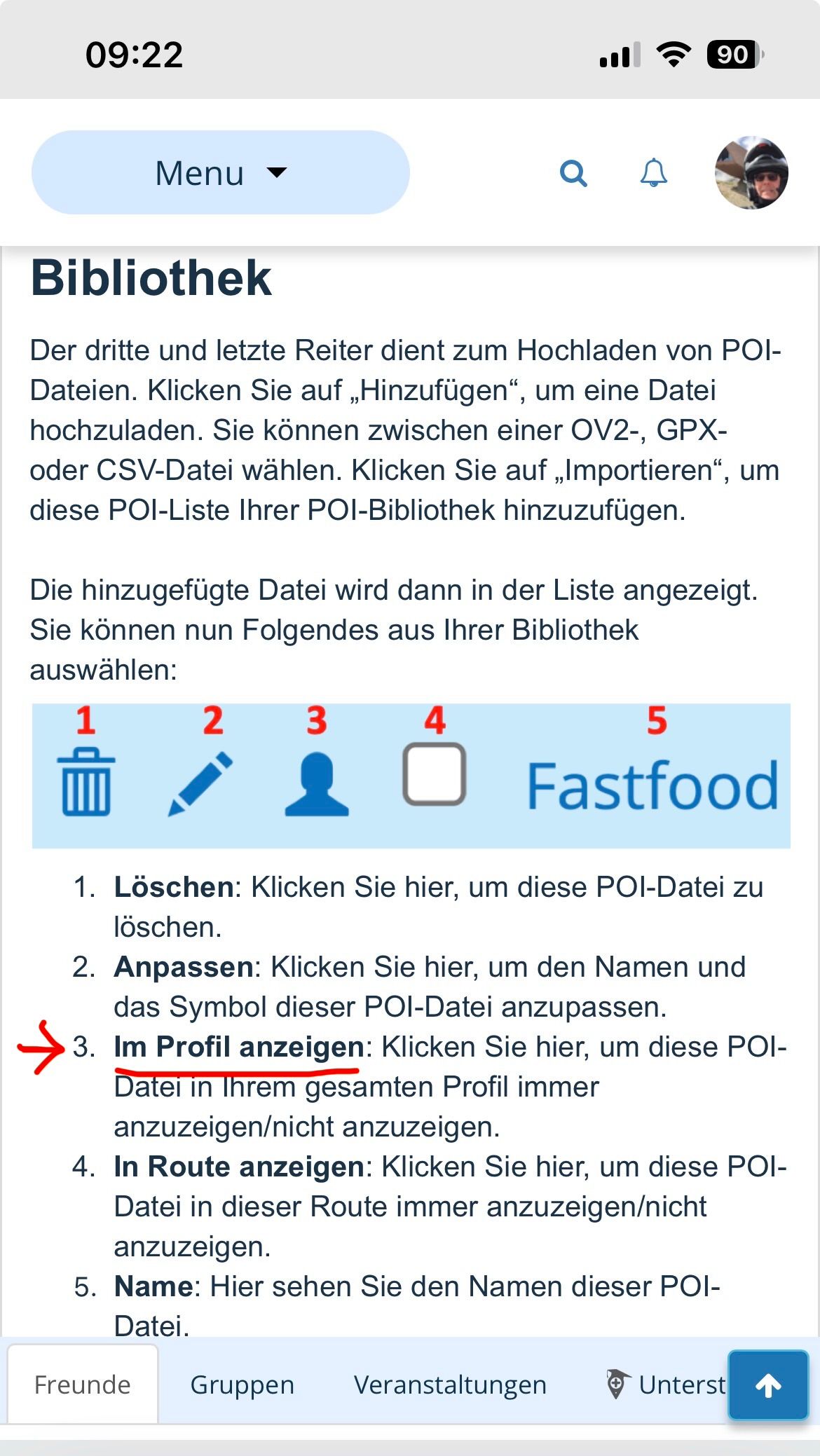

                            Can you please explain to me in this context what No. 3.) does exactly ...?
                            • Im Profil anzeigen
                            • Does that mean the profile will then automatically be displayed in every route?

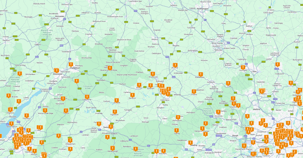

                                  As a man of a certain age, I have a POI list of public toilets in the UK. The list has 2260 locations. As I live in the south I have no imediate need to visit loos in the north. I opened the original .csv file in Excel and sorted the two columns that contained the coordinates so that the most southerly was at the top of the list. I then deleted the 1260 that came after the first 1000, saved the new file and uploaded to MRA. Perfect, but I can't go further north than 51.8° 😊

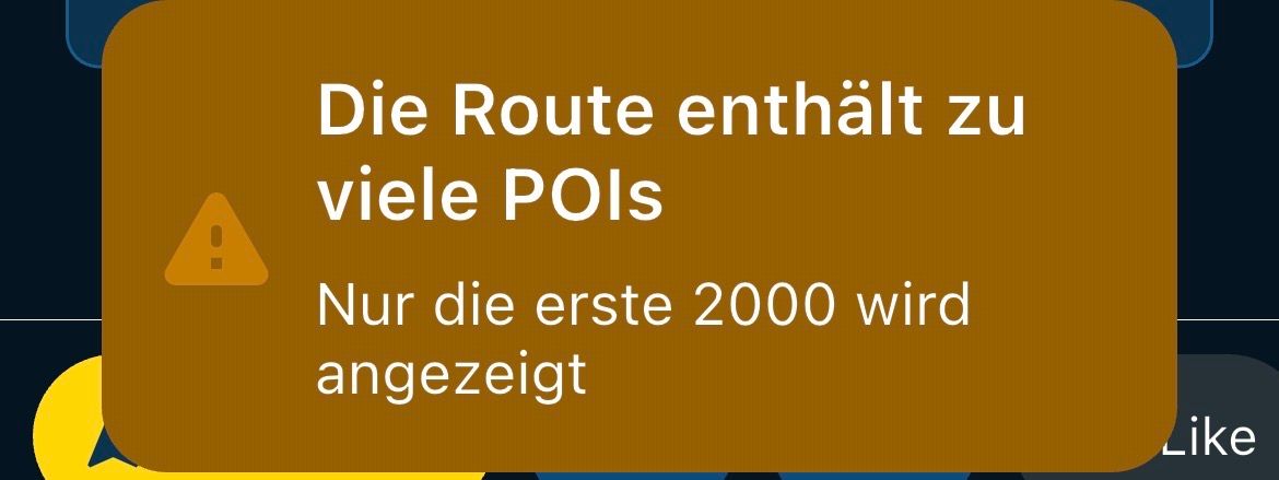

                                          @Corjan-Meijerink ; The suggestion regarding POIs is now very helpful; I think 2000 is a good number. I also think many users aren't aware of the performance loss for the app when the number is too high.
                                          This is a wonderful solution in the new update V5.0.1-433 !!
