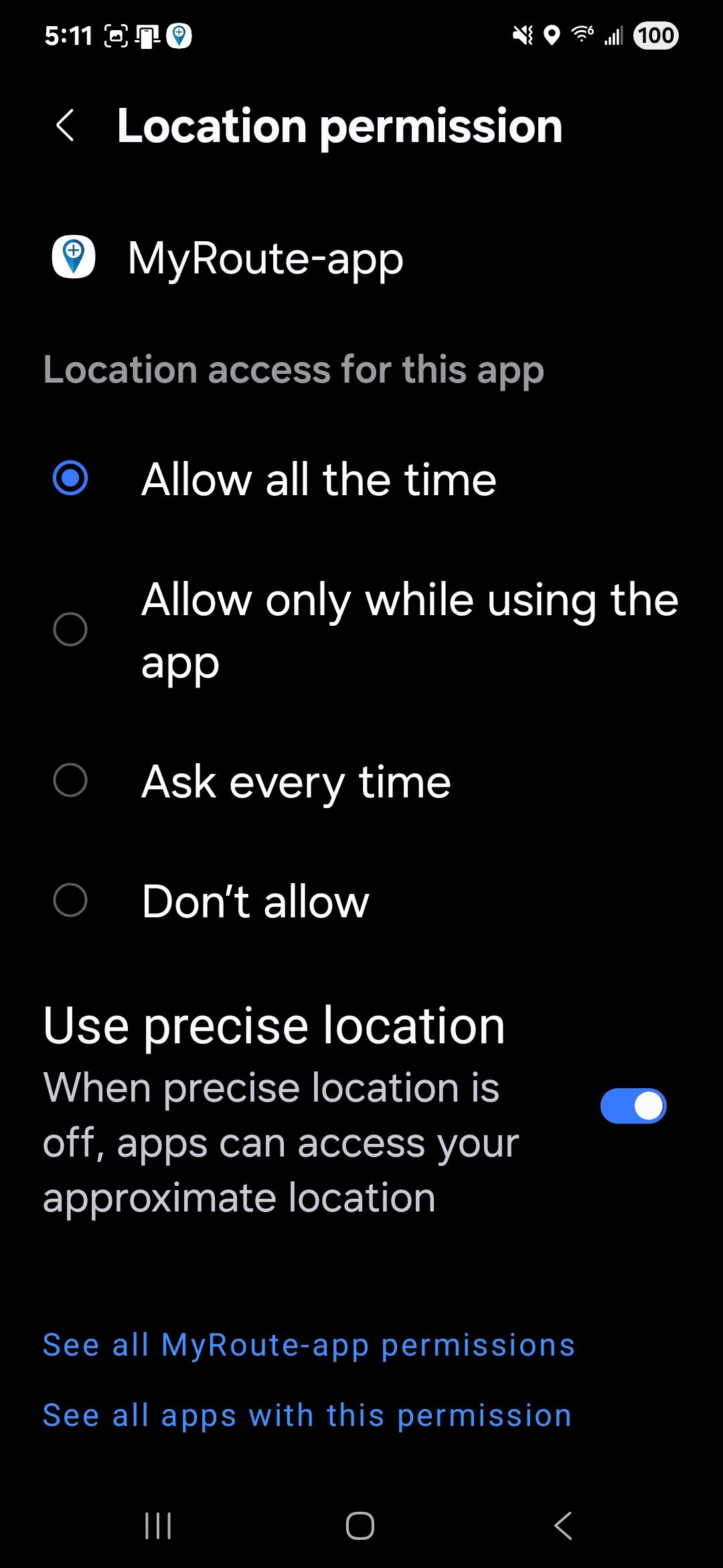

    What I would like to know is whether the MRA app also veers off while navigating without this Android Auto connection. I bet it does not 😉 My Ford Sync3 has a very similar problem, which I mitigated like this:
    Go into your Android Settings, apps, all apps, search for Android Auto, Permissions, Locations, deby location permissions to Android Auto. If you do this, the MRA app will fall back to the phone its location.
    Please report back. I am very interested in your findings!

    @Con-Hennekens Con what is it I am doing here when not allowing location permission with Android Auto? Will it affect the Google maps? Will it affect my work truck which has NAV on it? I will try but I just want to understand what it is I am doing...thanks

      @Con-Hennekens OK Con I "Dont allow" location permissions. I have the bike out in my driveway and this is the first time the MRA arrow icon is even close to my home! Normally the arrow icon shows my 2-3 miles away from my home. So maybe we are on to something here. Hope to try it out tonight...Will report back...

          @Con-Hennekens I want to thank you for being patient and working with me. I'm not 100% ready to put the "fixed" stamp on it yet! Few more trips and we will see. In a nut shell, can you break down what we did by turning off the locations to android auto? What is this making my phone do or not do? I am just curious because down the road If I have any issues Id like to know if this is what is affecting any issue I have. Also should this app be able to "hold a route" like Google maps does, regardless of twist and turns? Also will I still get the real time updates on my MRA? I hope we hit on something here and we have this thing working as it should! We will be out this weekend so I will give it an all day test. When you are out riding, do you have issues with it veering off route? Thank you again for your help, you are the man!!!!!

            @D-Griffin, Glad to hear things improved by this much! To me this is "proof" that your AA device indeed does have a GPS chipset, that gets used when connected through Android Auto, and it does not function properly. Just like I suspected.
            What my "trick" does is merely prohibit the Android Auto app on your phone from using the GPS chipset built into your AA device. As a result, the Location Service on your phone falls back to using the phone's GPS chipset. This can always be reversed without problem, and yes, it will have effect on Google Maps to but you will likely not notice that.

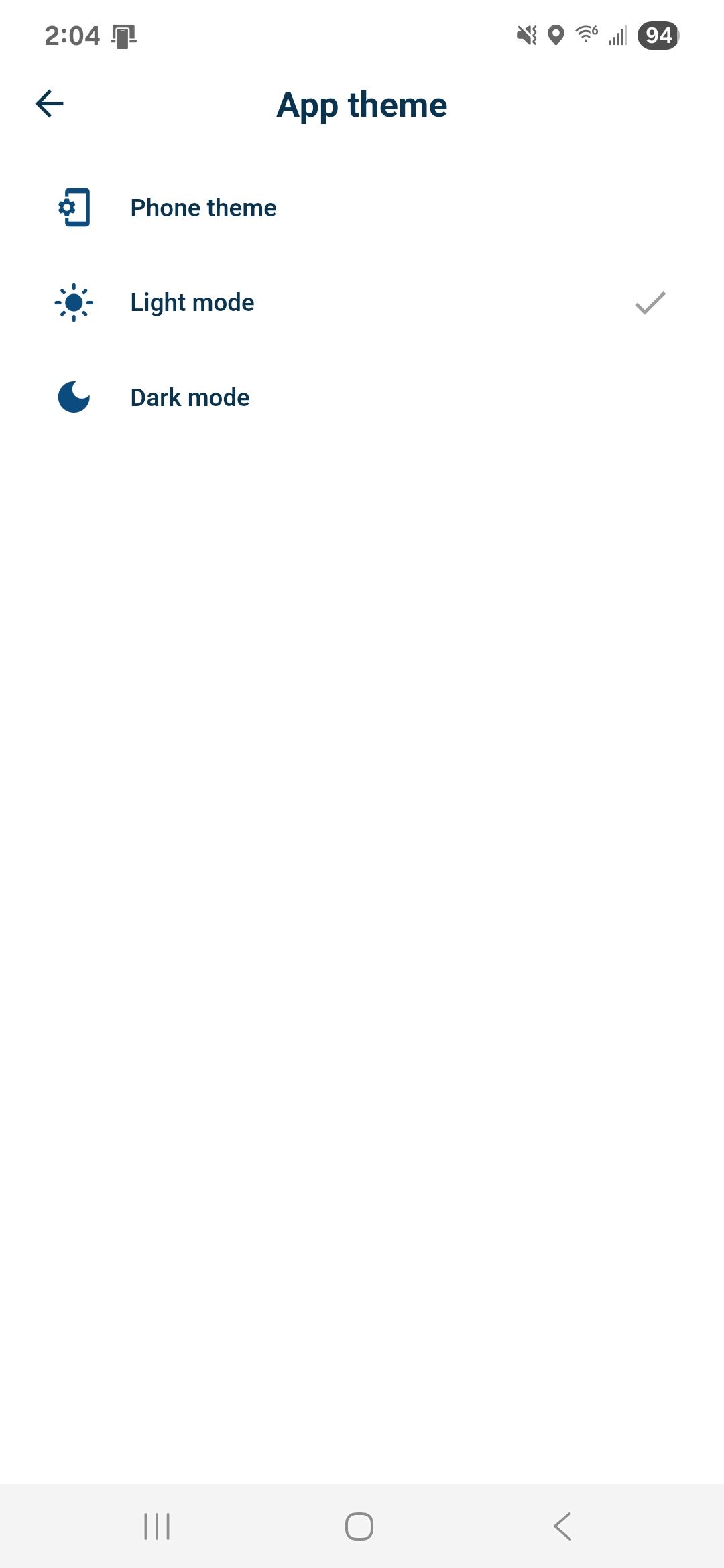

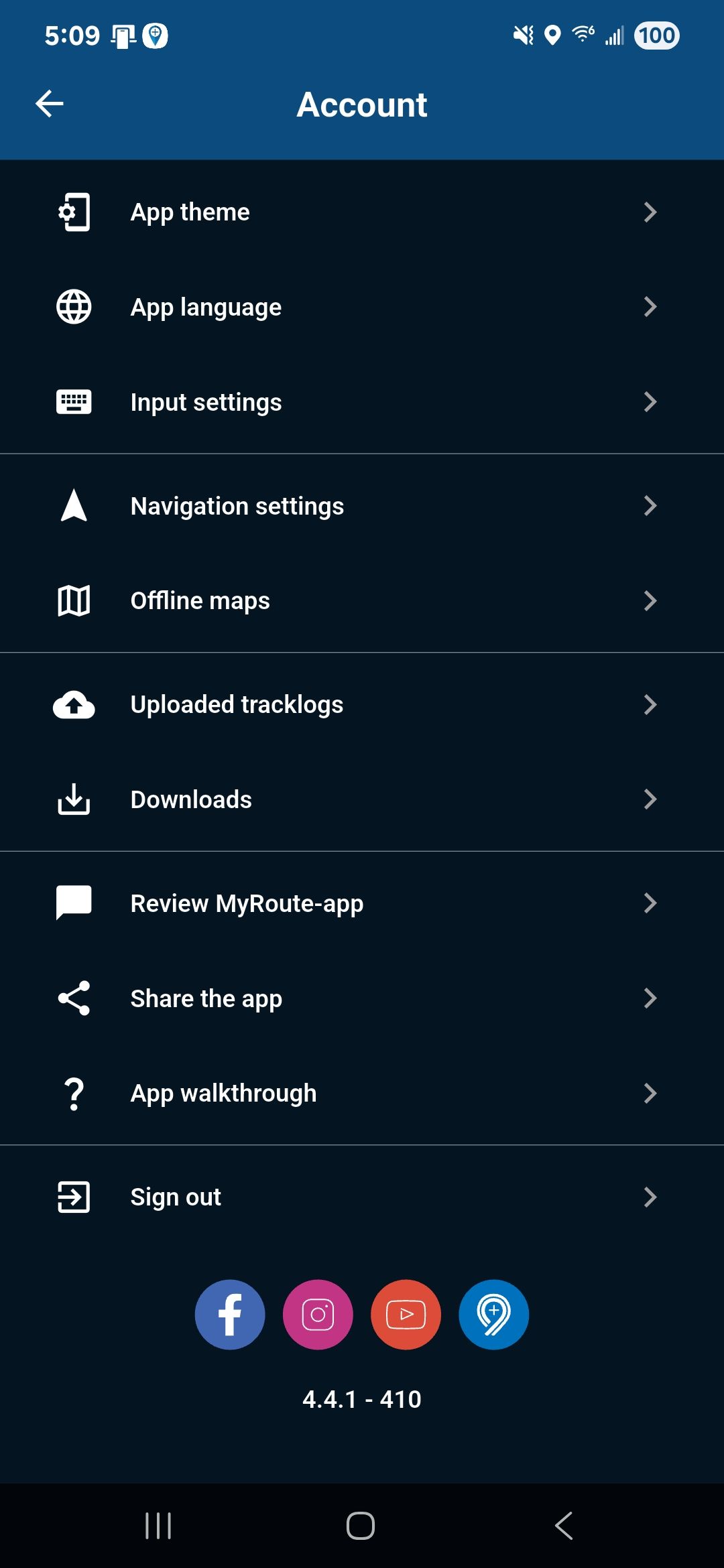

                @D-Griffin, Yes, in night-mode the theme goes dark. In day-mode it depends on your MRA-App Setting. From the start screen, tap the profile icon top-right, choose Ap-Theme from the list. There you have three choices, you can force the light theme here. Personally I prefer lowering the brightness of the light theme at night indeed.

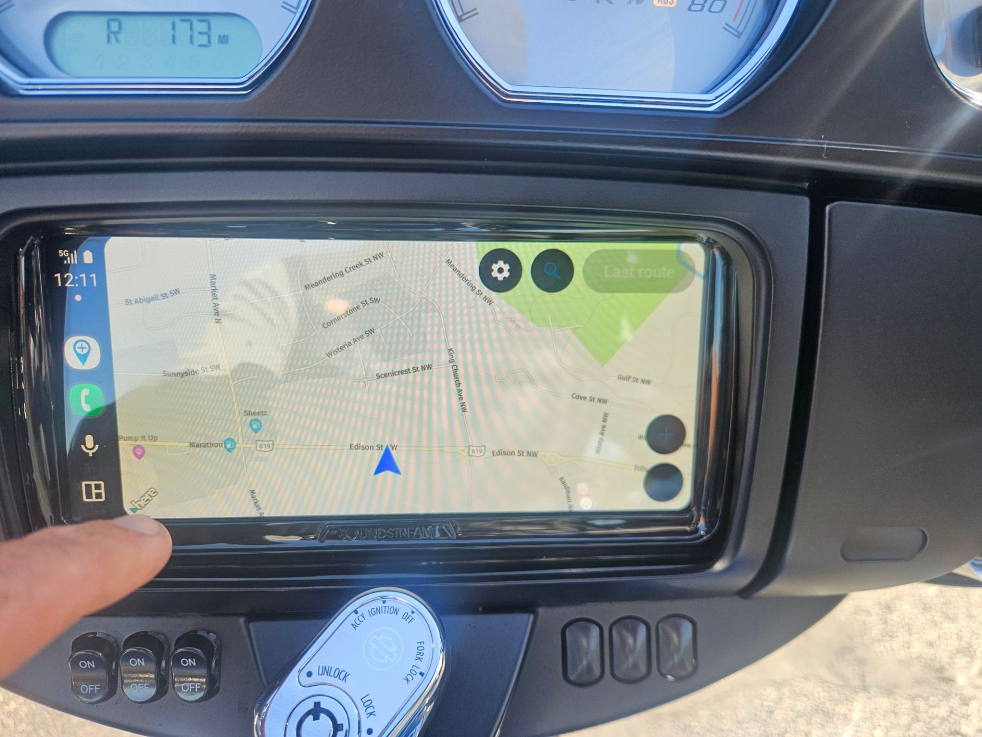

                    @D-Griffin, I have no idea, I have never seen it like that. Could it be some theme setting of your AA device instead of the app?

                      @Con-Hennekens When we were out on Saturday, I was playing with the AA device, I cant find anything in the settings that i think would affect this. If u look in the picture the "gear" Icon is still white, but the others are dark! Why not all of them dark. Weird
