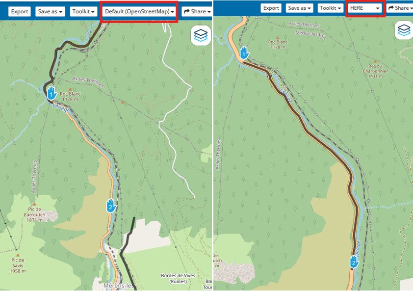

    Hi folks - trying to plan a route from France to Andorra and MRA keeps wanting to send me on a 77 mile detour between 2 points on the N20 road - screenshots show what is happening - can't seem to find any road closures or other issues to prevent such a journey - Google Maps runs down this road fine, but MRA seems to have some issue with its map, showing the road deviating away from themra-1.jpg mra-2.jpg N20 and stopping in the middle of the landscape 🙂
    Does anyone know how to fix this ? i've tried adjusting the waypoint and adding in more but it simply won't ride down this road. Just bought a lifetime sub for Gold and the Nav package and this is my first route i'm trying to plan out. Hope its not a sign of things to come where i need to revert to Google maps.

                @Steve-Kelly-0 I can only get the issue you show in the first post if I use OpenStreetMap as the route calculate option
                If I use Here or TomTom for the route calculation it is fine as you say it is with Google
                When you have 1 routing calculator giving you a bad route it is more than likely that routing calculator is working with bad/old data

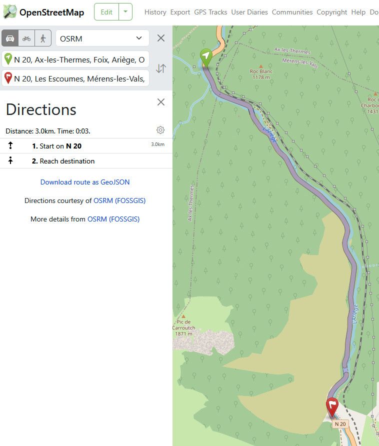

                If you actually go to the OpenStreetMap site your will see the it routes down the N20 with no problem as well
                This tells you that the issue is with the OpenStreetMap data used by MRA,
                it is known that MRA do not regularly update their OSM data, they can be very slow to update so you will come across issues like this when using the OSM route calculator in MRA
                The trick is to check & see if you also get the bad routing calculation on the OSM site
