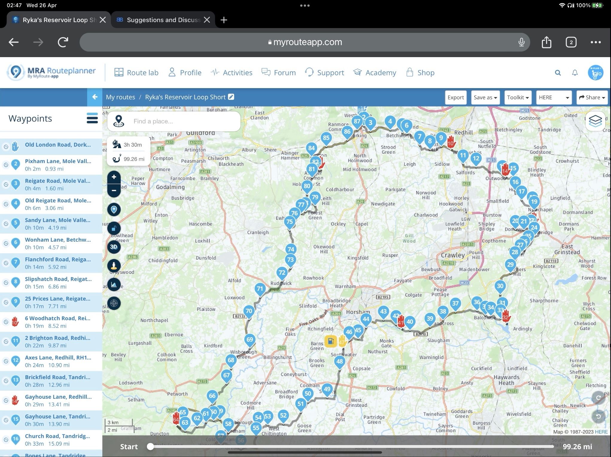

    @Corjan-Meijerink
    There are lots of posts requesting that Shaping Points are hidden within a route.
    I have no idea if this is even a viable option, but would it be possible to simulate a GPX 1.2 type Route that we usually export to our Garmin XT’s, but instead, placed directly in MRA Navigation Next?
    Out of shear curiosity, I saved a route as a GPX 1.2 then imported it back into Route Planner.
    The issue in this case is that it ignores the Shaping Points but if it could also use the Route-Track, that to me would be Navigation Utopia.
    Here’s a route of mine in full with Via and Shaping Points.

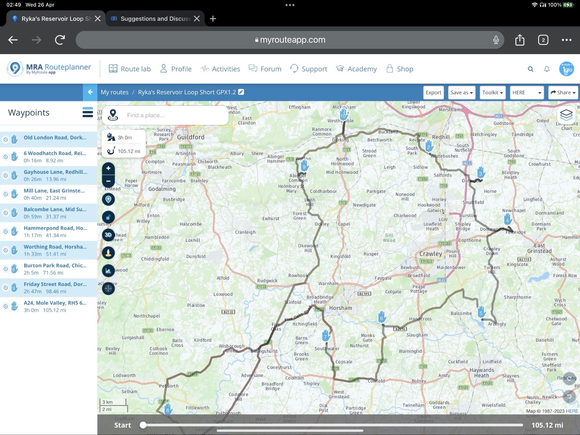

    And then the same Route Exported and Imported as GPX1.2 which unfortunately ignores the Shaping Points as it is expecting a Route-Track to be present.

      @Lynchy67, Then you would need to import it as a track and not as a route, but that will most likely also skip the Via points...
      I would prefer an option in the toolkit to copy a route to a route-track. It would be great if shaping points became absent, but even greater if colored shaping points, shaping points with a remark and all via-points would stil be present. Maybe in the form POI's, because they carry a relevance to the route-track that people will want to see on screen during their ride.

          I don't think that is correct. As far as I know the track is generated during the GPX export by MRA. The GPX contains a route as well as a track (except GPX1.2 I believe but that is beyond my Zumo experience. I haven't touched it since the introduction of MRA Navigation 😉 ). On the garmin you can choose to convert the track to a trip (their take on a route) and that trip follows the track exactly.

              @Con-Hennekens De export van een GPX 1.2 versie bevat zowel de track als de route. Deze importeer ik in mijn BMW Navigator V en ik kan de track zichtbaar maken als een lijn, én de route gebruiken. De vormpunten zijn niet in de kaart (overzicht) of in de route te zien, de VIA punten gelukkig wel. Jarenlang heb ik Basecamp gebruikt om de track zichtbaar op mijn Navigator V te hebben én de route (en overigens ook de POI's).
              Samengevat, MyRoute App (website) exporteert via GPX 1.2 zowel de POI's, de track en de route. Op een Garmin of Navigator V of VI kun je de track zichtbaar maken (via "Sporen") en in beeld houden op de kaart.
              Suggestie: Een zichtbare track zou in MRA Navigation Next heel erg welkom zijn!

                With route navigation we are able to hide shapingpoints from the map but they will always be used for the internal route calculation. So even if we hide them from the map - the upcoming waypoint will always show the shapingpoints too. If we also only show viapoints in the upcoming waypoint then skipping points will have very weird side effects.
                Example: you have a route with start - 20x shaping - 1x via (call this A) - 10x shaping - 1x via (call this B) - ….
                If we would only show via points and you skip one while you are at the start of the route you would therefore skip A meaning that the app will start routing you to B. That means that the fastest route will be calculated from your position to B. Skipping a total of 30 shaping points. Easy conclusion: upcoming waypoint must show them all.
                If you want to skip to the next via point? Just use the waypoint list.
                Hiding shapingpoints from the map? That’s possible but will more likely lead to more confusion rather than less. You won’t see the points that are actively used for route calculation.
                Now track navigation. We could show via points on the map but they won’t be included in the route calculation and you can’t have any interaction with them. Again: probably more confusing.
                Not an easy discussion 🙂 Especially for now we shouldn’t make it too confusing for the mass.
