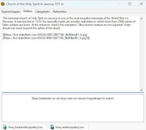

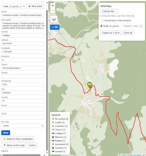

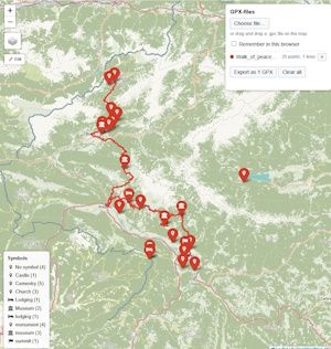

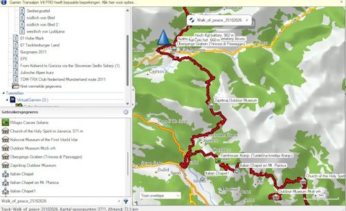

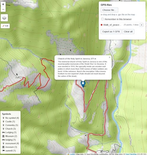

      some screenshots:
      loaded track
      Loaded GPX file
      POI without address data
      with address from openstreetmap
      POI with data
      imported in Garmin with symbols
      notes in Garmin POI

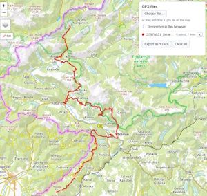

                Playing with Overpass API: getting POI near the track from Openstreetmap, mainly for Bicycle use now.( toilets, waterpoints and shelters (Dutch weather 😉 ).
                What poi's would be nice to add?
                Below a RX route near the German border saved as track and searched in a 1 km range from the track.
                Problem is that Overpass is very slow and gives sometimes empty returns, so big routes will be a problem. this route needed several attempts to get finished.
                End goal is to archive a program to upload Garmin FIT files (or GPX) to the Garmin Edge (or Garmin watch)with turn notification from a track made in MRA without the use of Garmin connect.
