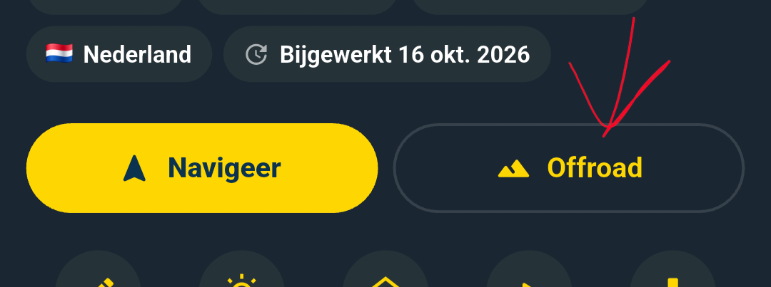

Edit: Oops, my message below is valid only for 6.0.0. - 526, not for 515 yet. Sorry!
You might find what you seek by using the "Offroad" navigation type which is also offered with a button next to the "Navigate" button.
In offroad "mode" so to speak, you do not get any recalculations and the app tries to keep you on the route as good as possible. When diverging from the route, you see a "xxx distance from route" notification instead of a instruction and recalculations will NOT be performed.
Please note that the engine that does this, tries to approach the original route as good as it can, but it may mean that not every "maneuver" is translated into a explicit instruction.
Simply try it out.
@stefan-hummelink I think this button/function is not yet available in version 515.
