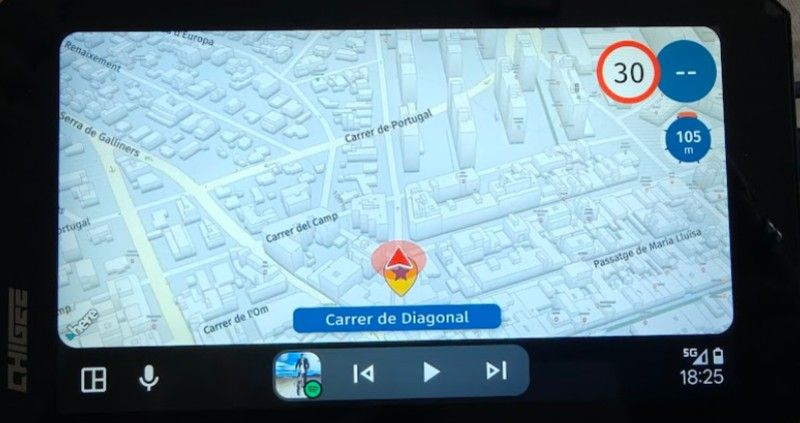

    In my case, I'm using a Chigee AIO-6.
    With the app bar at the bottom, the navigation route gets shifted significantly to the right.
    If we only show the map, without the route, it displays correctly:

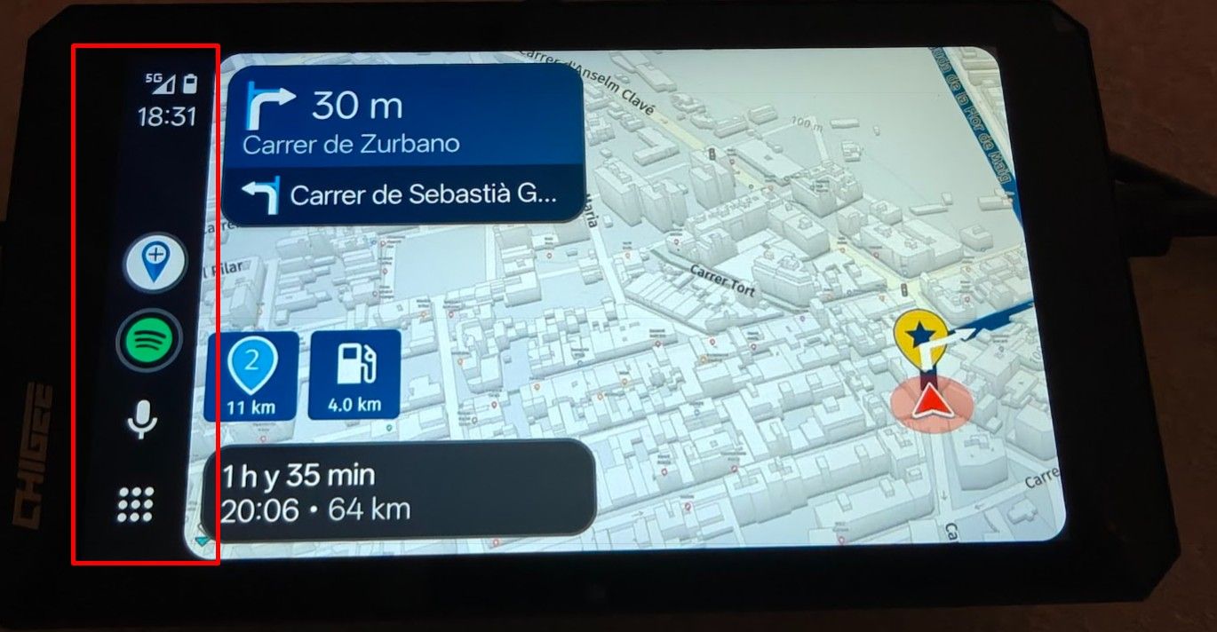

    The problem worsens when we place the bar on the left side. In addition to the issue of the shifted route, the speed and altitude controls disappear:

          The saw the issue on the RiderNav R7M AA/ACP display. When the bar is on the left side. MRA info on the right side of the screen is gone.
          The 13" screen in my Skoda has the bar on the left side by default. On this everything in MRA is visible.
