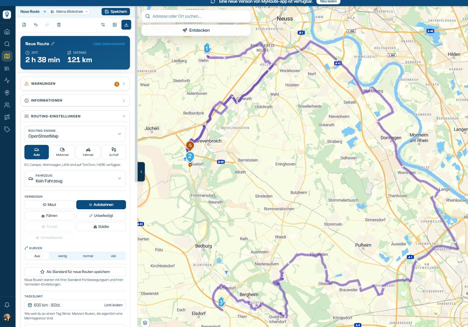

    When I click ‘Avoid motorways’ for this route
    this is the result
    31 km turns into 121 km, even though the route is only supposed to avoid a short stretch of motorway – one that could easily be bypassed.

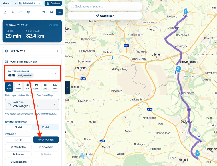

      @Jörgen The OSM map is active. If you switch to the HERE plan map, you’ll get the route you want.

        Ok, but what is OSM doing?

          @Jörgen No idea! I only use that map for cycling and walking! Since the HERE map is used for navigation, nothing has changed in that respect compared to Planner Previous!

            However, what OSM is doing in this example from Jörgen is really inexplicable—it makes absolutely no sense... because "Curvy Roads" is turned off!
            Link to Jörgen's test route example

              This is indeed a Germany specific issue within our OSM routing server.
              I've forwarded this to my colleague to fix.

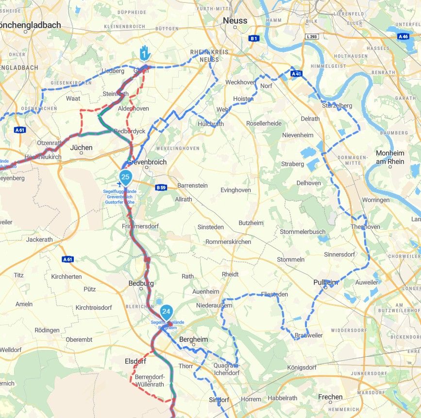

                  It looks like OSM does not like my area. 😂
                  Another crazy routing; see the blue line.
