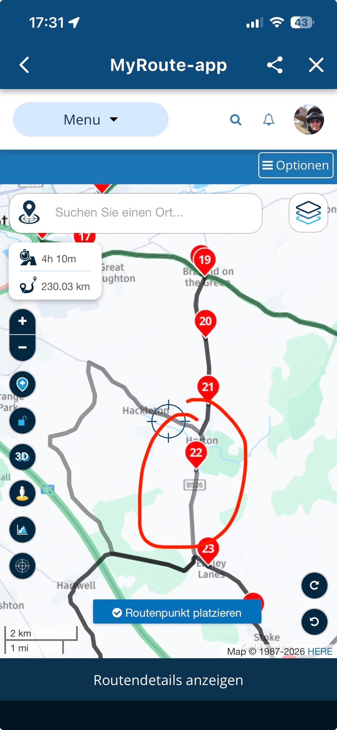

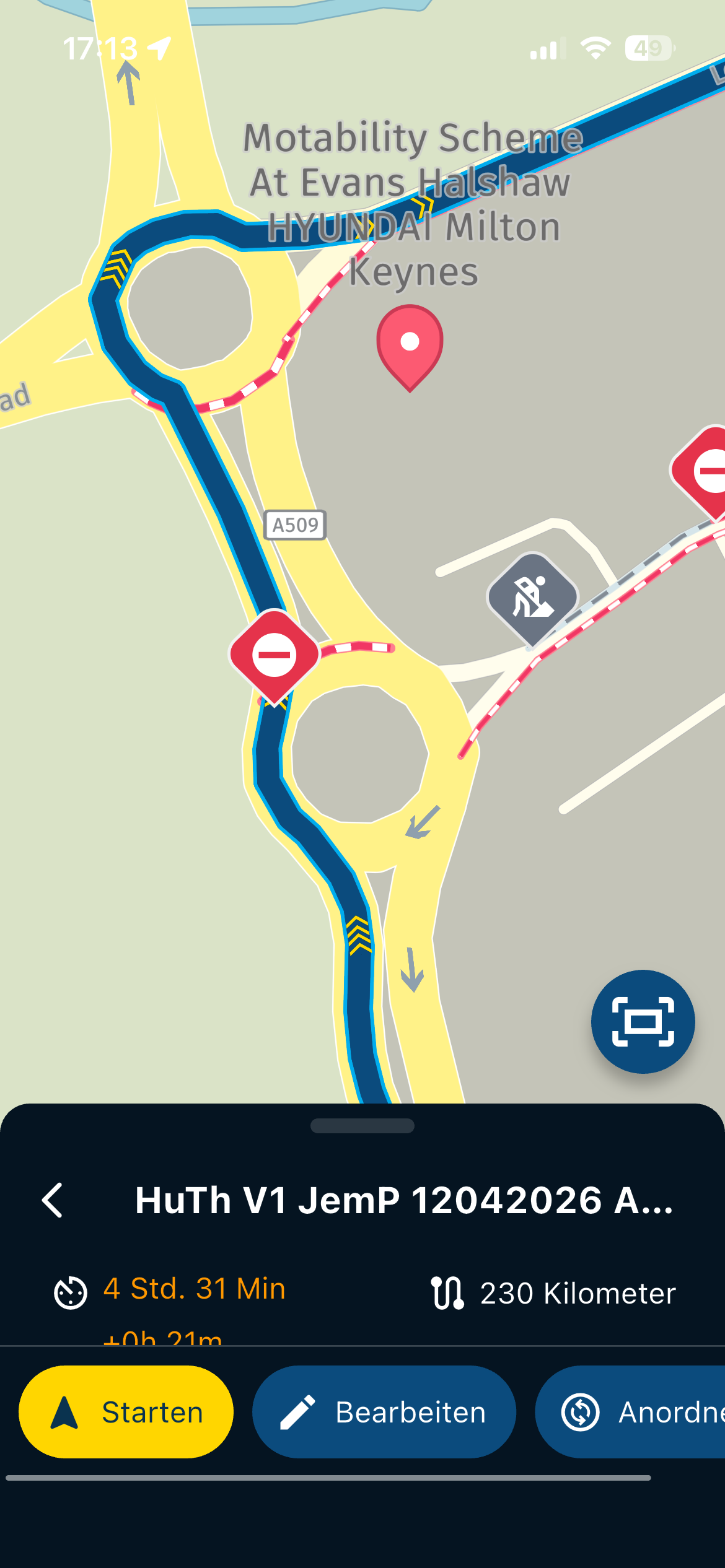

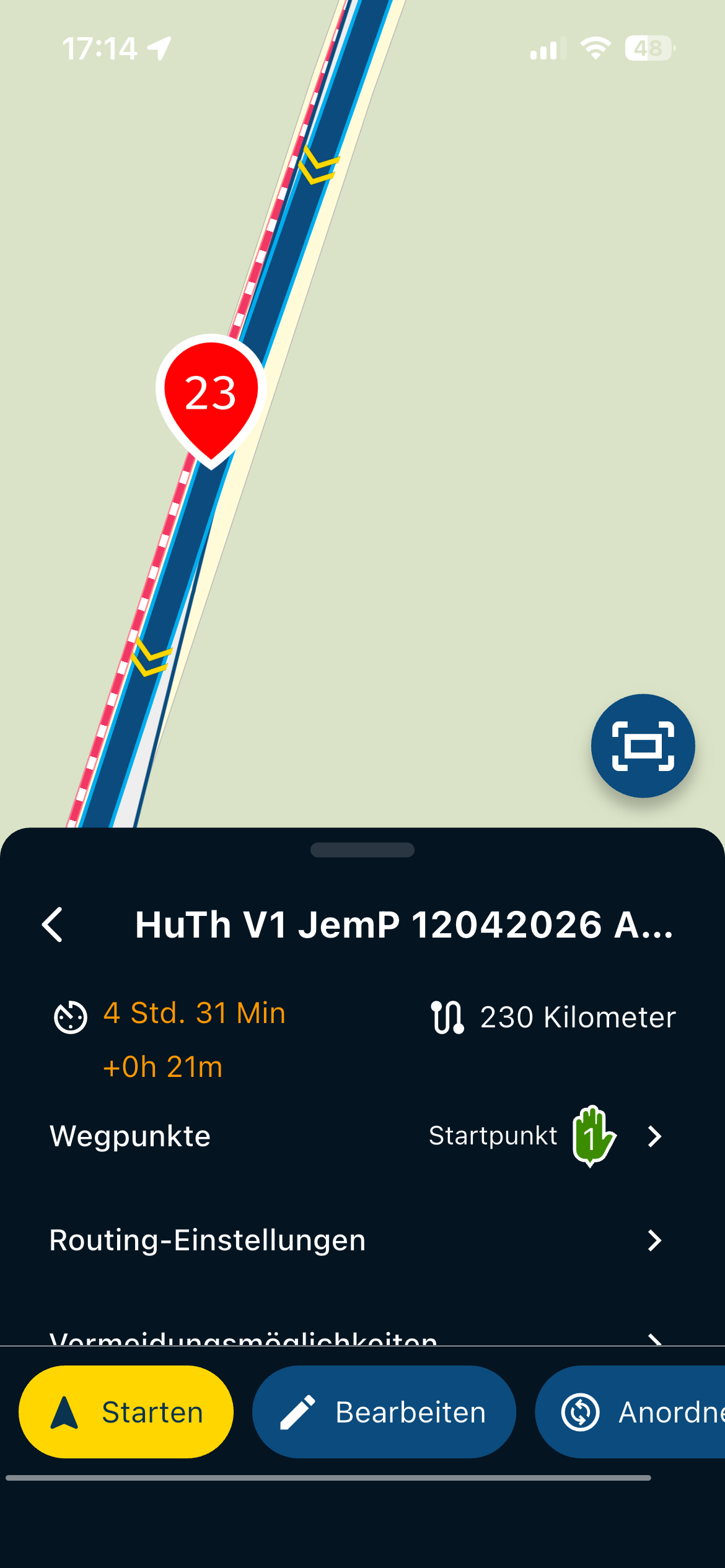

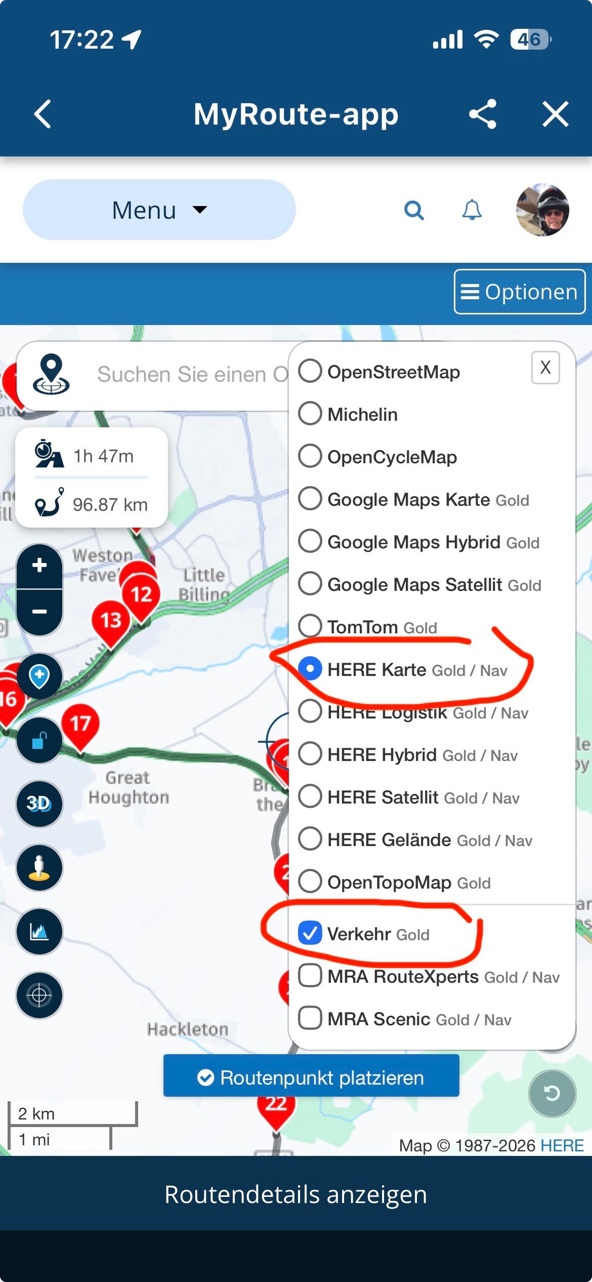

                • Hubert Thoring

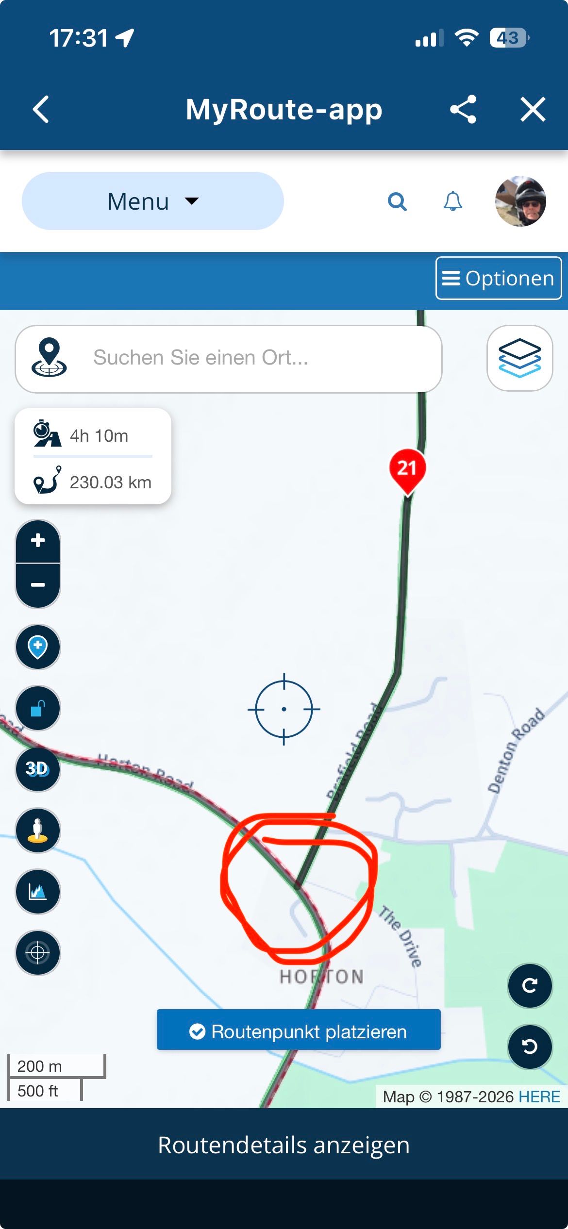

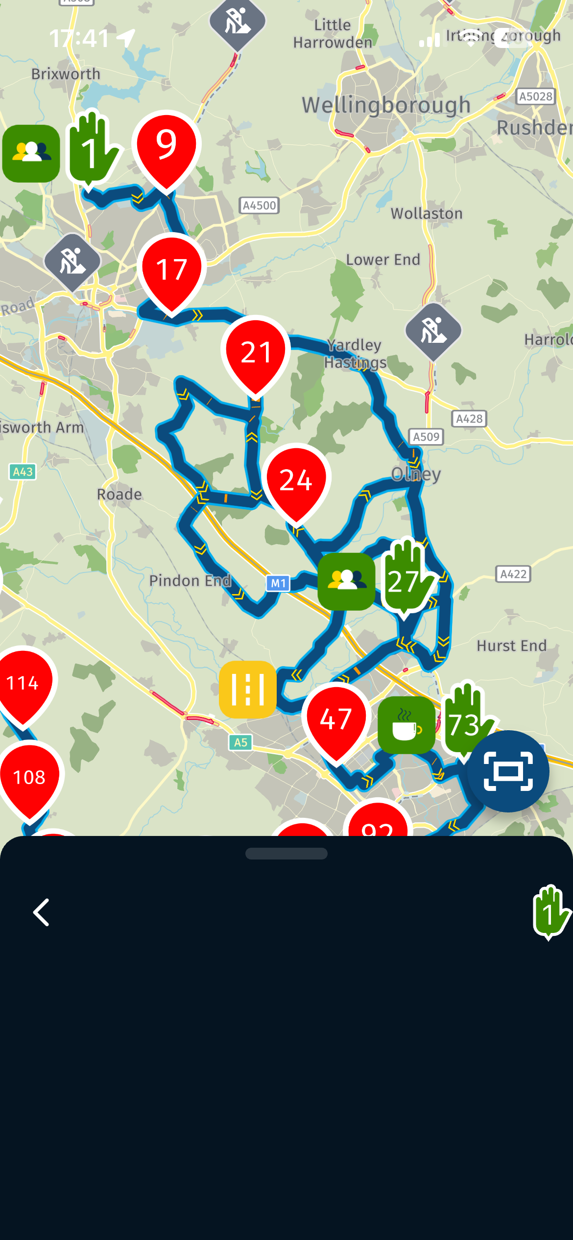

                  @ridetoportugal.com : The route has to cope with some construction sites ... these are real disturbances in the direction of travel ...
                  • Hubert Thoring
                    In the route lab on HERE map and traffic turn on then you can see it when you zoom closer ...IMG_9603.jpeg
                    • Hubert Thoring
                      Remove the rake so you can see something
                      • Hubert Thoring
                        The road from WP 21 is causing problems in one direction or all? ..
                        • Hubert Thoring
                          I type approx. WP 21 to approx. WP 28 construction sites and direction of travel are only possible in the other direction, so the MRA tries to approach the WP from behind...
