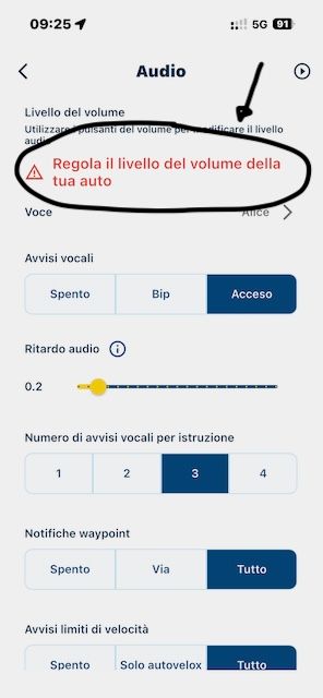

    Good morning everyone, I wanted to know if anyone else is having the same problem with the intercom and CarPlay. I connect the intercom (Cardo Edge) to my iPhone, and when I use CarPlay (Carpuride 702), everything works perfectly. In fact, with this setup, I can also use the Cardo app. So, everything works fine. When I open the MRA Navigation app, the audio is muted; I can't hear any of the directions or speed camera alerts. But, of course, the background music plays. In fact, if I go to the app's audio settings, I get a red alert indicating a problem (but it's not a volume issue). If I open the app, not connected to CarPlay, but with the intercom still connected to my iPhone, everything works perfectly. I've opened a ticket with support and am waiting for a response. But I wanted to know if anyone else is having the same problem.

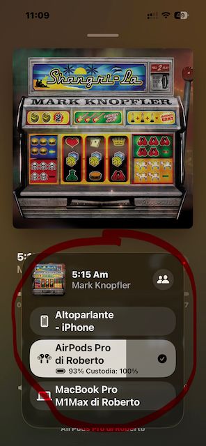

        @white.mouse Yes, I know, thanks. But doing so, you can't connect the intercom directly to the phone, as you can't use its native app with its features. In many iOS apps (Music, for example), you can select where to send the audio stream.I was hoping the same option would be available in MRA.
        I'll send you an example.

            @Leike-Lodiers I've already tried, but the audio stream (music, for example) keeps shifting, and at a certain point you can't hear the directions anymore since it's connected directly to the intercom and not to CarPlay. The only stable solution I've found is to connect only the CarPlay to the intercom. I hope MRA adds a feature (like Apple Music) where you can manually select the audio stream path (since only the Intercom is connected to BT). Now it automatically sets the audio stream to CarPlay, even if there's no Intercom connected to CarPlay. Sorry, I hope I was clear. Thanks
