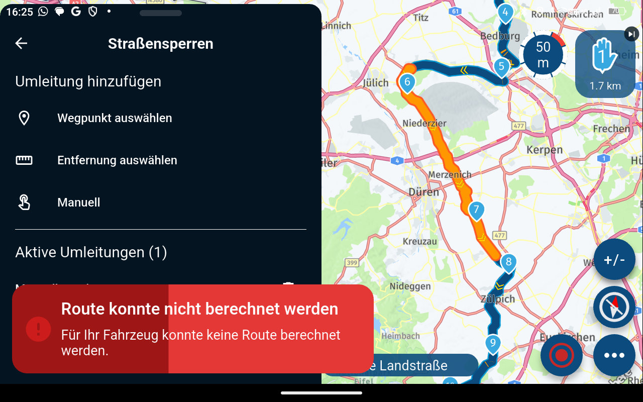

    I am trying to understand how this new feature works or how to enable something.
    For me it looks like (in the moment) that only "Select distance" is working.
    I should mention, though, that I'm only trying it here at home right now, so the conditions might not be right.
    If I use "Select distance" the next upcoming kilometers will be newly calculated.
    If I use "Select waypoint" or manual I get an error message and there is now new route.
    But I am not sure how to use it correctly.
    What is the correct way for select WP and/or manually?

      I played around a bit more with the new feature and found the following:
      Here the test route: https://www.myrouteapp.com/de/social/route/13652390?mode=share
      I started the route and the navigation, after the first announcement, I open the menu and select “Roadblocks.”
      Then select Waypoint
      From the WP list, select WP2 - ok works from start point (my current position)
      WP3 - ok works
      WP4 - ok works
      WP5 - Not ok error
      Next - Select distance
      5 km - ok
      20 km - ok
      25 km - ok
      30 km - Not ok error
      Next - Manually
      Start WP3 - End WP4 - ok
      Start WP4 - End WP5 - ok
      Start WP5 - End WP6 - ok
      Start WP5 - End WP7 - Not ok, error
      Start WP5 - End WP8 - Not ok, error
      The error comes because (may be too far or too many WPs)
      Hardware
      iPhone 12 pro (iOS 26.2.1)
      iPad (7.Gen.) 18.7.3
      Oukitel RT3 Pro (Andr. 14)
      • MotoCon
        MotoCon
        MotoCon
        I can confirm there is a maximum implemented for how long a detour can be. I don't know how much, but based on your findings it looks to be 30 km. But I really don't know. I can imagine that is too short, especially in mountainesque areas.

          I did some further play.
          Manually
          Start WP6 - End WP7 - ok
          Start WP7 - End WP8 - ok
          Start WP8 - End WP9 - ok
          Start WP9 - End WP10 - ok
          Start WP9 - End WP11 - Not ok, error
          It seems that the distance from the current location doesn't matter—only the length of the detour.
          The detour must therefore be longer than 30 km.
