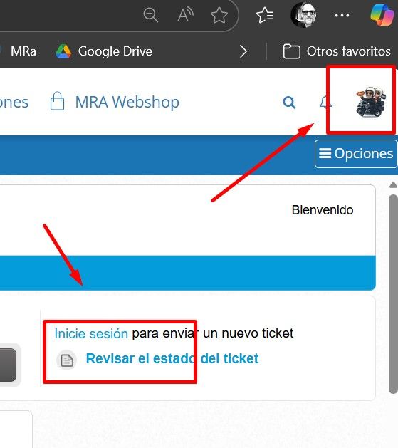

                  @Corjan-Meijerink Hi, I'm sending you the log files by email. I can't open a ticket.
