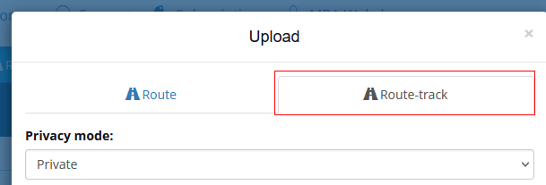

      @Old-Dog-Arwon Save you route with an option that includes the track information such as GPX 1.1:
      Then go to your tracklogs and do a Tracklog upload:
      Select your saved GPX route and import it as a tracklog.
      If you wish to import it as a route track, do a new route upload:
      ...and select the Route-track tab.
      Select your GPX file and upload it.

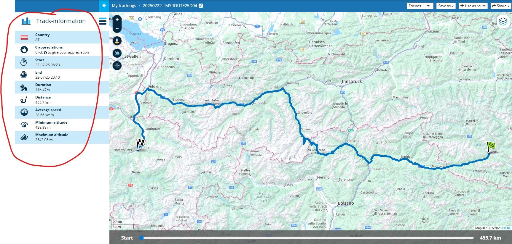

              You can see the information that a Tracklog has within the GPX file.
