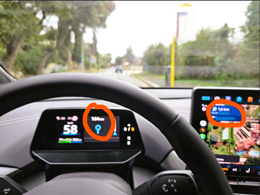

    I usually use the app on my bike. Yesterday I tried it on a car with Android Auto. The car is a VW ID.4, in this car navigation instructions from apps running AA can be shown also in the deck behind the steering wheel.
    So I noticed that the distance from the final destination shown in the deck and the one shown in the main screen are different: when the screen shows, for example, 1.6 Km, the deck shows 162 Km. This happens only for the final destination, while for next turning points they match:
    (sorry for the bad quality of the picture)
    Marco

      You would need to help us a bit more with this 😉
      We have no official support for HUD or cluster displays.
      Does Android Auto propagate this information to your screen?
      Are you sure it's receiving information from our app or is another navigation app running?

        Not knowing anything, but can it be a bug, that decimals are not considered or can be displayed? I mean 1,6KM vs. 1,64KM?

          In my Kuga I also get distances to next instruction in the car dashboard, so that's probably propagated AA indeed (and works just fine). But I don't know how I would get a distance to destination in there.

            @Corjan-Meijerink I confirm I was using myRoute app only. Navigation info were replicated to the car dashboard. This works for Google Maps as well.
            The weird thing is that the wron info is given only when showing the final destination distance and not when showing the next turn point.
            Is there any test I can do to help you ?
