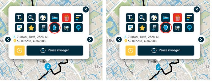

          @Brian-Dingsdale-0 the manuals page waypoints
          just click on a waypoint, expand the options with the three dot menu button
          then just toggle the "hand" & "teardrop" symbols to switch between "via" & "shaping" points respectively
