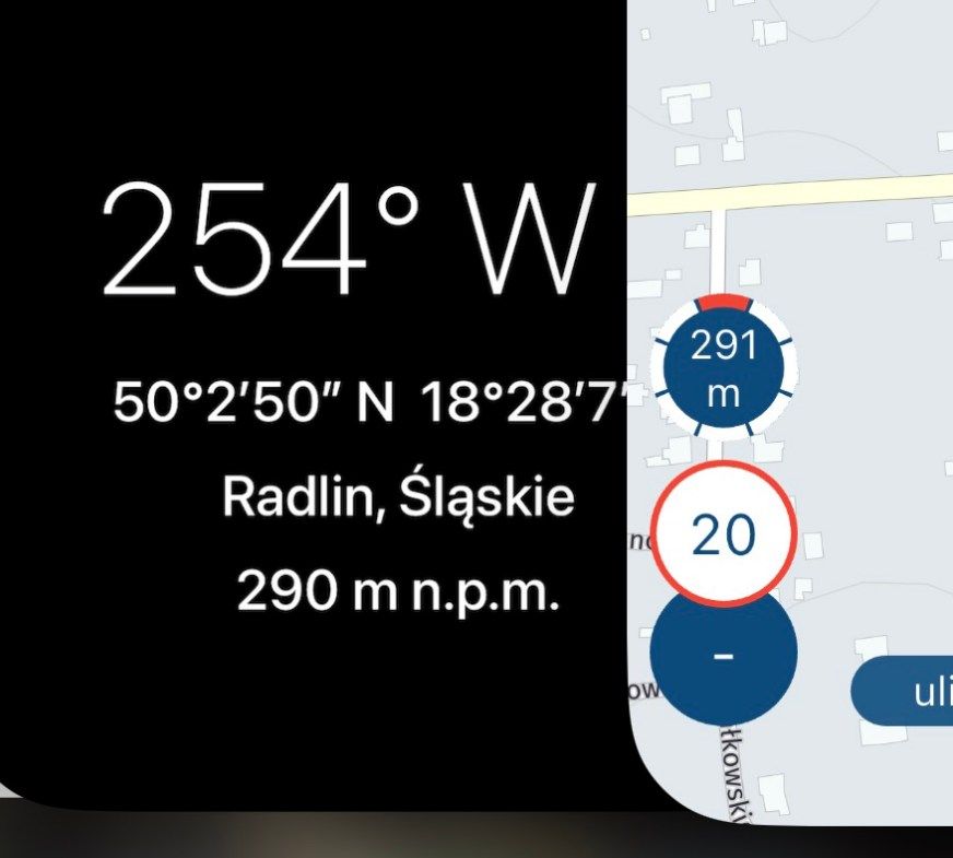

                I can see the same on my Iphone 15 - compass app vs MRA:
                Regards
                Staszek

                  @stanisław Maybe i look wrong. But in your screenshot MRA says 291 meters and the other app 290 meters. That is within limits.
                  Or am I wrong?
                  • Stanisławundefined Online
                    Stanisław
                    wrote last edited by
                    I meant that they are the same values in both applications, so I can not see any problem on my side.
                    Regards
                    Staszek
