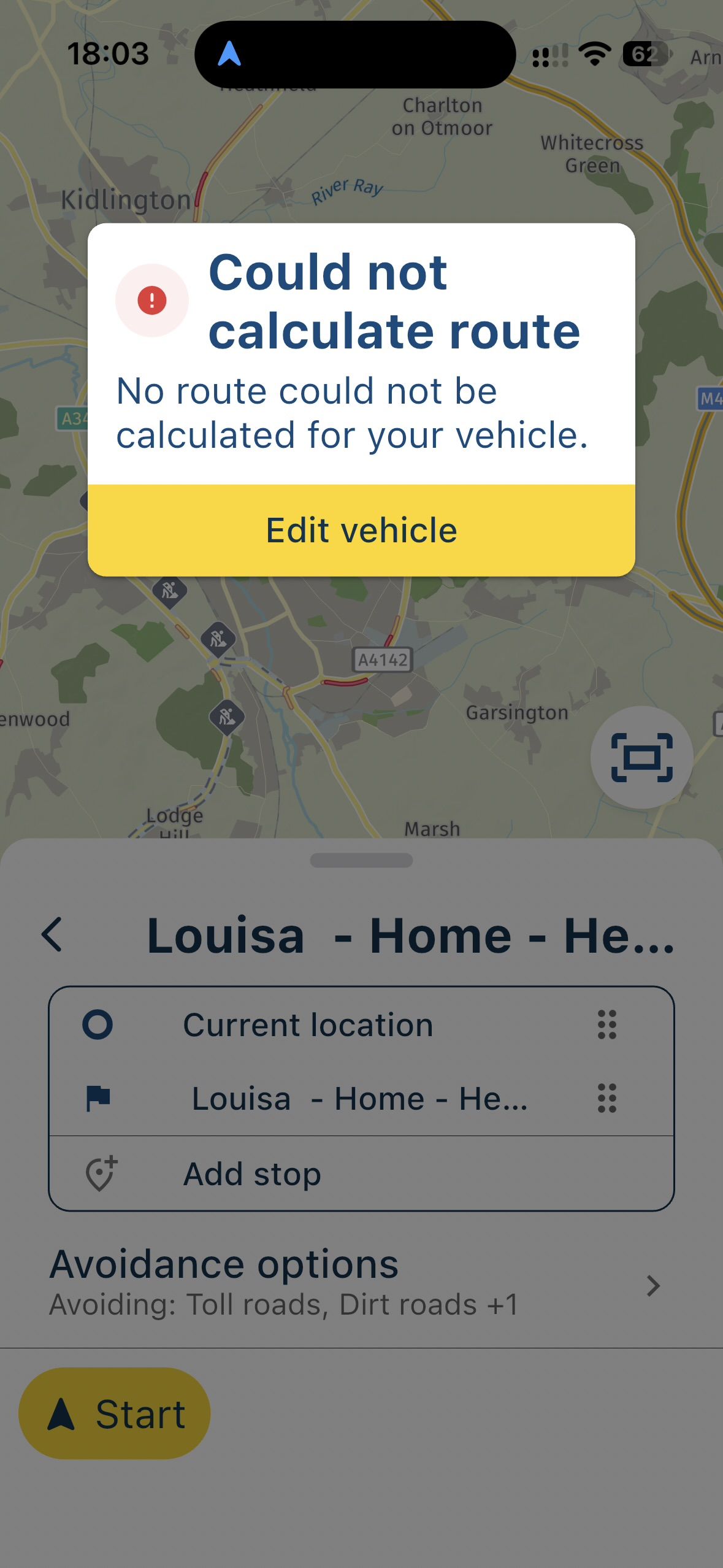

    I am having problems with this type of travel mode and it may be what I am doing, particularly as car and motorbike modes work fine.
    I try and set the parameters for my vehicle but the support page does not give much information:
    • Electric Car: If you drive an electric car, it's helpful that our program takes your fuel consumption into account. Enter your data here so it can be taken into account during navigation. In this mode, you won't see gas stations, but charging stations.
    This is the details I have:
    Help if it is me please and some more guidance if need be on what is required in these fields but when I use this mode for a simple A to B route i receive this:
    I am new to this EV world.
    Kind Regards. Help where I can.

        @Con-Hennekens. Thank you for your reply but I still cannot get a route to be calculated. I do not have Ascent or Descent data though.
          @Dave-J-0 Apparently, you need to configure some kind of charging station before you can navigate a route. At least, that is what I see when I select EV as the travel mode.
          I don’t have an EV myself, so I also have no idea what realistic values would be for the available fields. However, ticking one of the charging station types allows me to calculate a route as an EV.

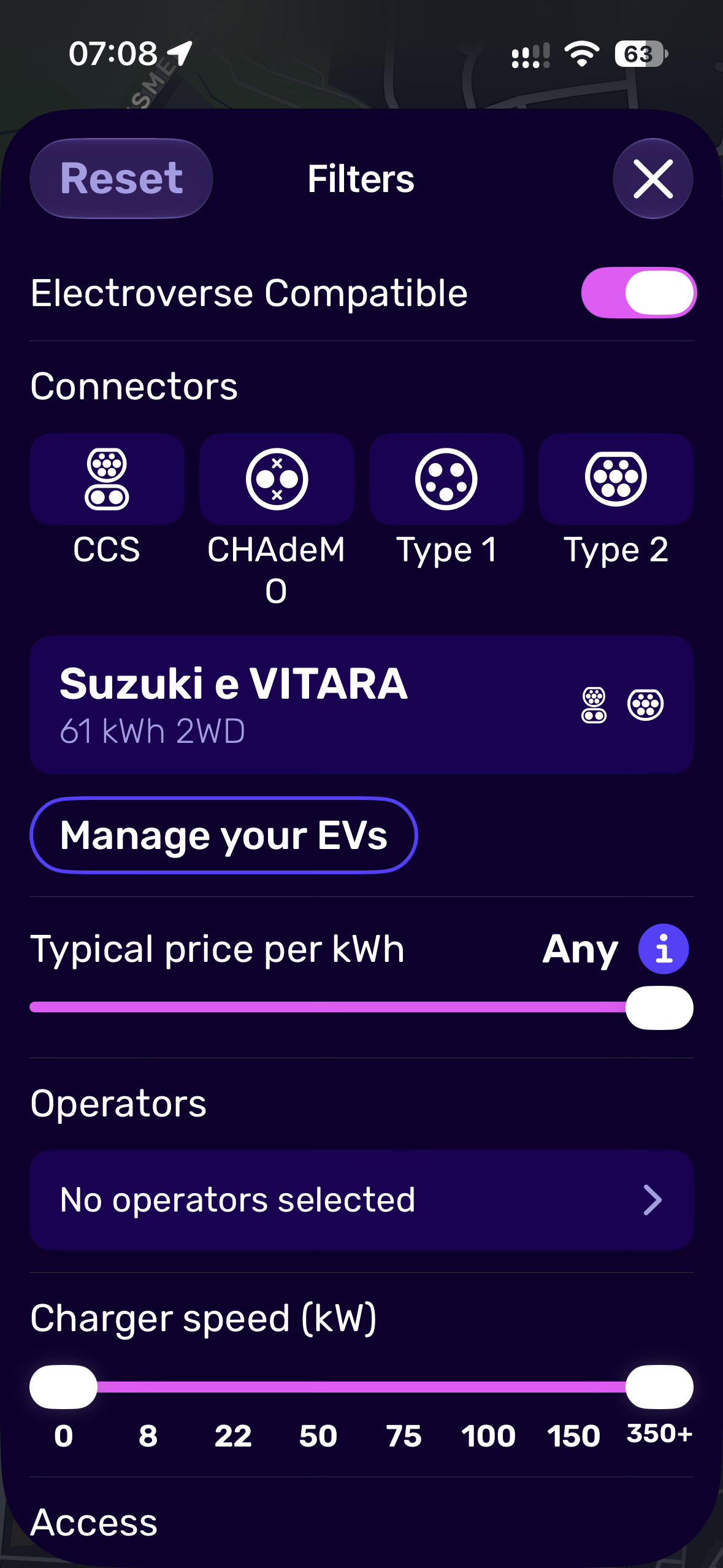

            @Rob-Verhoeff thank you. Yes. That now works but it would be useful if there were prompts to say that. Also the connection types are not easily recognisable from what most EV charging maps are using.
            Great if the support information could provide more detail and the charger selection were using the correct terminology. This is what I looked up: https://proev.co.uk/electric-vehicle-guides/type-1-vs-type-2-charging-connectors/
            Just bought an EV yesterday which is why I now have a very keen interest in this area. 😁
