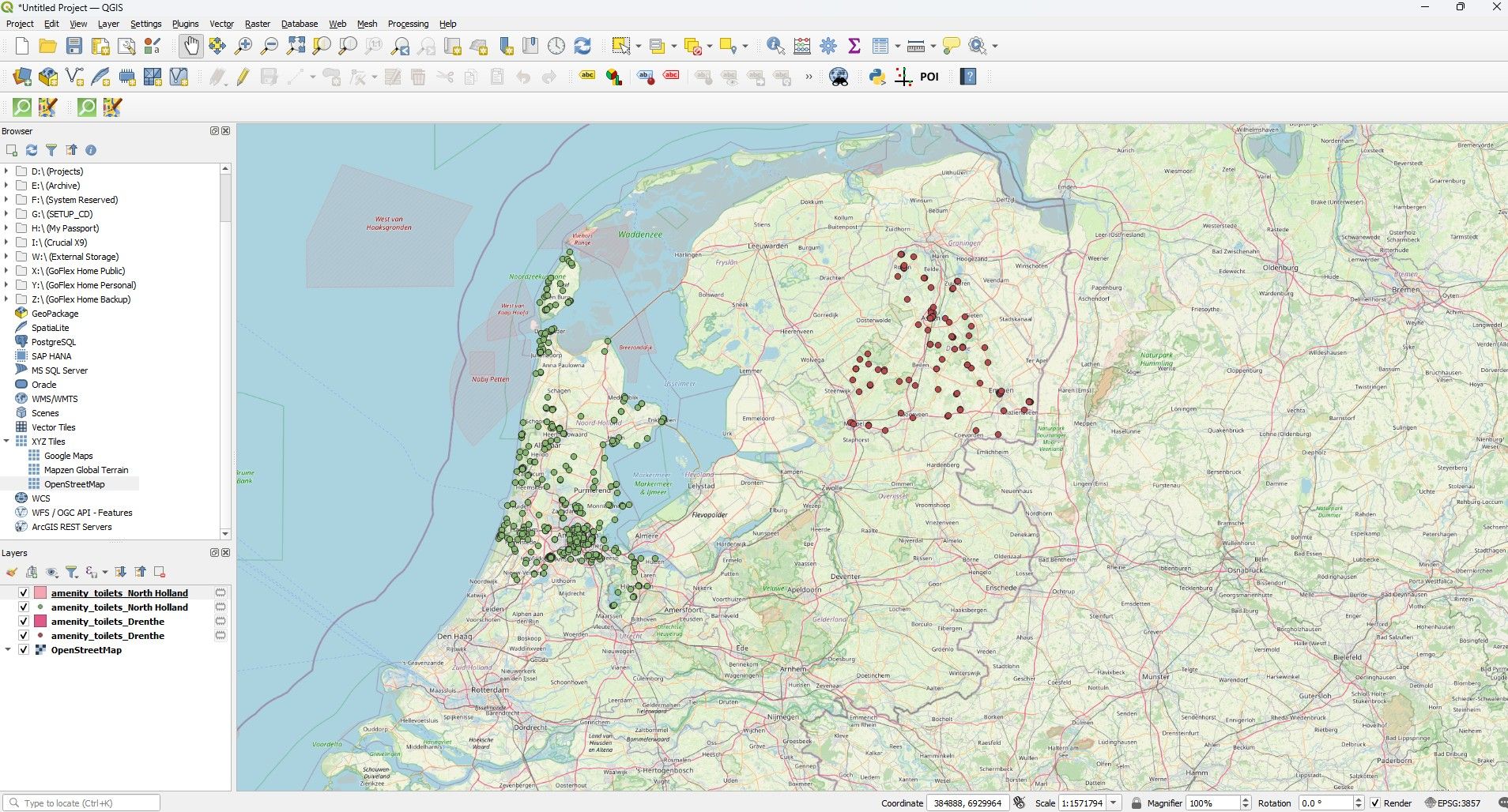

              You can harvest them off Open Street Map data using QGIS and the Quick OSM add in. Then export them to a GPX file using the QGIS POI exporter.

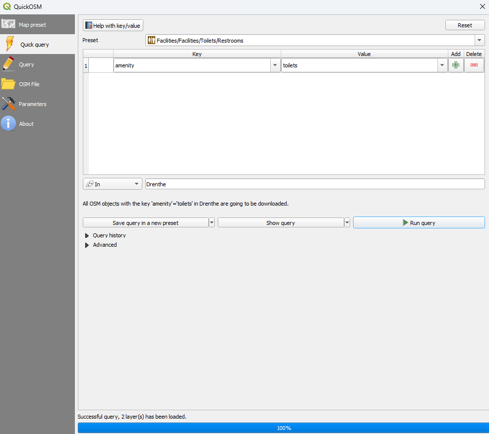

              There are too many in the Netherlands and Germany for one query so divide the query into administrative areas.
              So for the Netherlands a Query for Drenthe and North Holland.

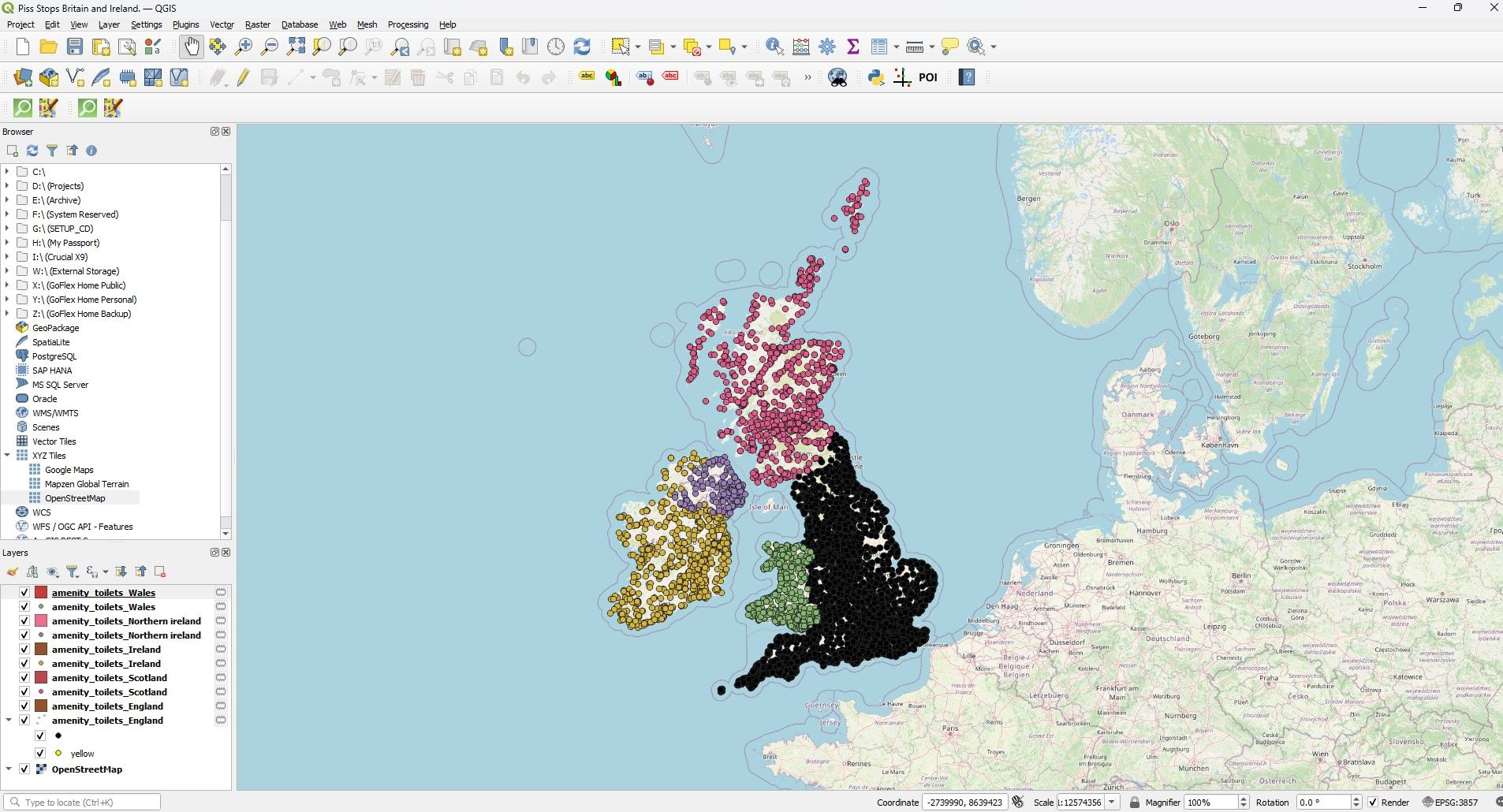

              This is one I created for the Great Britain and Ireland

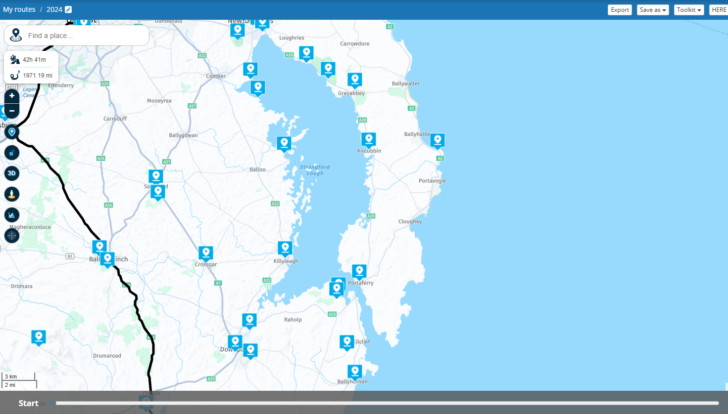

              And what it looks like as a POI upload. This has to be manipulated as the field data for MyRoute POI's is limited to Long Lat and Field name.
