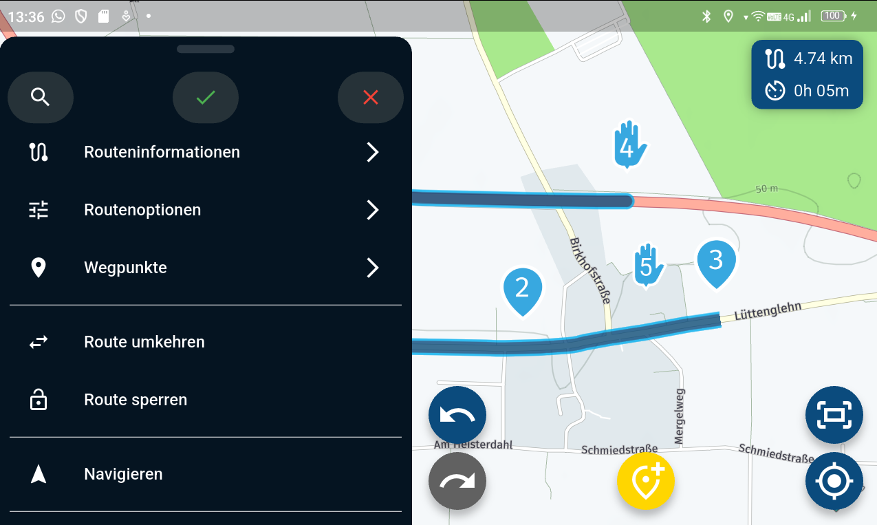

    Hi, there are some problems I noticed with V 420 on my Oukitel Tablet. (I changed toRT3 Pro with Android 14)

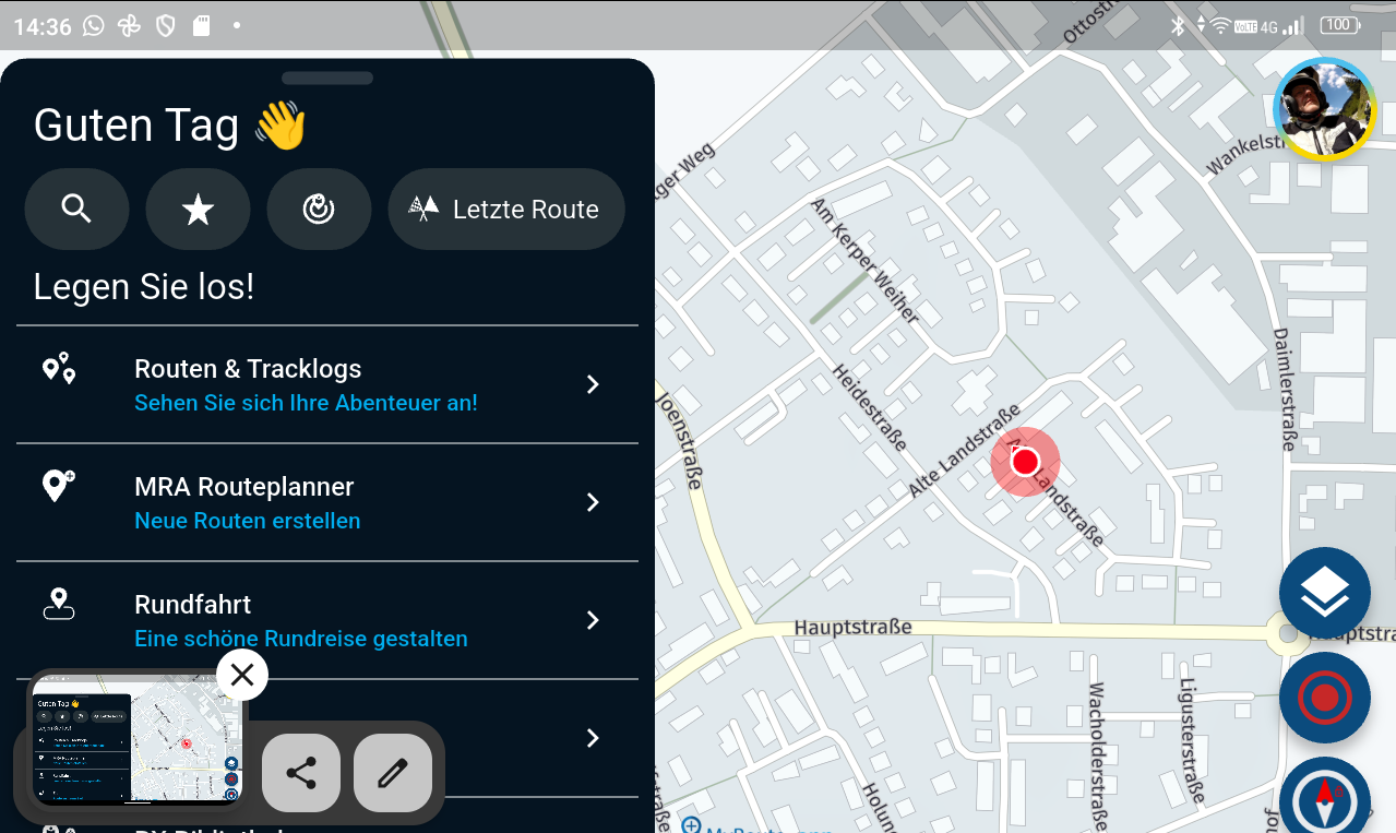

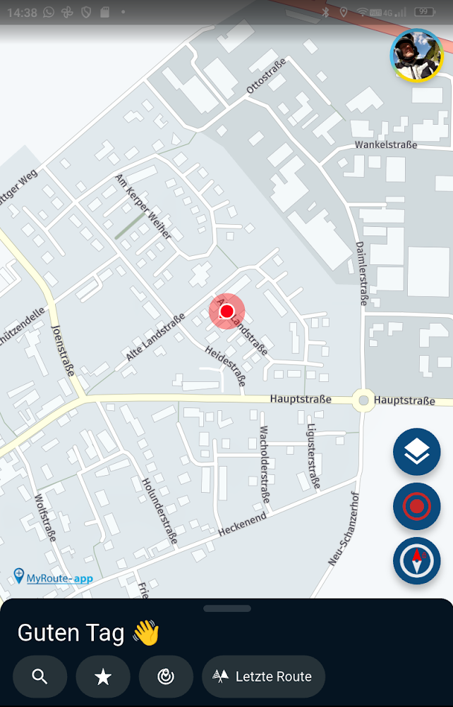

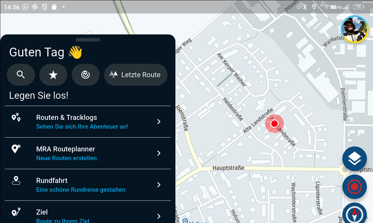

    1. I can not move the start menu down in landscape format. It moves min. 1 cm that's all. In portrait mode, it moves down completely.
    Normal view:
    Minimum move down:
    Portrait mode:
    2. WayPoint setting in InApp Routeplanner. In Landscape mode it is not possible to set the WP correct on the street. The WP is set by hand top not by hand bottom. In portrait, it is OK!

      1: design choice - menu can't (and won't) be able to be moved down in landscape
      2: I'll investigate a bit more (possibly fixed in the upcoming update)
      3: Believe it's fixed for sure in the upcoming update
      Jörgen 1 Reply Last reply
        @Corjan-Meijerink said in 5.0.0 (420) on Android Tablet:
        1: design choice - menu can't (and won't) be able to be moved down in landscape 😢
        2: I'll investigate a bit more (possibly fixed in the upcoming update) 👍
        3: Believe it's fixed for sure in the upcoming update 👍
